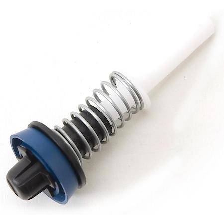

I just thought of something. When I put the blue seal back on my accelerator pump I had it upside down. The one in the picture is the way it should be in my old O-ring is the other way will that make up difference
Yes, it needs to be like the picture. If you don't get a good solid shot of gas from the accelerator pump, it'll stumble/bog down because the engine is sucking too much air without the extra shot of gas.

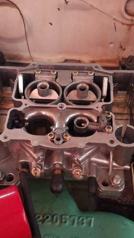

In your pics, if you have not already adjusted, your float is adjusted too high. I would not be too concerned with float drop. It is the float level that is what is important so that it shuts off the fuel supply when the bowl is full.

Wow guys thanks so much. I'll have to redo the pump gasket like in the pic and try the other things. I did redo the float (closed) again tho. This time I slide the drill bit to the front and adjusted it just enough that the bit just slide in towards the front.

That's pump gasket matters!

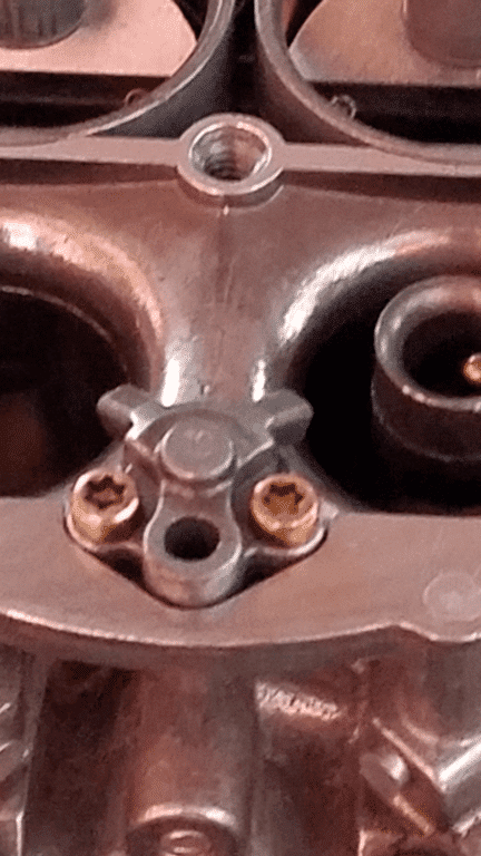

I noticed on a few photos that the pump jet housing on mine doesn't seem like there's jets like the photos I've seen.
You should have some kind of jet, it may not look exactly the same. It is possible it was swapped out from another carb or modified. As long as you have gas squirting out each jet nozzle when you push down on the accelerator pump, it is working.

This is as I was tearing it down the other day
Not sure what that small hose is at the bottom left, but from the picture, it does not look very secure or fits well. It might just be the photo. All you need is a little air being sucked in to mess things up or wherever that hose goes could be losing some vacuum.
