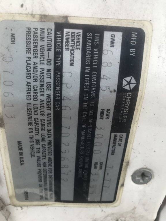

CP46T7D256872 (MDH 070613)
CP46T7D261877
Still, July 6th is not quite July 7th, so it would be interesting to know where that piece of information is coming from.

The first picture of the fender tag is rather unreadible, so if you could could do another shot of that?
standard 440, ESA with cat (California emissions)
The second fender tag says N94 "ESA w/Catalyst", usually associated with Federal emissions. California emissions are associated with N95 "Emiss/Test and Label". Was this car first registered in California?

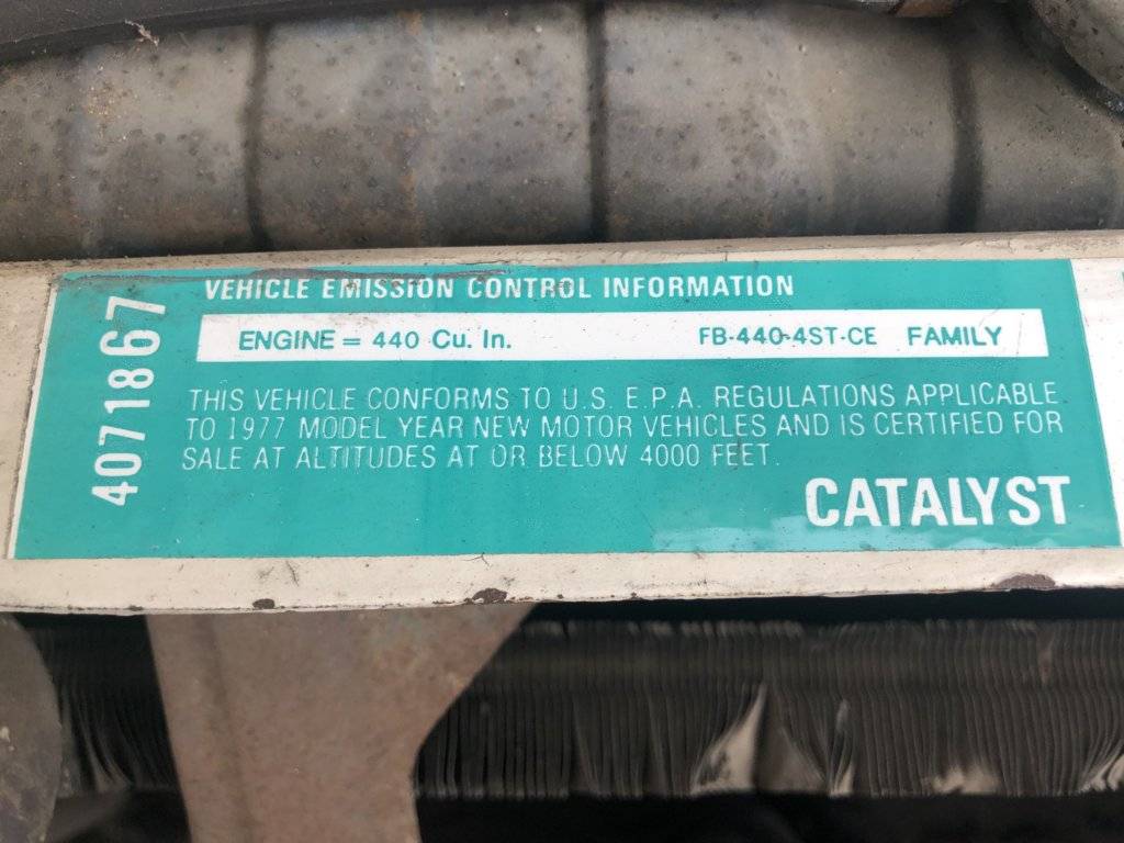

That's why we need to get to the bottom of this. For a start, could you take a pic of the emissions label?
Here are the pics:
Aaron
So it's a regular Federal emissions sticker, thanks!

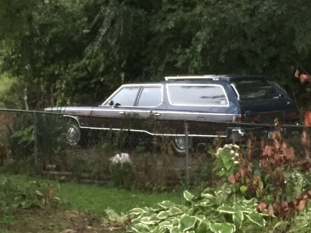

Here's a fresh picture of mine (there are others on FCBO). It was soaked from rain, so that is why the Di-Noc looks so beautiful:
