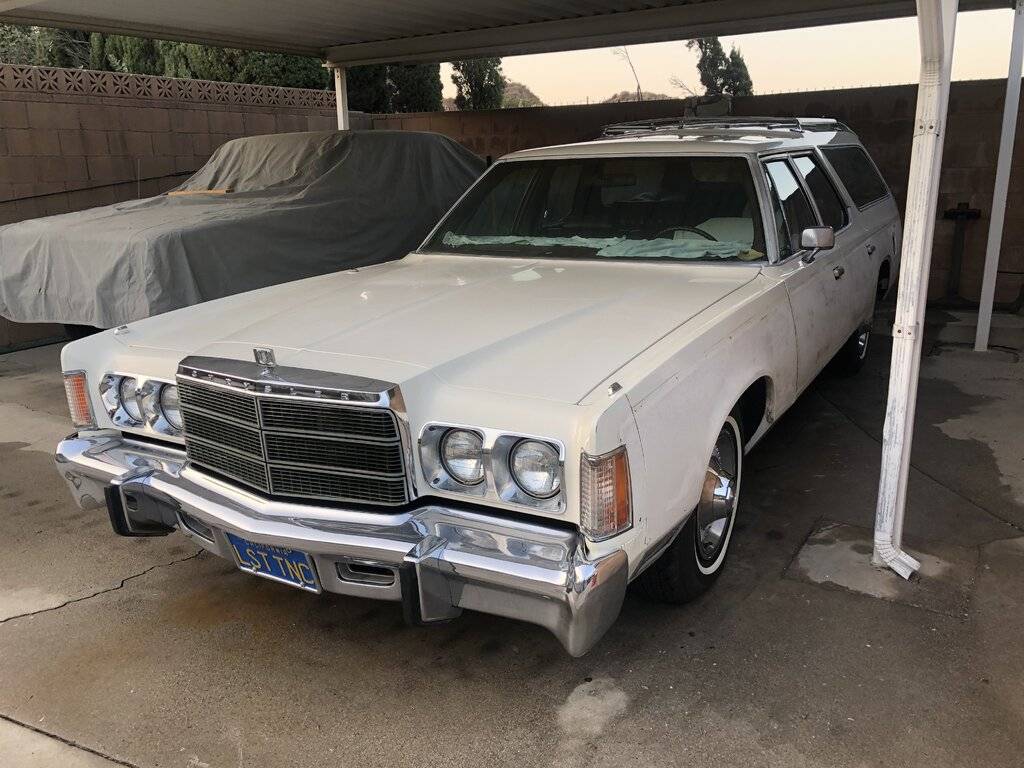

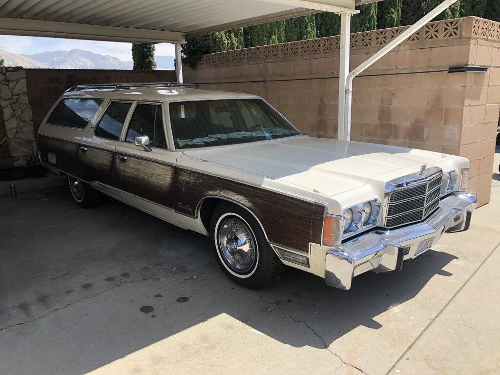

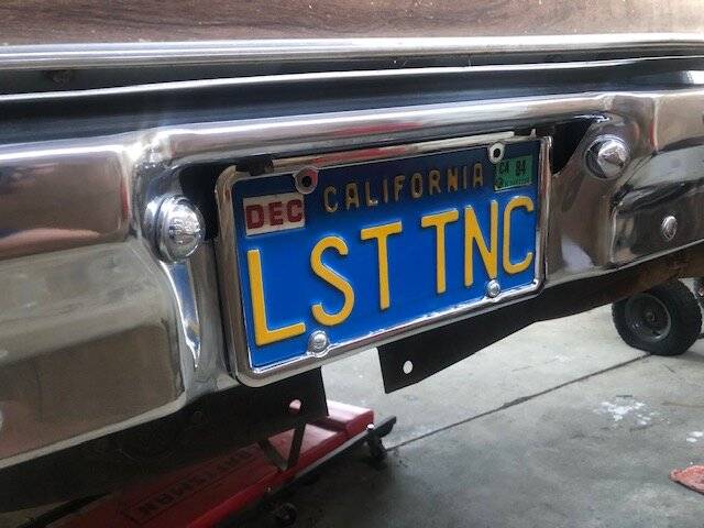

I've been productive during the past month. The brakes and most everything under the hood are done. I've been doing a lot of cleaning too. The license plates and bumpers polished up surprisingly well. The gas tank was finished today, so I had enough time to loosely put it in place. I'll install the filler and tighten everything up tomorrow and put some gas in it. The car should be running and driving by the weekend.

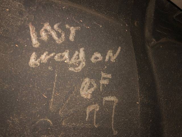

Along the way, I've found a few more signatures. One is under the passenger front door... but the coolest is the "Last wagon of 77" that was drawn into the factory undercoating (under the rear seat floor) right after it was applied at the factory.
I've tested all of the electrics. Only one power window is working and it can only be done with the four gang switch. Nothing on the tailgate works... and the electric door locks aren't working properly. Other than those small issues, everything works!
I haven't touched the wood yet. It'll be a big job, but I want to fix all of the car's issues before I do that. The goal is to be done with everything by the end of the summer. Even at my slow pace, it should be done by then.
Aaron

Wow, that's some piece of evidence!
Couldn't somebody do the same thing for the 1978 model year? Would save us an awful lot of trouble!
I'm sure they did, that's why I'm thinking the true last '78 has been scrapped/derbied long ago. That car would've had all kinds of "evidence" on it just like this T&C, if not even more, being the last C Body ever!

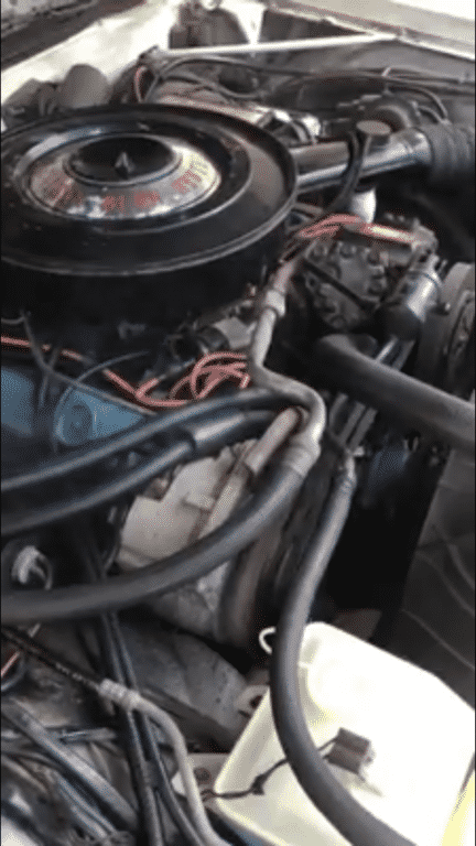

After 36 years of sitting, it runs, stops, and drives. The Lean Burn works fine, the transmission shifts well, and even the load leveling rear suspension works as it should! Now it’s time to sort the door lock and power window issues, and I have to install the windshield wiper bushings. It’s turning out a lot better than I thought it would.

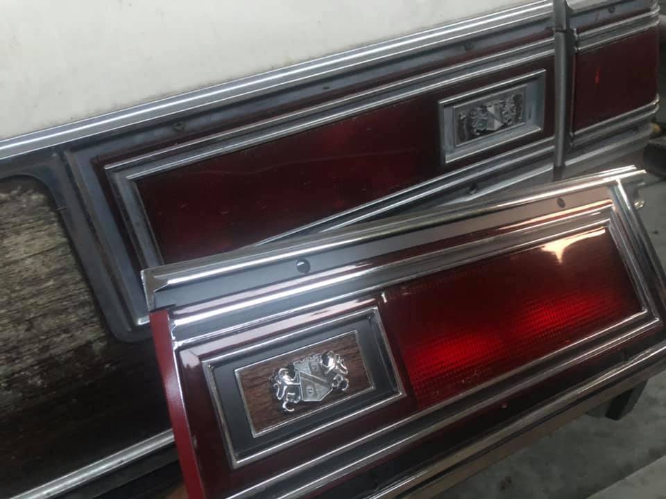

Now that it runs and drives, I'm starting to attack the little things. I lubed the power antenna and it works perfectly. The tailgate was next... so I started with the tail lights. They were looking sad, so I cleaned, repainted the details (including the small strip of dark red), and polished the lens. The finishing touch was a bit of the NOS woodgrain. It only took about an hour from start to finish the one side, but the result made a huge difference! I'll finish the job tomorrow.

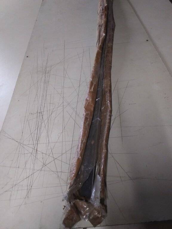

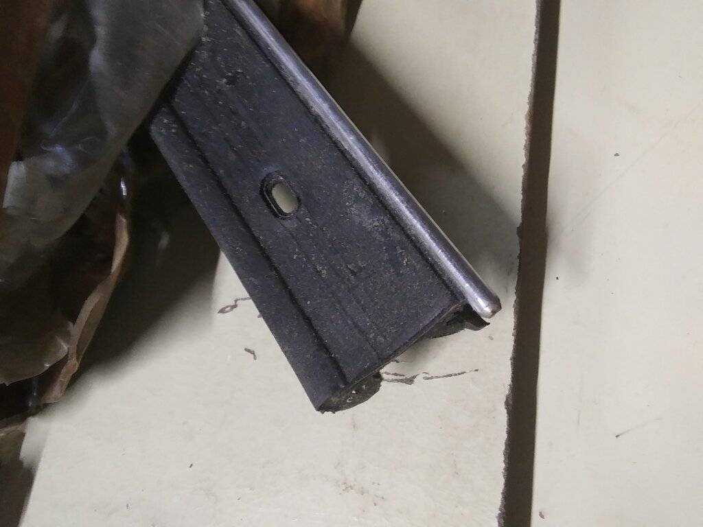

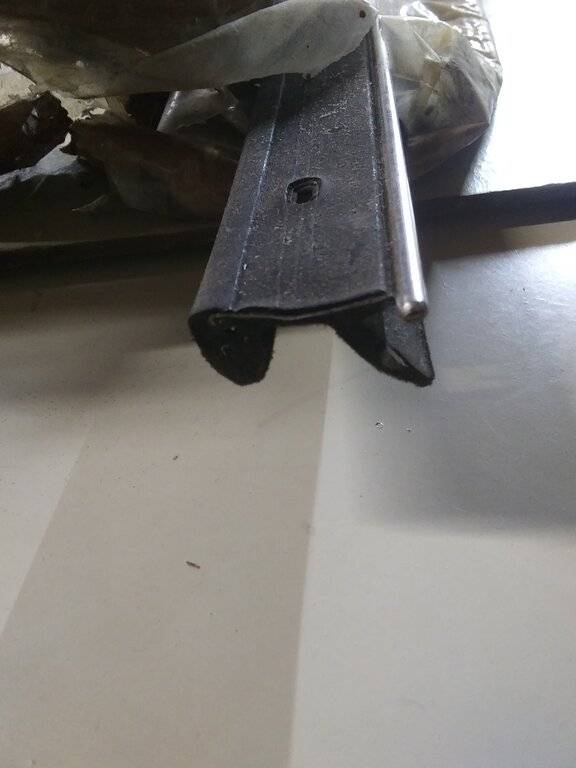

Hello Totally 80's! I was scanning the forums & saw the story about your dad's T&C. Great story & I'll bet your dad is looking down on you with pride & joy! I, too, owned a '77 T&C & I loved it! I was actually in the process of restoring it, but, unfortunately, due to severe financial problems & lack of space, I had no choice but to scrap it. After reading about your car & others, I rather regret making that decision. There were still many good, usable parts on it. I DO still have a few things that came off of the car, plus some odds & ends that came from a donor T&C. One of the parts I have is a weatherstip piece that I'm fairly certain is/was used in the tailgate area, POSSIBLY across the top of the gate. If you'll study the photos you might be able to tell where it mounts. It is approx. 47 in. long & it has 7 screw holes. One end is cut at a 45 deg. angle. Part #3759471...I've tried but have not been able to find any info on that number. If it's something you think you could use now or in the future, I will send it to you for just the cost of shipping. If you don't need it, then perhaps you know of another T&C owner who could use it. I also have 8 of the stainless steel luggage rack strips that go on the roof. Plus, I have window glass for the front & rear doors AND a tailgate glass. Let me know if any of this interests you. You can post a message here or send me an email at mopar8649@gmail.com. Thanx for your time! --- Panhandle Slim

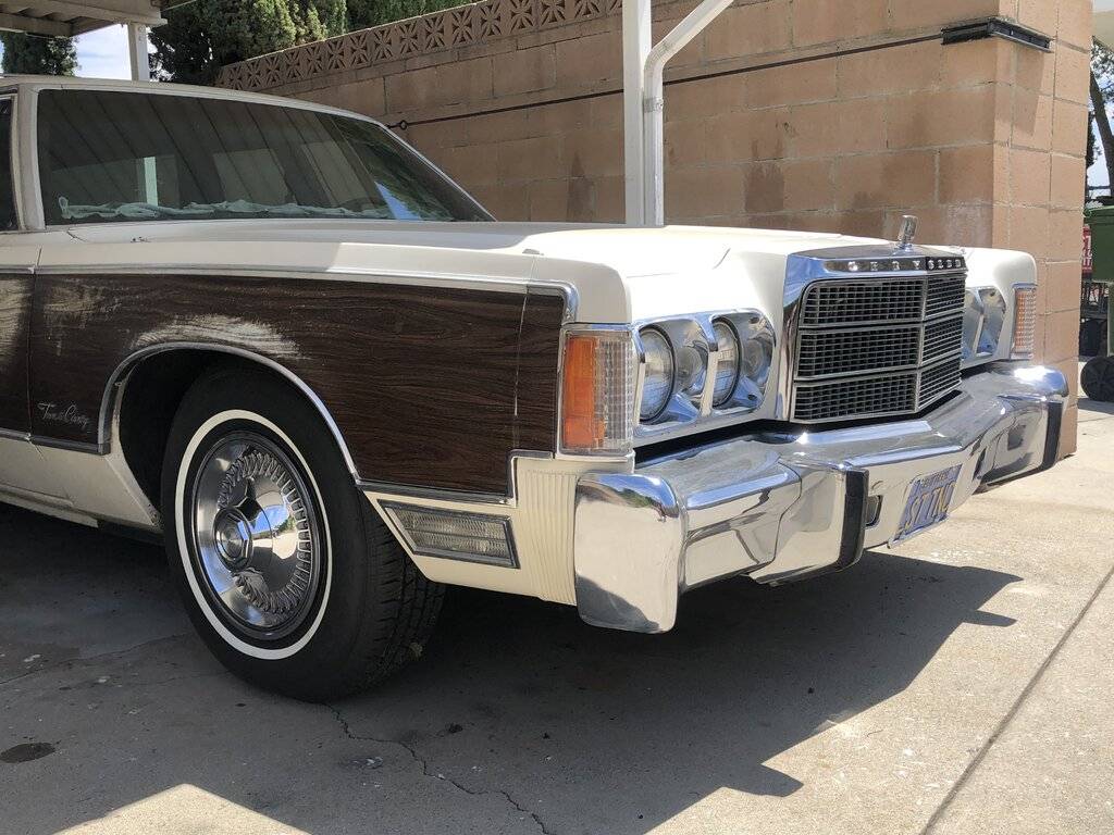

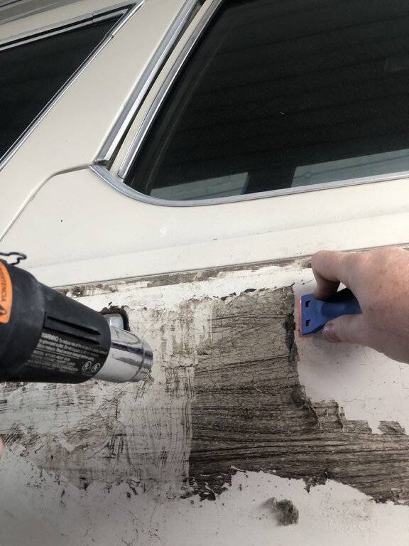

Starting the new school year and teaching from my basement has taken a lot of my time. Now that I'm getting into the groove of distance teaching, I am using the T&C as a way to relax after work. I've started to remove the wood and will just work my way around the car. It's a horrible job, but I'm figuring out a good process. Today I decided to finish one of the fender skirts. I matched the NOS grain positioning to the original. I'm really happy with the results.

Removing the wood was as therapeutic as it was tedious. It took me several weeks to do in my spare time. I have a little bit of glue to clean up and then a few door dings to repair. Once that’s done, the new wood vinyl will go on. It’s starting to look a lot better... but there is still a long “to do” list.
