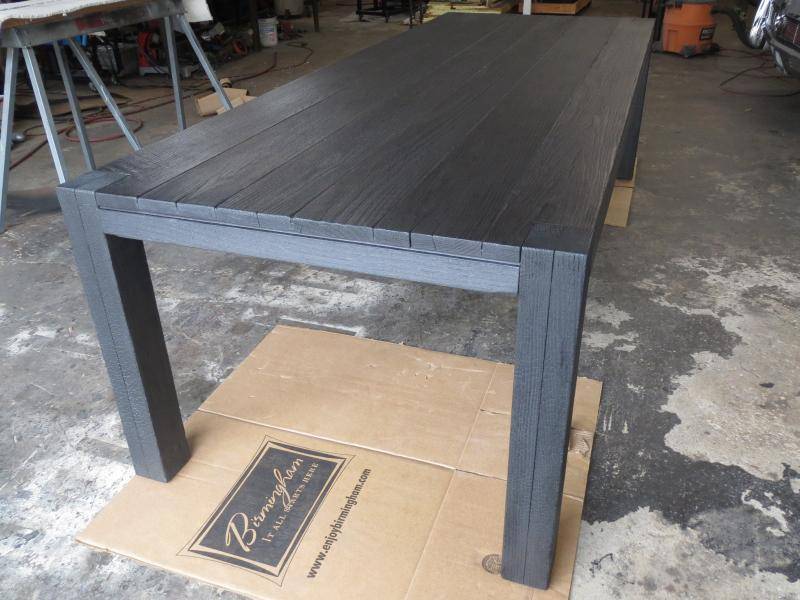

I build a lot of stuff but this one I thought you guys/gals might find interesting. A client came to me with the request and I'm always into trying things I haven't done before. It started out as a relatively simple modern solid oak table which really turned out great. It's big too at just under 9' x 40" and required a steel under structure and weighed over 300 lbs.

This is a bummer because the table is fairly mundane, it's what I did to it next that's interesting.

With the help of my friend that now does a lot of my finish work we torched the heck out of it for 6 or 7 hours and basically blackened it. It's actually a very old process called Sho Sugi Ban and was commonly done on wood siding, prior to installation of course. It kept bugs out of the wood and also slowed the process of rot. As it turns out it makes for a very kool finish for fine furniture too.
Propane with 3 different size nozzles.
Heres a shot of the bottom for you Stan. It's basically an octagon shaped steel frame and the legs are lag bolted through the steel along with some other blind fasteners.

I built the table in about a week and a half starting with rough sawn lumber and another day or so after the burn to repair what exposing it to that much heat did to it. The burn and finish took another couple of days.
Let's just say a grand covered the materials.
Here it is in its new home.
