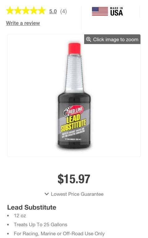

Your 2nd best option is a additive made by RedLine Racing Oil & is their Lead Substitute additive. This is a chemically based additive that works much better & more similar to lubricate then the $6 bottle of "lead substitute" from AutoZone in the gray bottles.
We order it in case format from Summit which makes it like $13-14 a bottle
