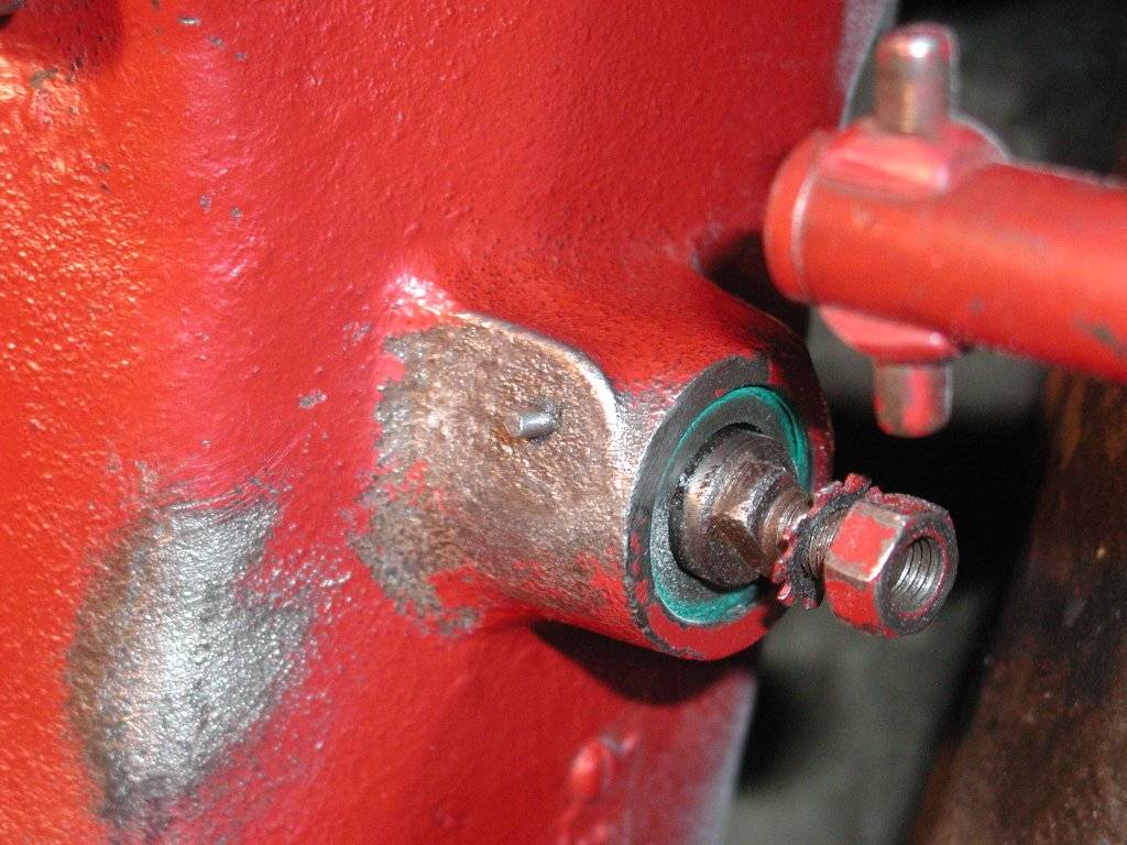

Pictures? I'm having trouble picturing your issue.

I'll try to get a pic or two tomorrow, but it's not my strong point. Your clamp jig might have prevented the problem. Thanks! Lindsay
This is the best pic I could manage. The image should be rotated 90* counter clockwise to be "right side up"! I will try to zoom in. I can't figure out how to do that, but you may be able to see the darker area between the pin and the cast trans case. This is the enlarged hole in the case. At the moment, it is filled with silicone and that is soggy with lube. I can dig the silicone out with a dental type pick. I suppose the Proper solution is to use an undamaged trans case, but it would save time, expense and labor if I can seal what I have. Any suggestions will be appreciated! Thanks! Lindsay

Thanks, 65CopCar, That is without doubt the best way to repair my damage. My problem, however, is the labor and time to remove, dis-assemble, repair etc. Since the trans is woking well, I'm leaning toward attempting to reseal it, and hope for the best. If I remove it for some other reason, I'll fix it properly. Twenty years ago, however.......
