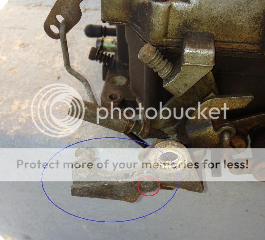

1481 is the only one I have ever used just put the throttle stud/kickdown stud off orig on the hole closest in picture. I think 1483 is for going from 2bbl to 4bbl with stock linkage. The top is for newbies or people who need to turn in their mopar card for not saving all those funny looking bolts and fittings from every mopar car they have touched took apart whatever. Fittings are what a good auto parts store is for and why they need to be patronized, I get most of these from my truck parts supplier.

I want to add that one Mopar forum said you need the for the correct CC adaptor. I dunno.
Edelbrock 8009
All I know is that to hook the CC in my NYB to a 1406, I had to use this:
1484
because this is the CC lever on TQ's:
