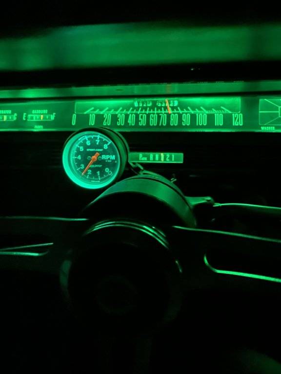

Have replaced my interior and dash lights w/ led bulbs w/ great results. Yes the dimmer control will work w/ the led bulbs

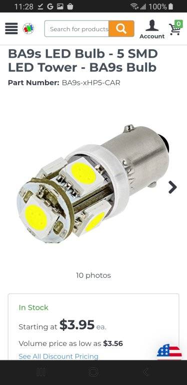

Can you list the brand and model + color you used?

Fully dimmable with the stock dimmer.

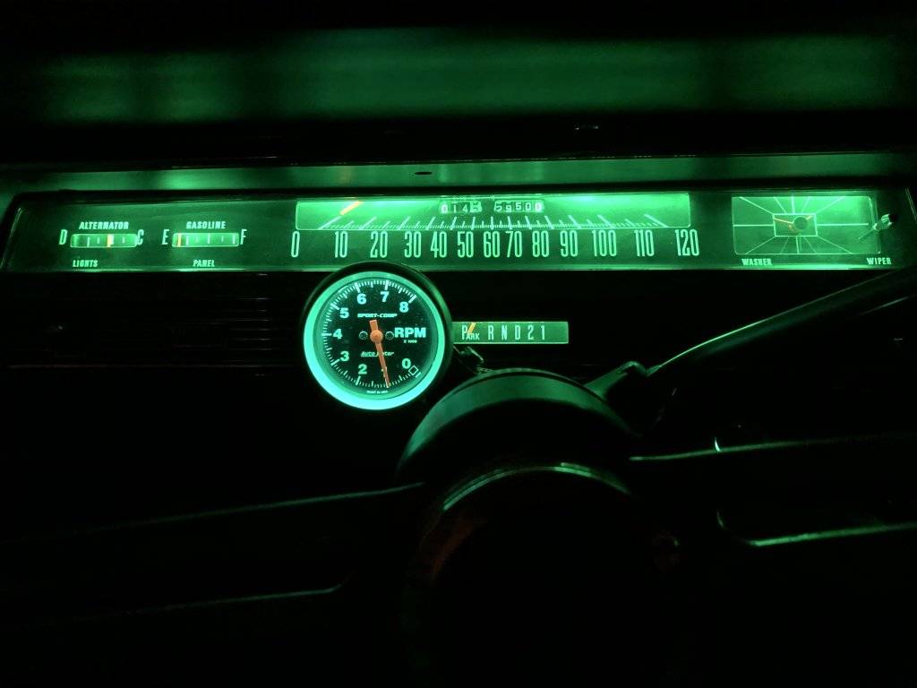

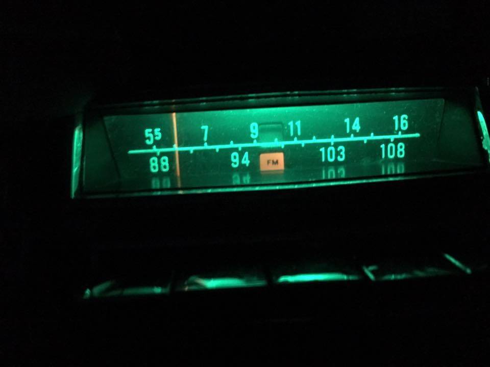

At the risk of being branded a heretic by the C body faithful, I present a couple of picture showing the LED bulbs I installed in my dash:
View attachment 123626 View attachment 123627

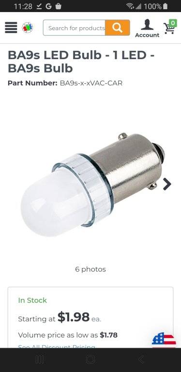

Just saw this post as I'm in the middle of replacing the gauge lights with LED counterparts, which led set did you go for?

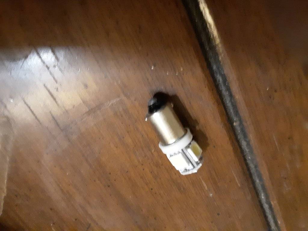

I see there are 180* ( The domed version)
And the 360* (The 5 LEDs surrounding the entire circumference)
The 180* one would make sense for full power conservation while having the bright led feature.
The 360* one would have more light?? As more LEDs but would hog more power.
Also, how did the leds fit into their respectable sockets? The 360* one looks slightly taller than the 180* version.

I used the second version and removed the factory lenses.

Your seconf picture is what I used as a replacement they're available for super bright lights and are very reasonable and price
Much appreciated gents, I'll probably go for the domed version as removing the lenses seems like a PITA.
(I've got a push button trans)
Removing the dash and such, just to get to the lenses doesn't sound great for a novice like me & potentially screw up the trans pushbutton adjustment.

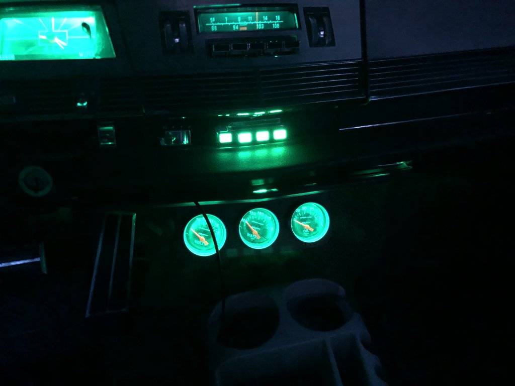

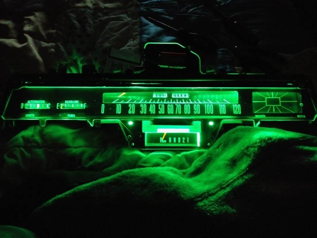

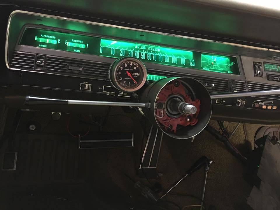

Little update since I did the tachometer and straightened how it sits. Again these are not as bright in person, especially the heater button pics.
Little update since I did the tachometer and straightened how it sits. Again these are not as bright in person, especially the heater button pics.View attachment 569852
View attachment 569849View attachment 569851
Are these white led bulbs or green? They look great!
