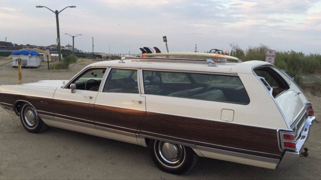

Here is mine ‘72 T&C. Had it from 2016 and is mostly original, just went over 100k miles this year. First few years, fixed some steering components and changed AC compressor. Earlier this year we (I was only tool giver, not mechanically inclined) everything suspension (except rear springs) and rest of steering except box itself. Everything worked for a week! Then the blower died. AC still comes on but no air is moving. Not sure where to start.
Fuel gauge never worked, that might be a future project.
in need of floor mats, not sure what to get and maybe rear leaf springs as they seem “flat”.
Only drove it for about 8k miles in last 5 years as it is too hot and humid in summer here in S Florida.
