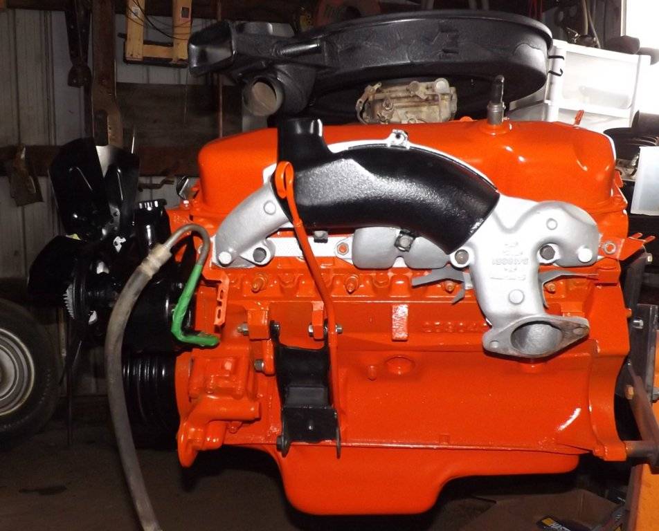

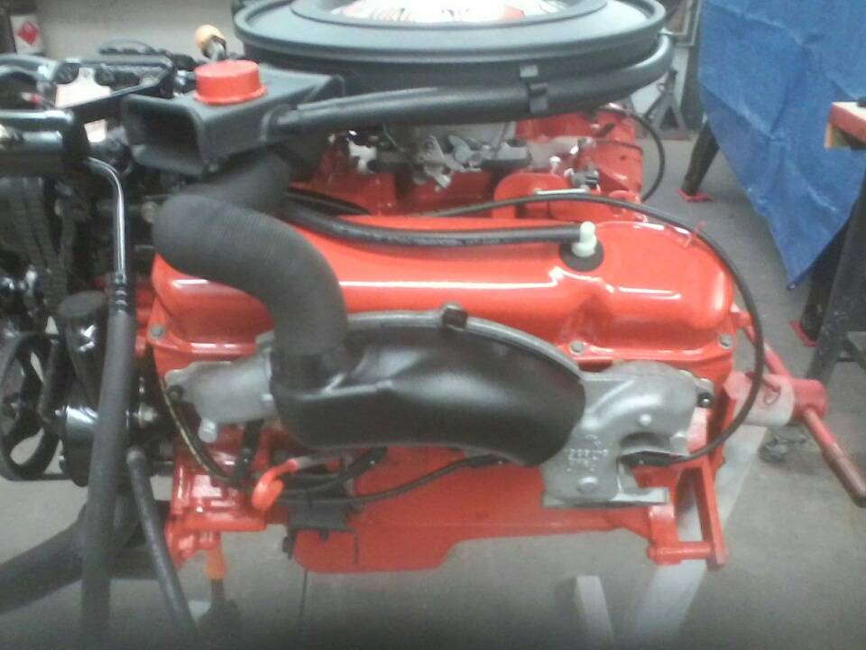

The fins are only visible once the sheet metal stove box, which connects to the air cleaner, is removed.
Mine has the stove box.
There’s your answer!
Damn, another part that I am missing.
And good luck finding that stove, as mentioned, it's 70-71 only, and C-body only. I have never seen one a loose one for sale, and most manifolds have them gone. For this reason I prefer 68-69 manifolds, which are cleaner/smoother.
And that pic of Critter's/Wolfen's shows an easy way to ID a 70-71 HP manifold when in the car, when the pictures aren't clear, or at a non-ideal angle - if the hot air pipe is between #1 and #3 exh ports, it's an HP. The non-hp log manifold has it poking up right at #1.
