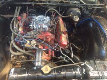

Looking to rebuild my carb.. Can someone confirm kit compability

BTW to the O.P. the kit you have pictured should be fine for a reseal and clean up, because your carb is working now just needs some freshening. I still think your problem is in ignition system but it is not a bad idea to have the kit anyway, because I'm sure in Denmark the local auto parts store does not have it.
Needle and seat and power valves may not be the same... a stock tune carb is no longer in tune if the parts start changing, but I agree with Dave the gaskets should all work. if its your first time with a carb, lots and lots of pics during disassembly may solve questions on reassembly. Gaskets "fit" backwards... but won't work so be very careful matching up all the openings. Also agree the problem is most likely not the carb, but a cleanup doesn't hurt. One more time... non-stick gaskets will let you clean the bowl or recheck the floats if you have issues down the road.

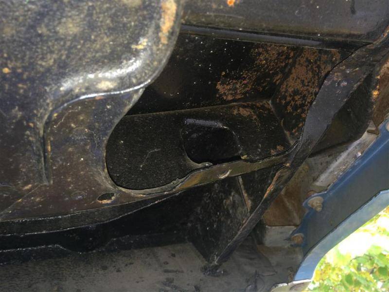

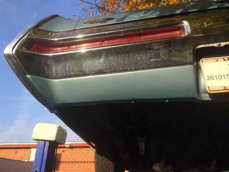

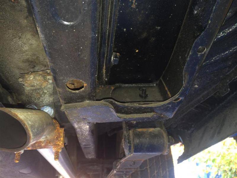

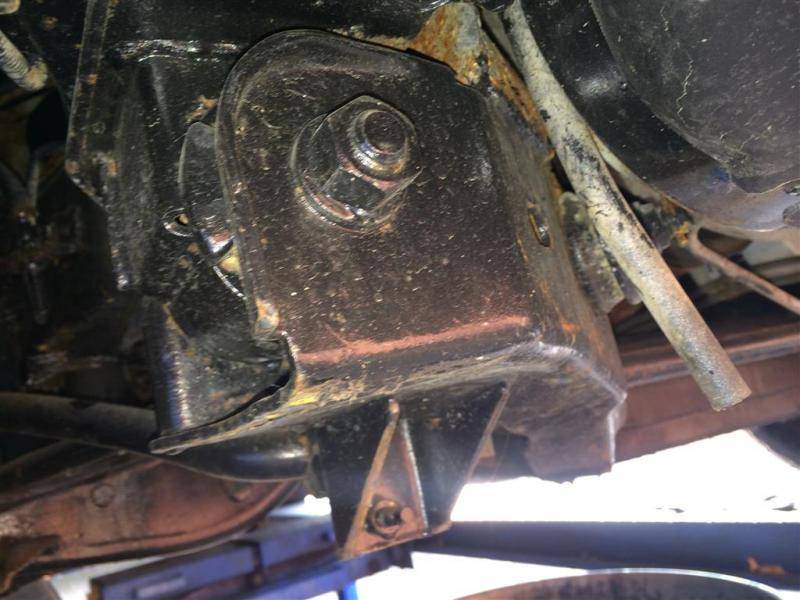

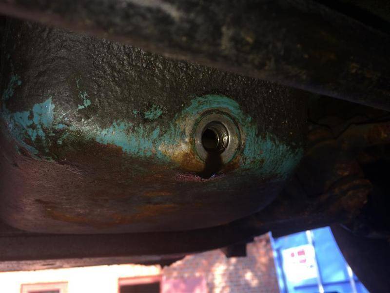

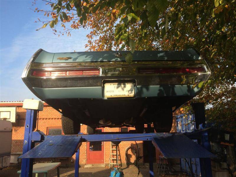

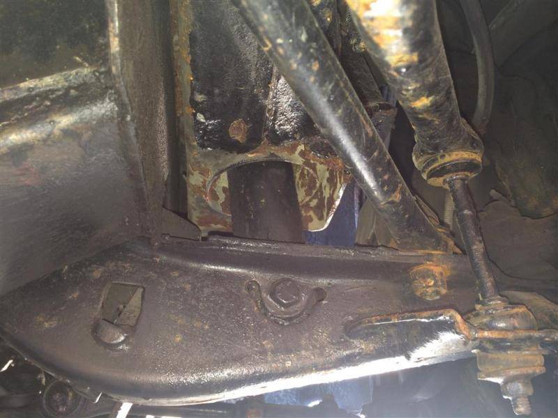

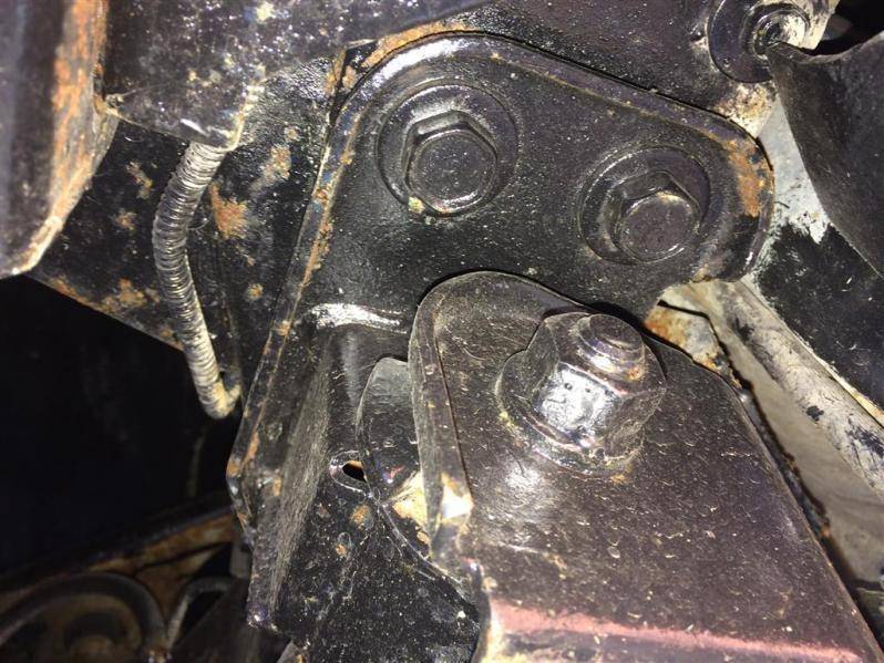

Here is 10 more or less random, mostly under carriage pic's.. shot when I changed the oil shortly after arrival..
(Kasper is feeling VERY lucky, to get this condition, buying an un-inspected Imp at auction in MN.. :-D )

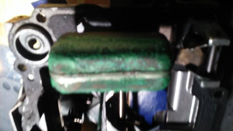

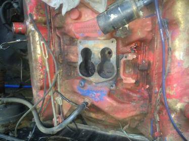

So I had been driving my 63 Fury with a basically stock 440 weekly.I put a 750 Edelbrock 1407 on it last year. It started and ran great , but had a slight flat spot off idle.The car sat for about 6 weeks as I was busy building a garage.
Last week I went and out started it up and it would not idle. If you took your foot off the gas it would die.I thought an idle circuit was plugged, so i choked it out with a rag a couple times from a high idle to stall it and try to suck out a blockage. still no luck. I pulled the idle screws and shot brake cleaner into the idle passages, then compressed air, no change.
I ordered up a kit and pulled the carb. The insides were green and gunky. The accelerator discharge check ball was stuck in it's hole (there's the flat spot). I tore the carb down, (I left the throttle plate shafts in) and soaked it in Chemtool over night.
I put everything back together, no hitches, done maybe a dozen or so Edelbrocks/Carters over the years.
Now I am having a problem with the right side booster venturi dribbling fuel. I took the carb back apart twice thinking it was a high fuel problem, reset the floats, double checked the needle and seat, still doing it.
What should I look at next? I pulled that booster, the tube that feeds it with little holes (emulsion tube?) seems intact and proper.
Sounds to me like either you have a nick at the needle/seat or a pin hole on the float. Those are just guesses and require another disassembly... also get rid of whatever fuel you can and find fresh ethanol free stuff. That seems like a lot of corrosion for a year old carb. If it comes apart again, sounds like it will, shake the float to see if you think there is any liquid inside... heavy float/flooding would result. If the corrosion inside was that bad, you may need more cleaning or you may wind up all the way at just replacing it. Some fuel filters clog or start to come apart from the ethanol fuels which are corrosive in the first place... even fresh.
If you have doubts as to the condition of the carb, post detailed pics here and maybe someone will spot something.
