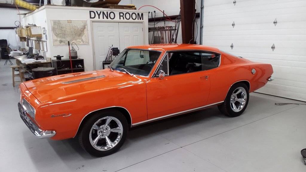

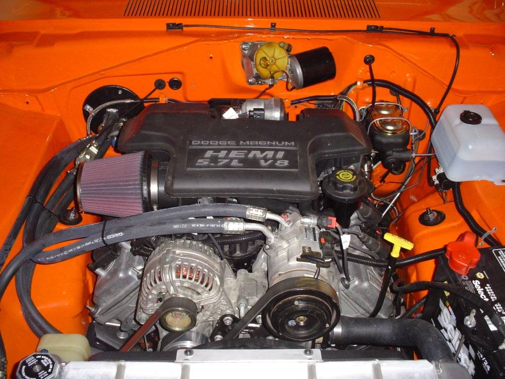

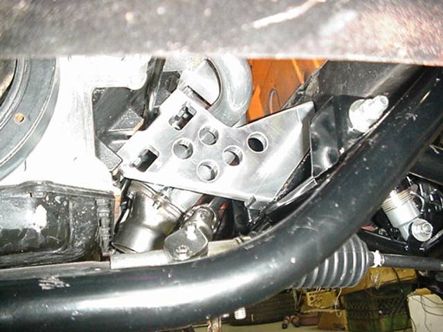

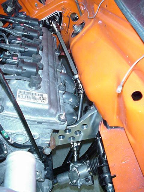

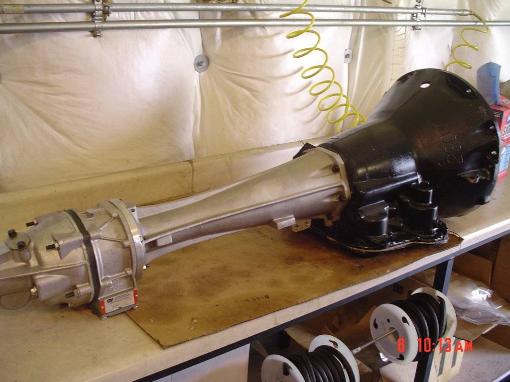

Thanks for the input. But I think most of you are missing my point. Point being to do something different and if anyone had ever tried it before. I know all about the work that would be involved. I did this resto mod upgrade on my 67 Barracuda 21 years ago. There are many things on this car that "they say can't be done", but I can tell you that it is a great car and I have over 30,000 miles on it since I did this upgrade. Let's keep the conversation going. I have not decided what I am going to do with the fury just, just looking for input. Thanks
Nice looking car!
Nice looking installation, too. I suspect your car was a LA motor car, to start with?
