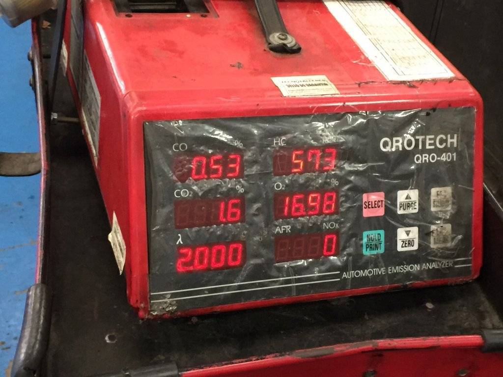

Right now I'm running the smaller primary jet with the bigger metering rod that Holley makes for the street demon carb but my plugs are still black as carbon ! so took the car to a exhaust analyzer and If I'm right according to the results the car actually is running extremely lean so I don't know what can I do

yes, you want at least lambda 0.95 to 0.85. that would equal somwhere around 13:1 afr. You are running quite lean.
the sparks could be too cold of heatrange, I dont recall, have you tried new plugs?! Looking at the CO value, it also indicates lean, try to set idle so that CO is about 3 to 3.5%.
I'm using New motorcraft sparks, Also have a kit of champion 404 but them looks exactly like the motorcraft
