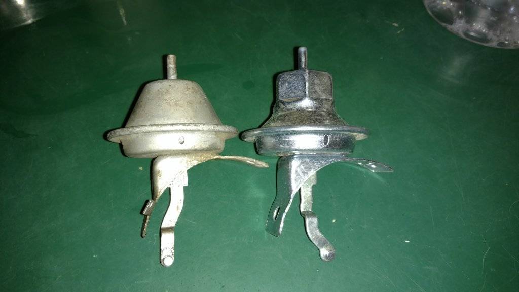

Vacuum can is leaking a little I tried to order a new one but was sent one for a Chevy. Rock auto is the only one who lists one for the 383 they list 2 but one is not in stock and the other one is the one NAPA ordered which does not mount to my distributor and standard lists it as for a Chevy 350 . Will the can off of a 440 work? The only cans I can find for the 383 are for the Electronic distributors and the arms are wrong.

Good luck getting a B/RB points vac advance now from a parts store today. They will give you one with the curved arm not a straight arm like you need.
Thanks I appreciate it. I called Mancini racing and that one won't work on a single point distributer. it is for electronic ignition. Which is what I am finding every where. I may go with the Cardone distributer or a Summit racing distributor. Proform Parts 66993 Proform Electronic Distributors | Summit Racing , Summit Racing SUM-851014 Summit Racing™ Electronic Mopar Distributors | Summit Racing/ The cardone I can fit my Pertronix into it and use my flamethrower coil with the other two I can't use my flamethrower coil because its resistance is to low.

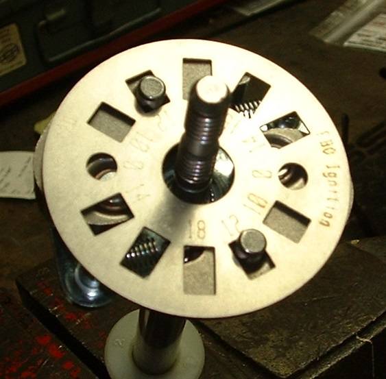

MY reason suggesting this is FBO has a tunable breaker plate where you can do your own " recurve"
Nothing wrong with points, but they are dinosaurs and have some limitations with todays corn fed pumps which need more initial timing and a hotter spark for a cleaner burn.
FBO Mopar Distributor Limiter Plate

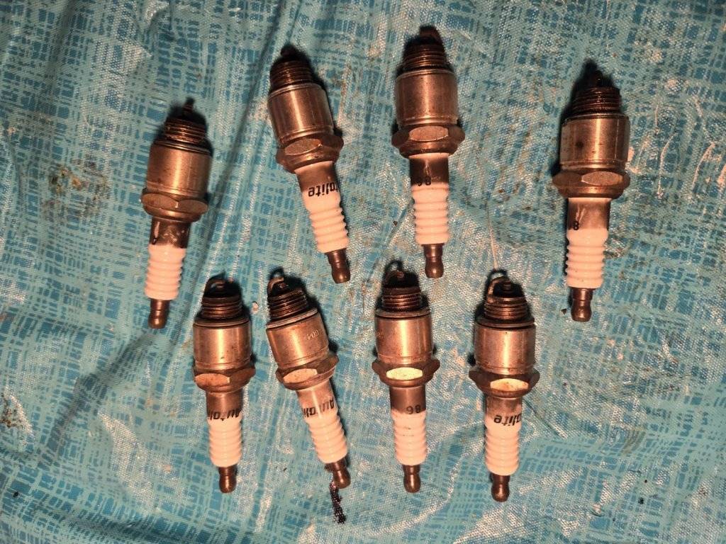

I found 2 problems. The carb was flooding out the float was set wrong. Also I was wrong about the compression. the specks I gave were what I had 3 tears agao when I first bought the car .I have only put about 500 miles on it s o I assumed they were the same. I found the rich issue when I pulled the Pcv hose and the idle went up 1000 rpm. I checked the float level and it was 1/8 inch too high.
I adjusted the float and rechecked the vacuum it was still low but better. At least the idle mixtures screws were responding much better/ I then pulled the plugs and rechecked the compression, I am getting 120lbs cold on all cylinders + or minus 5 lbs. The plugs were all black but the gaps were all right some were almost fowled with soot. / the porceline on all the plugs were covered with soot. I have never see that in 60 years of working on cars. I am posting a picture of the plugs.
I haven't rechecked the Vacuum or timing as a storm drove me in after I got the last plug installed. That no. 7 plug was a real Biotch to remove and replace.
I was able to find a good used vacuum advance.
You can "drive the plugs" clean, get new ones, or knock the soot off of the ones you have. DO run a gap gauge through them to clean the contacts, though.
The compression might come back up when the cyl walls allow oil to remain on them, rather than being washed off/diluted by the rich mixtures.

Thanks I replaced all the plugs. just because. I wiil clean the old ones and save for later, I still have a spark plug cleaner from the 60's'
I am going to put some sea foam in the tank as well.
