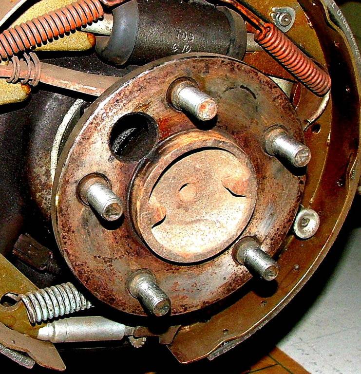

I will bet they are left hand threads and will come right off unless you have damaged them. Driver' side only, look for the "L" stamping.
