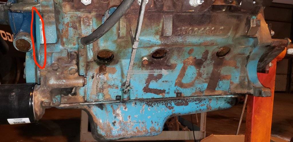

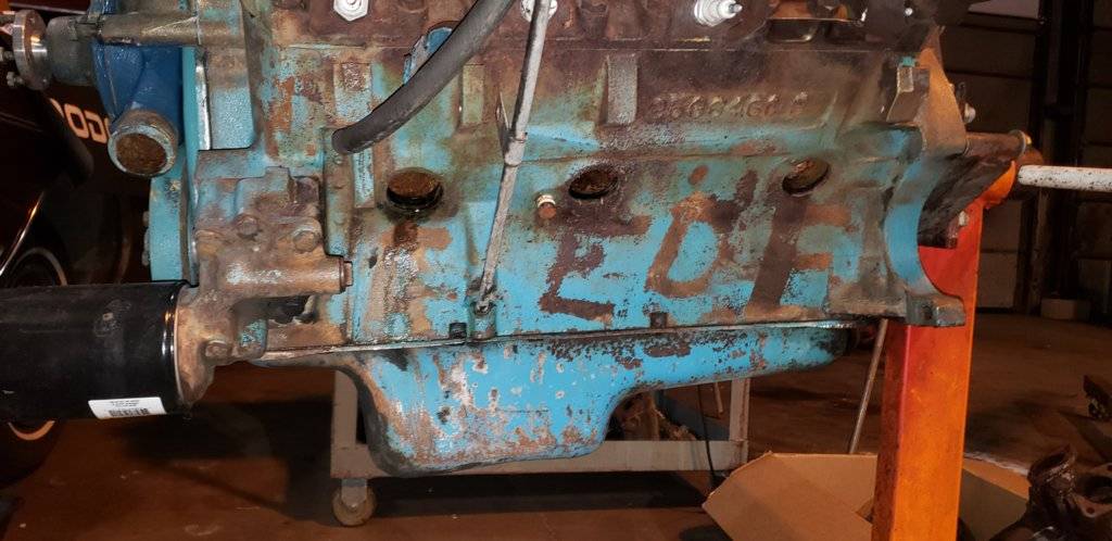

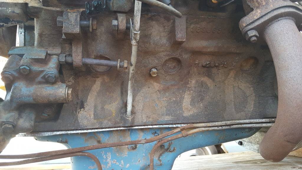

Thanks for all the responses, Guys. @saforwardlook @david hill @CBODY67 @Davea Lux — any comments or suggestions about the markings?

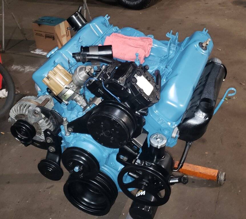

Rip, thank you for the photo! Your repainted engine looks great.
The color in the pic looks more turquoise than the color on my block, though. I wonder whether the ambient lighting might explain the difference, because I don’t think that the Chrysler paint color changed between 1966 and 1971 (Hirsch has the same color for all BB engines from ‘62 to ‘71). Do you happen to have a photo of your engine in sunlight? Alternatively @71Polara383 and I could use a color chart to put next to the engine to judge.

I have never seen such markings before and I doubt those were made by the factory - they are just not typical of factory markings being that large and sloppy.
Also, factory engine colors were "early blue" in 1969 and earlier and "later" blue for 1970 and later. The earlier color had more of a green tint to it whereas the later colors were more pure blue.

Indeed. @71Polara383 and I will be taking pictures of all the stampings and sharing what we find. So far, the only stamping I've checked is the one to confirm that numbers match.

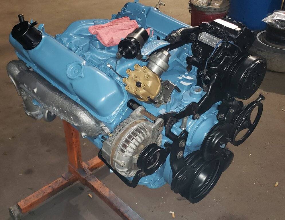

Coming together...
I have a few more little parts to clean up and paint but we are mostly cleaned, painted and reassembled.
I put the exhaust manifolds on without gaskets like the factory intended...should I have used a thin coat of hi temp RTV to ensure no exhaust leaks or??? I would rather address it now vs later in the car.

Coming together...
