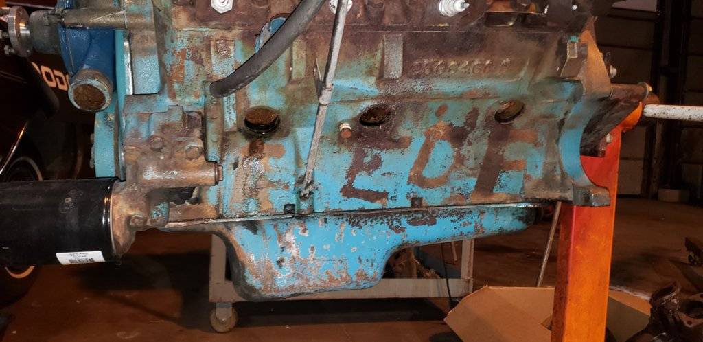

Now for the main question: there is a marking on the engine ( A E D E if we decipher correctly). I wonder whether covering it with new paint would affect the car's appeal in any way? Before proceeding, I'd like feedback.

I've seen some writing on the sides of a few different big blocks.
I'm unsure exactly what it means but I assume it had something to do with the assembly/final inspection process at the engine plant. I dont think it goes any further then that.

I believe it has to deal with possibly how much in the hole the cylinder is. I thought I read something about it a while ago.
it is a reference to which size piston to use on the assembly line. Each bore was measured and marked, then sent down stream. They had a variety of pistons in .001 increments. Line workers grabbed the appropriate piston for each bore. Small block Chrysler used stamped letters on the pan rail. I think SB chebbie did too.

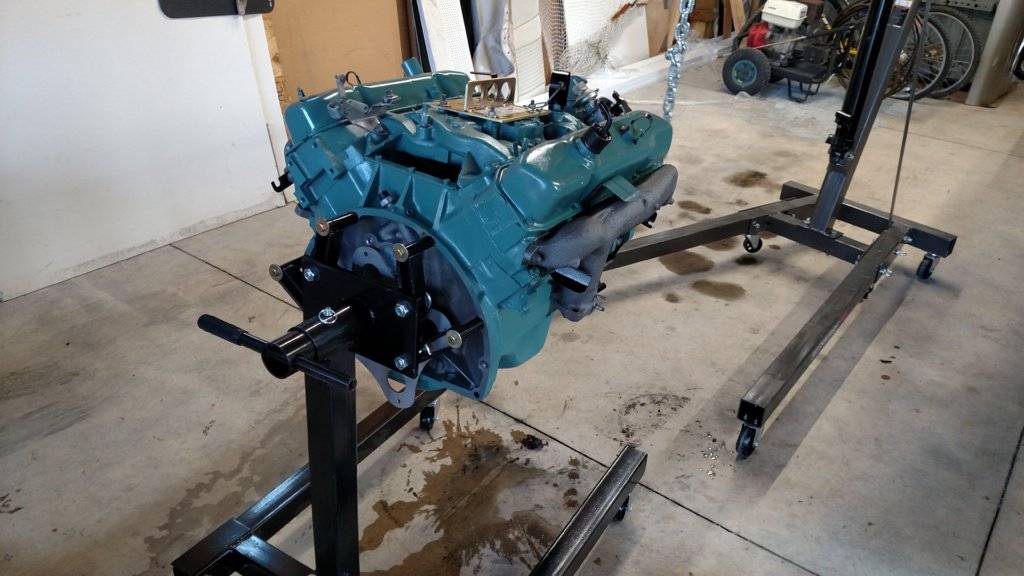

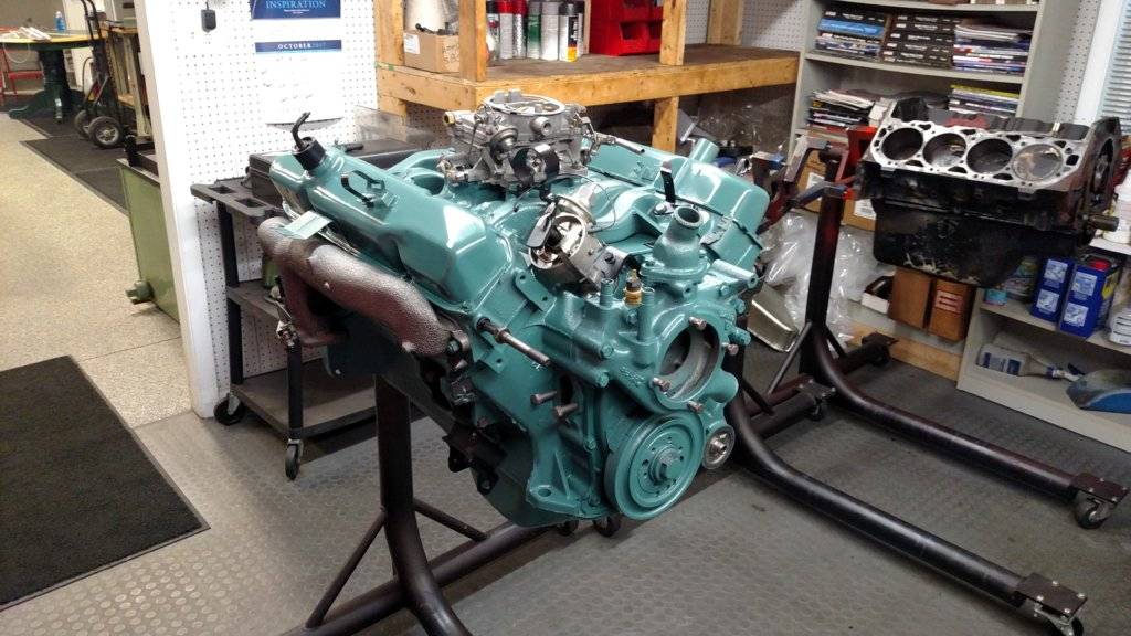

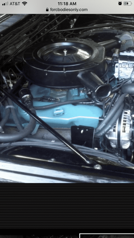

Michel: I don't know how close the Summit paint is to Chrysler turquoise. I used paint from Bill Hirsch on my engine. Here is how it came out:
Almost looks like the writing was put on in some kind of grease marker, “pre-paint”. Looks like bare block where the paint didn’t slick and then revealed itself over the years. I never understood the inspection mark craze on the more expensive restorations, it just looks messy to me. Document it then make it look pretty.
Rip, thank you for the photo! Your repainted engine looks great.
The color in the pic looks more turquoise than the color on my block, though. I wonder whether the ambient lighting might explain the difference, because I don’t think that the Chrysler paint color changed between 1966 and 1971 (Hirsch has the same color for all BB engines from ‘62 to ‘71). Do you happen to have a photo of your engine in sunlight? Alternatively @71Polara383 and I could use a color chart to put next to the engine to judge.

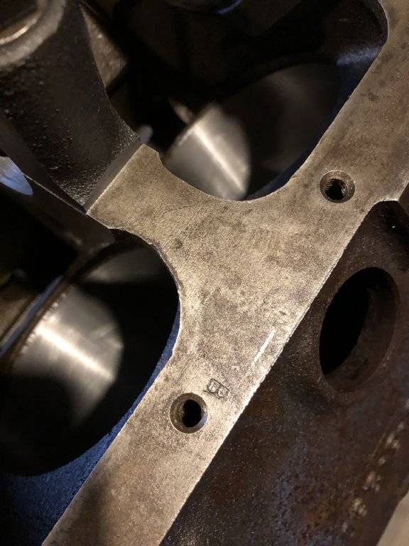

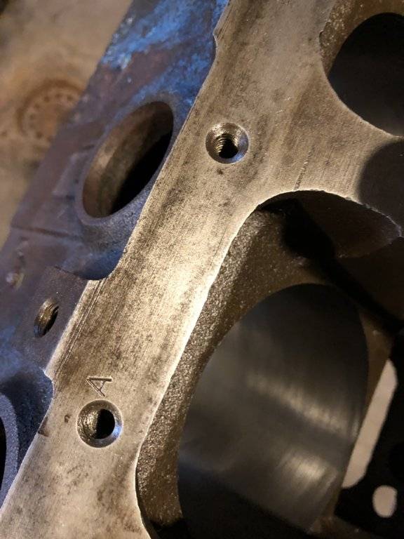

Here are the letters stamped on my 71 360 block I’m building.

Michel: The picture I posted was taken under florescent light at the machine shop that rebuilt my engine, and of course my phone and our monitors could have affected the appearance of the color. Also, the paint on your engine looks like it is Chrysler corporate blue - not turquoise. I know turquoise is correct for '66 and later models up to at least '69 and maybe later - I think. I am very happy with the Bill Hirsch paint I used. It seems like all the other manufacturer's turquoise paint is just not quite correct. Here is another shot taken at The Garage Mahal with the doors open which admitted some daylight on the engine:
As Dana said,markings from the factory.
Covering them up is fine.

I am comparing it below to Rip's "natural light" photo. Adjusting for the darkness of the photo, this seems like the same shade of blue.

You really cannot use the paint on the engine as reference after 50 years worth of heating/cooling cycles and exposed to the elements.
Naturally it will be lighter than the new paint which will be darker as shown in Rip;s pic.
