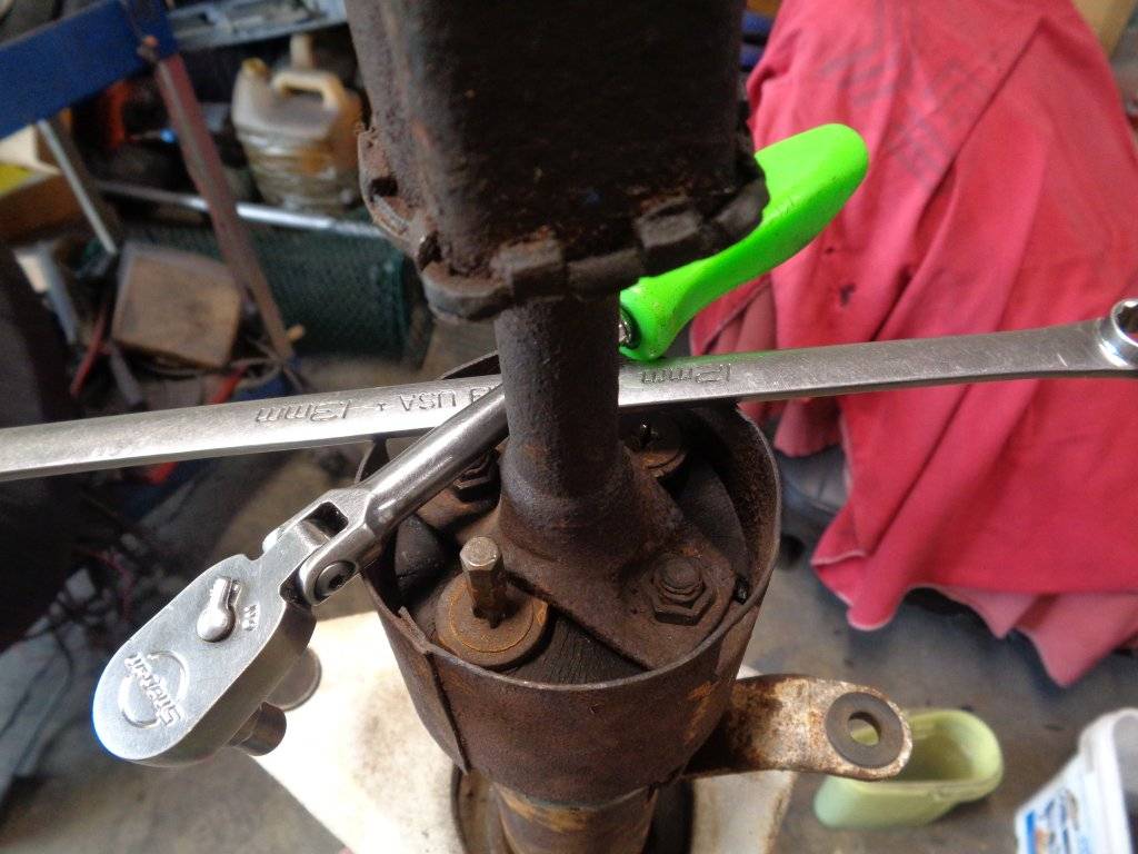

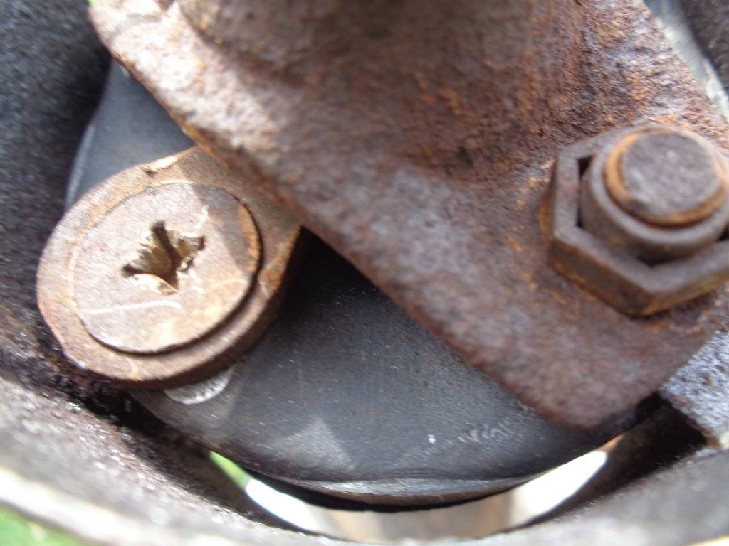

You can remove the rubber insert and inner sleeve and weld a large washer to the outer edge of the remaining bushing sleeve and press it out from the back side, what I simply illustrated was a simple version using common tools
When I was a teenager and replacing A-arm bushings on my Chevrolet back then, I think I used a hacksaw blade to cut the outer bushing shell after laboriously removing the inner sleeve and rubber bushing.

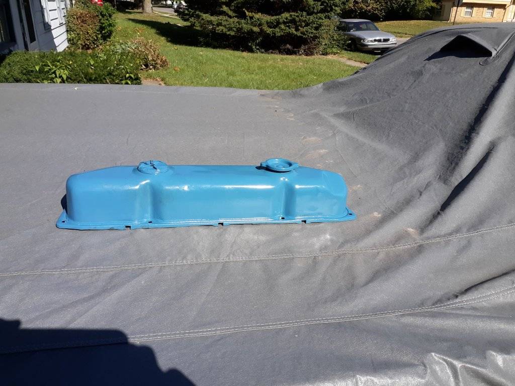

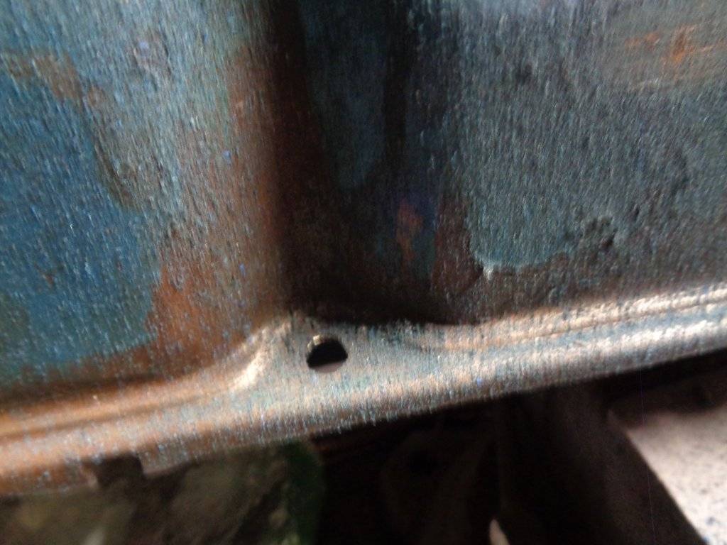

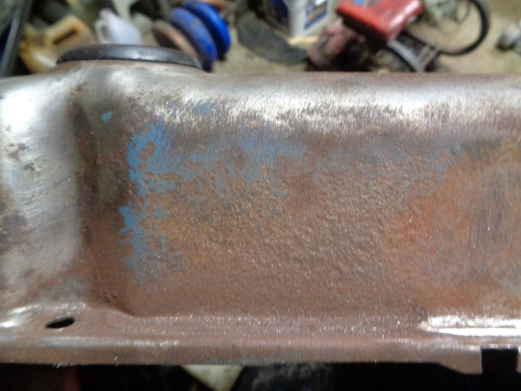

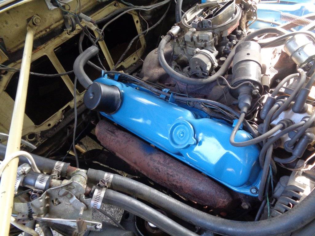

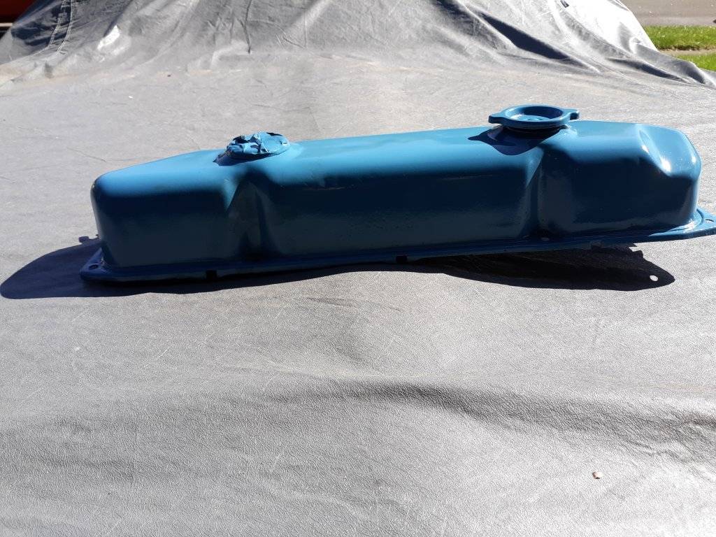

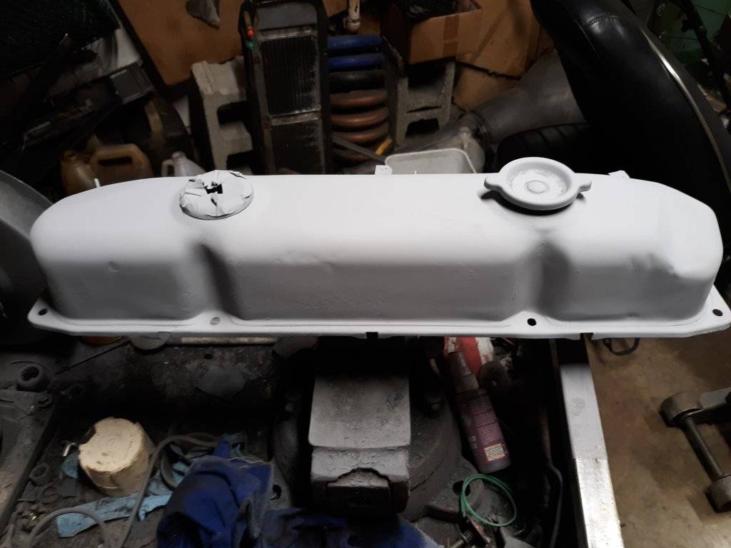

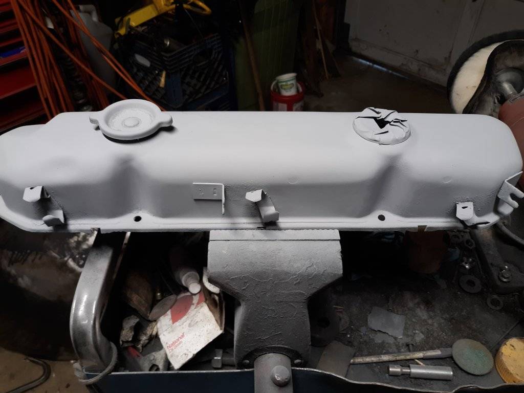

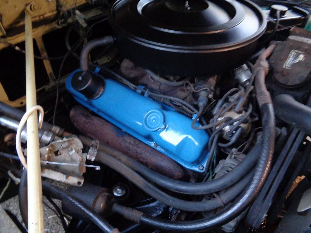

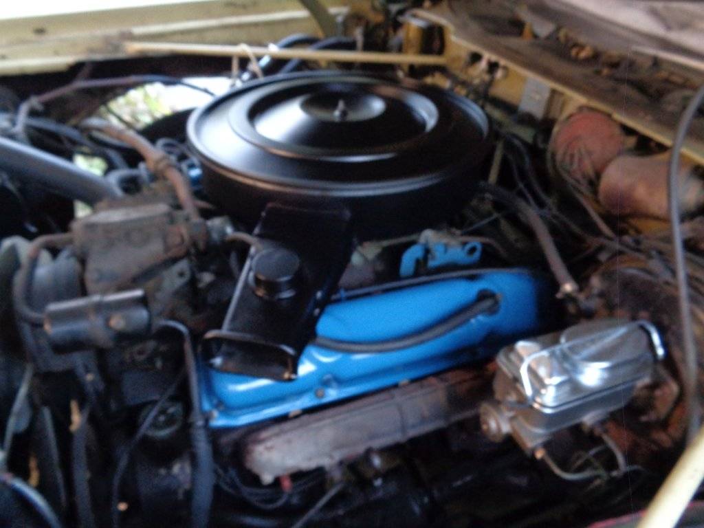

Hereis the latest update on Buttercups trips here at the MOPAR Spa. Both valve covers leaked oil requiring new gaskets and a much needed repaint.
Both valve covers were heavily rusted. Much more time was spent prepping and grinding out the rust than the actual time painting.

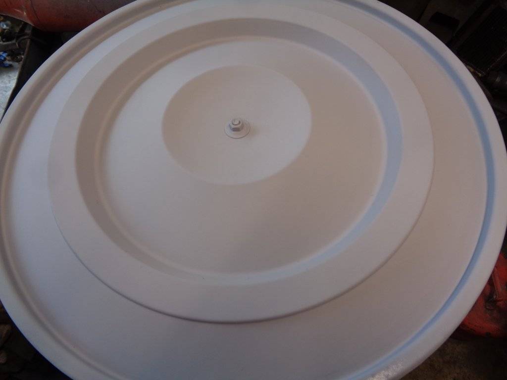

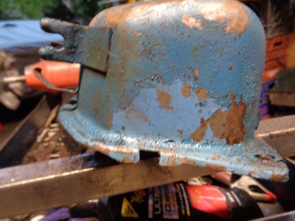

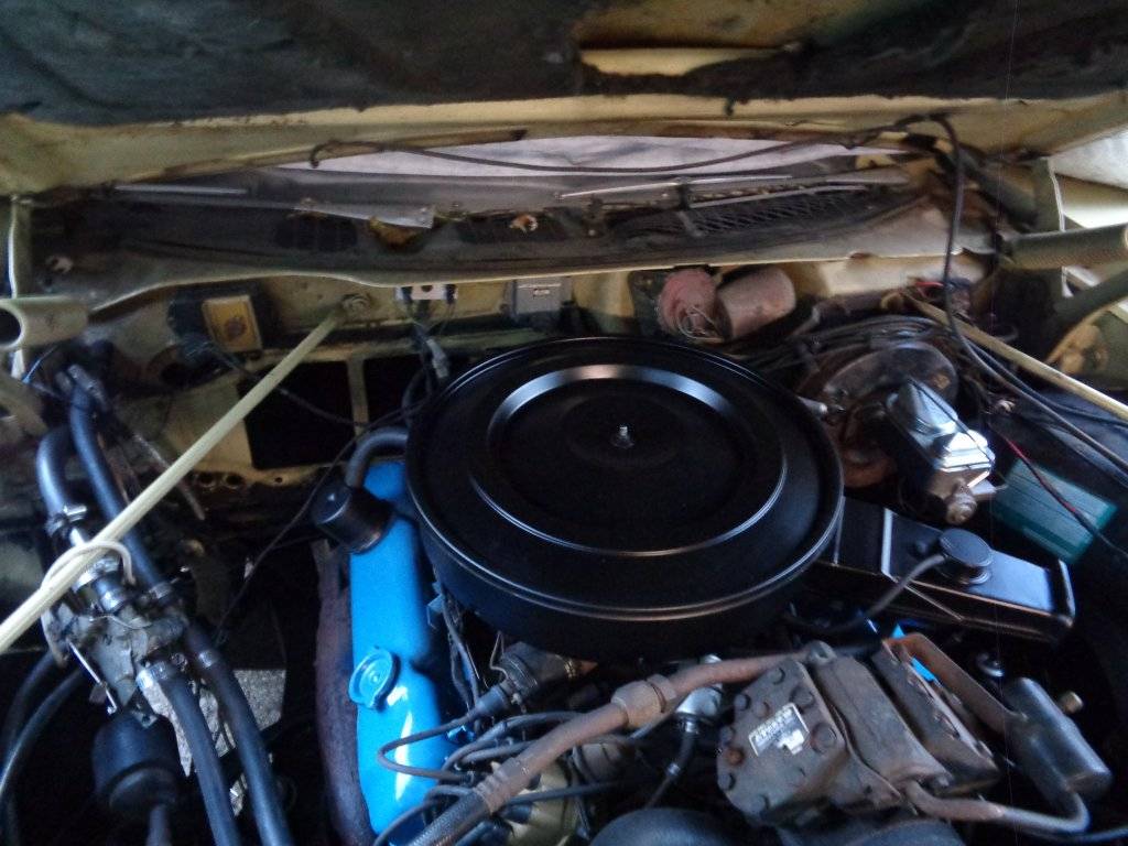

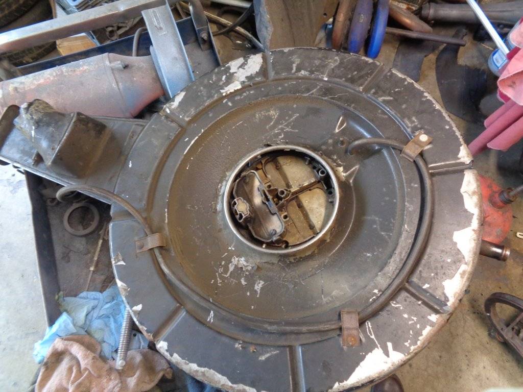

While is was there the air filter housing was in need of a little love. After sanding and sanding and many primer coats much better.

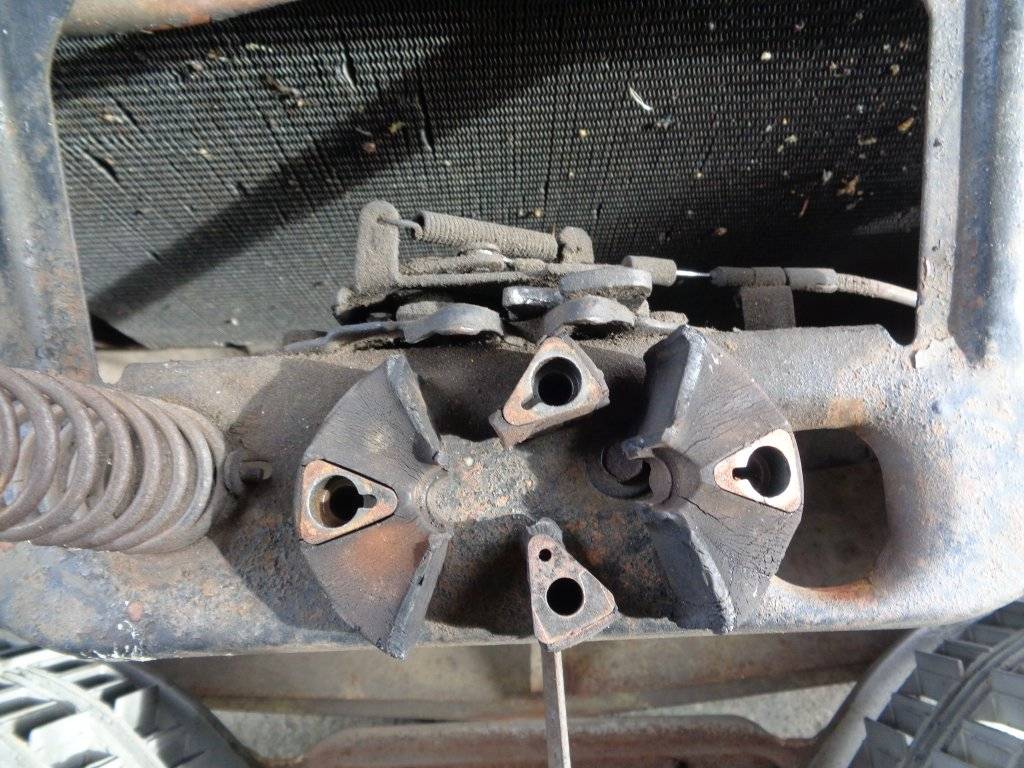

To finish off the suspension rebuild was replacement of the rag joint. The screws were seized so steering column removal was the only option. With the column out servicing was pretty easy as the following photos show.
Thank you @david hill -- wonderful to see the car coming along.
For those keeping track of parts, the steering coupler or "rag joint" is now reproduced by Lares (model 220). I had bought 5 of them for my cars last year, and one of them is now in Buttercup.

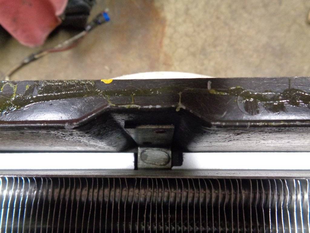

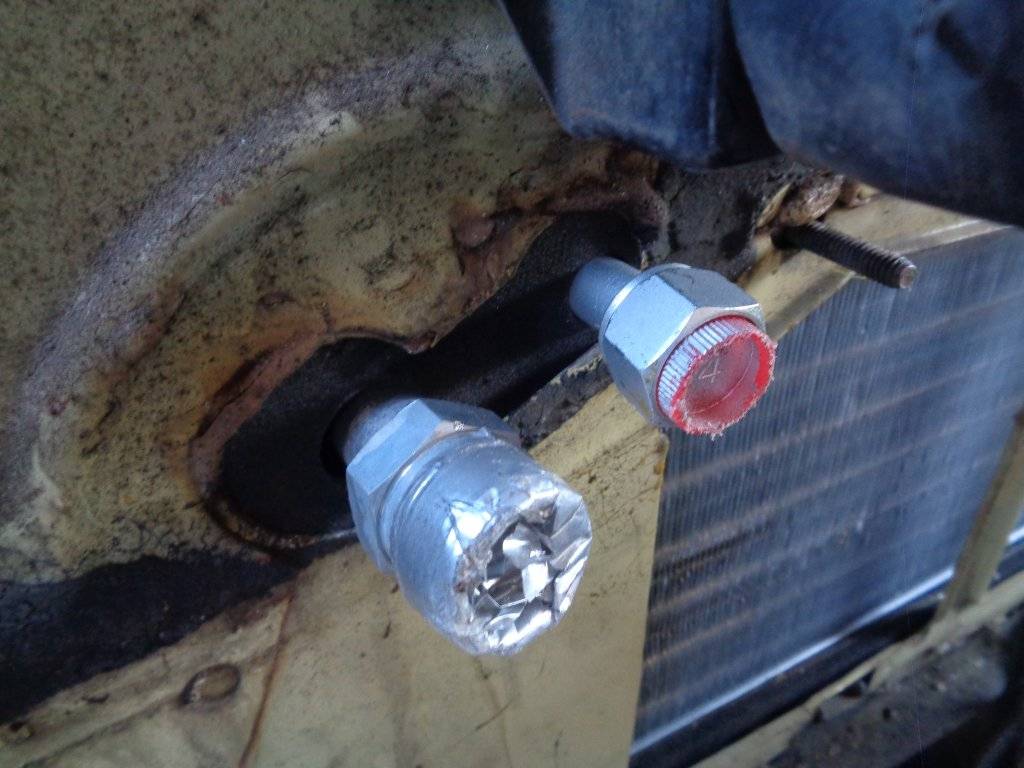

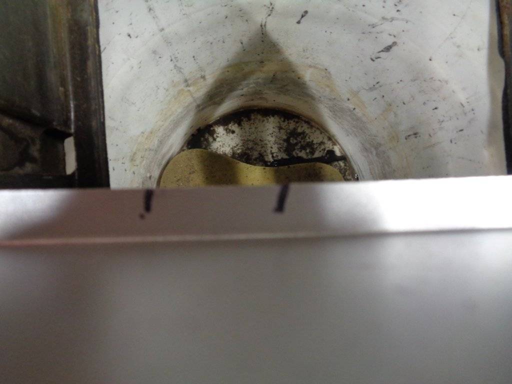

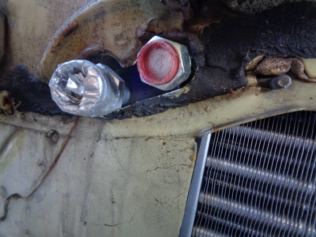

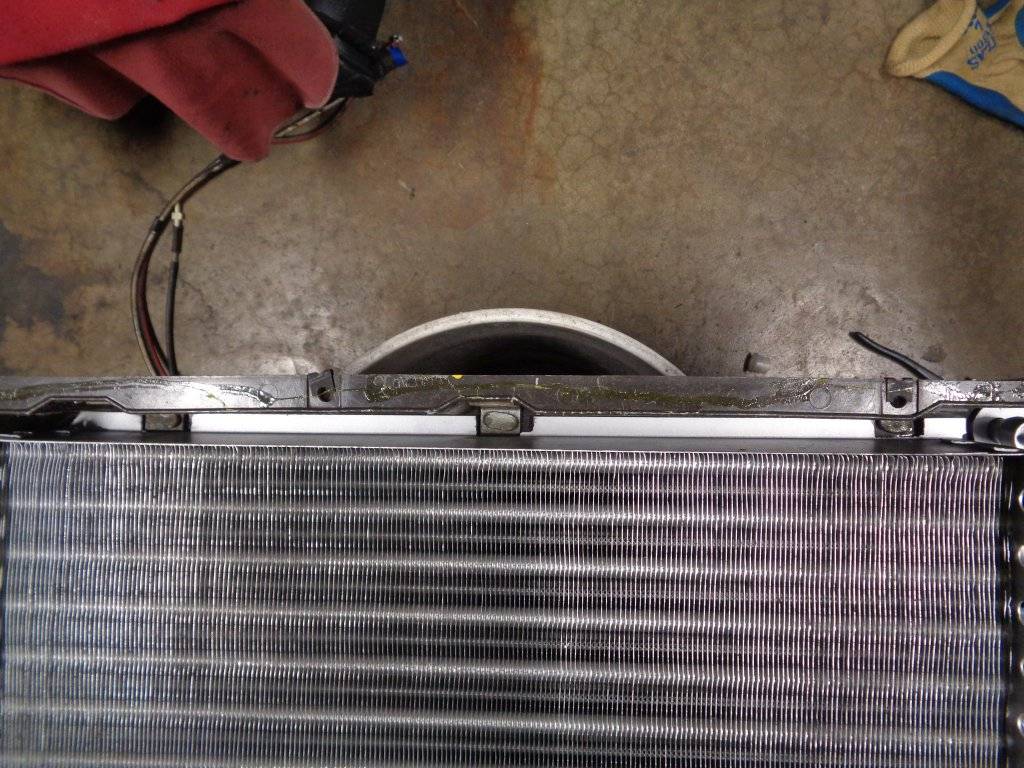

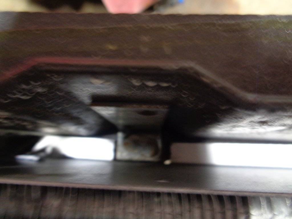

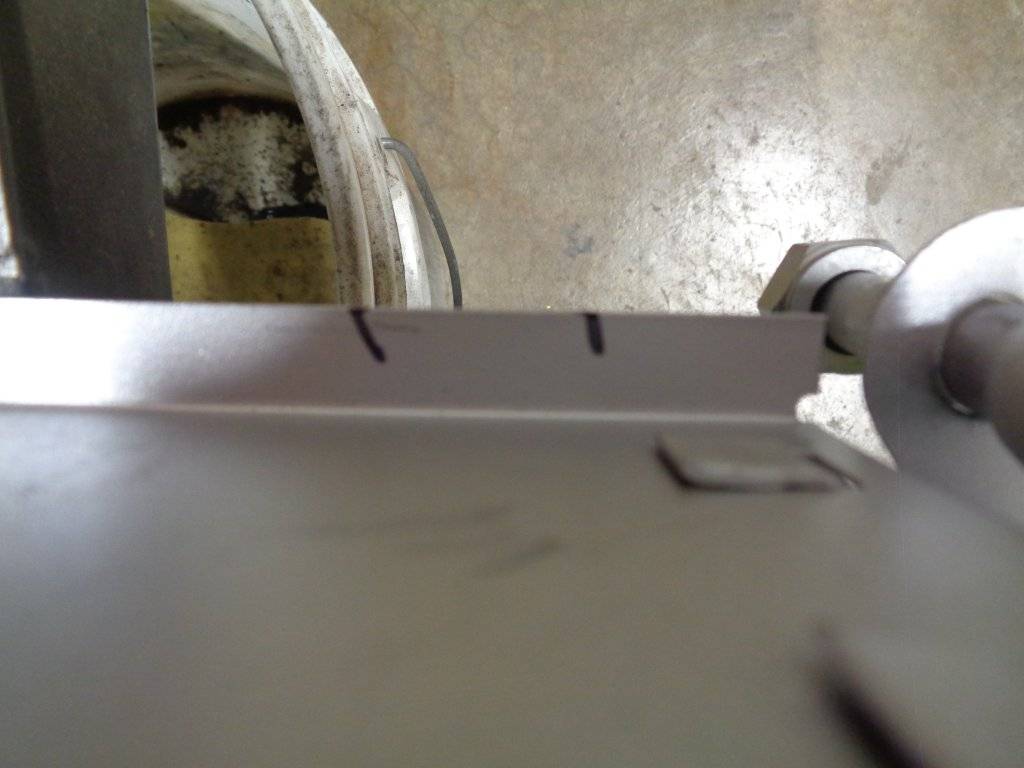

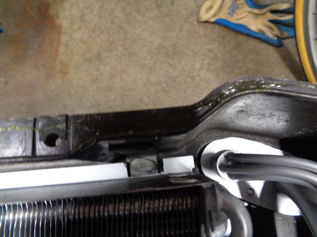

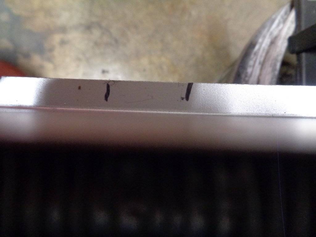

Here is my update on @AC Global evaporator core installation. The new unit made off the original evaporator core fit pretty well w/ a few problems. First there were no provisions for clearance of the heater caser mounting studs. Using a Dremel Tool I cut reliefs into the core tin housing as shown below.
In the next photos show how much better the offset was done on evaporator core. That allows for proper fitment of the heater core. More offset needed of the low and high pressure can be seen in the last photos.
