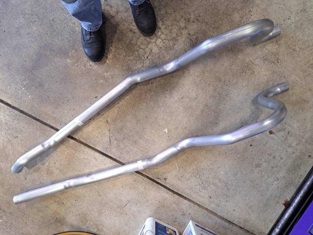

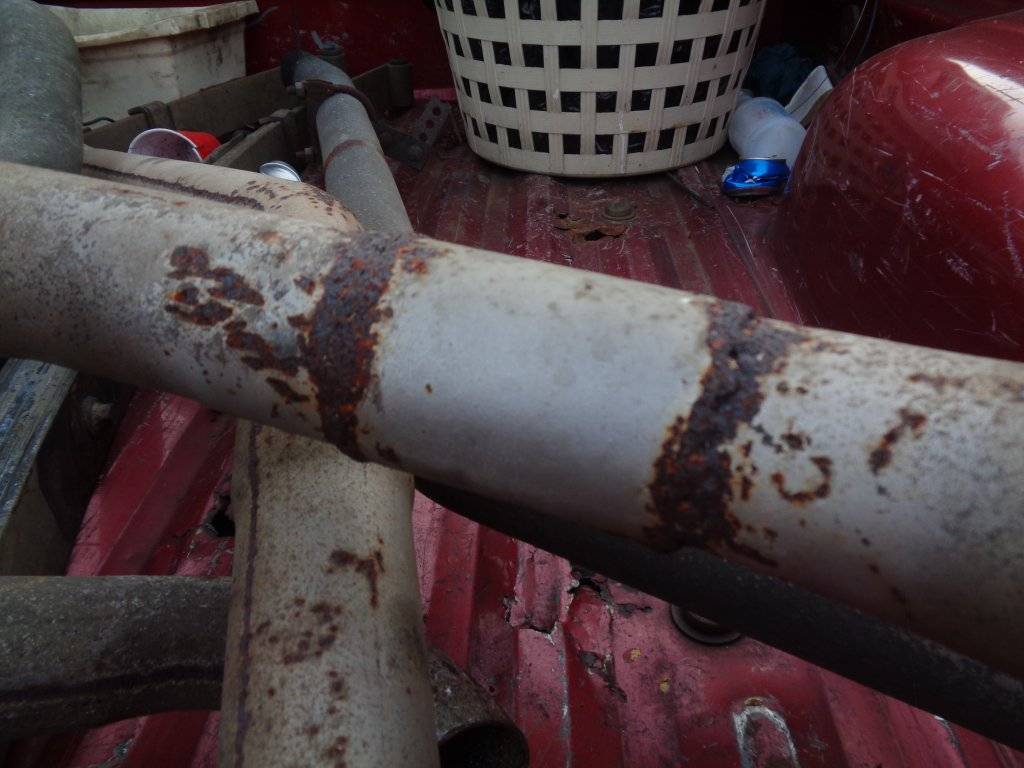

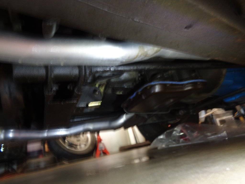

what mufflers r u useing can i recommend flowmaster 40? mine aftr we goy i rod ready before i rebuilt the 440Here are the new replacement parts. Shown are the left and right 1 piece manifold to muffler pipes. Left side was spot on. the right had to be massaged a little. It appears the correct exhaust hangers need are the same as my Hurst 300. Universal hangers were employed currently. see last 4 photos

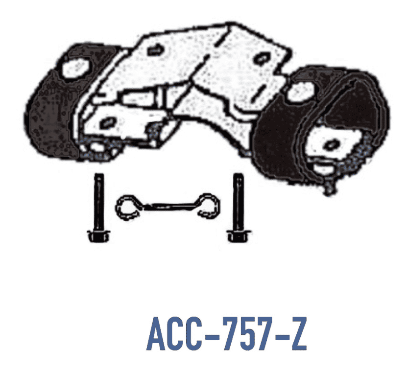

My Barracuda exhaust came from there. The Formula S uses a big single rather than duals and they make a really nice reproduction.

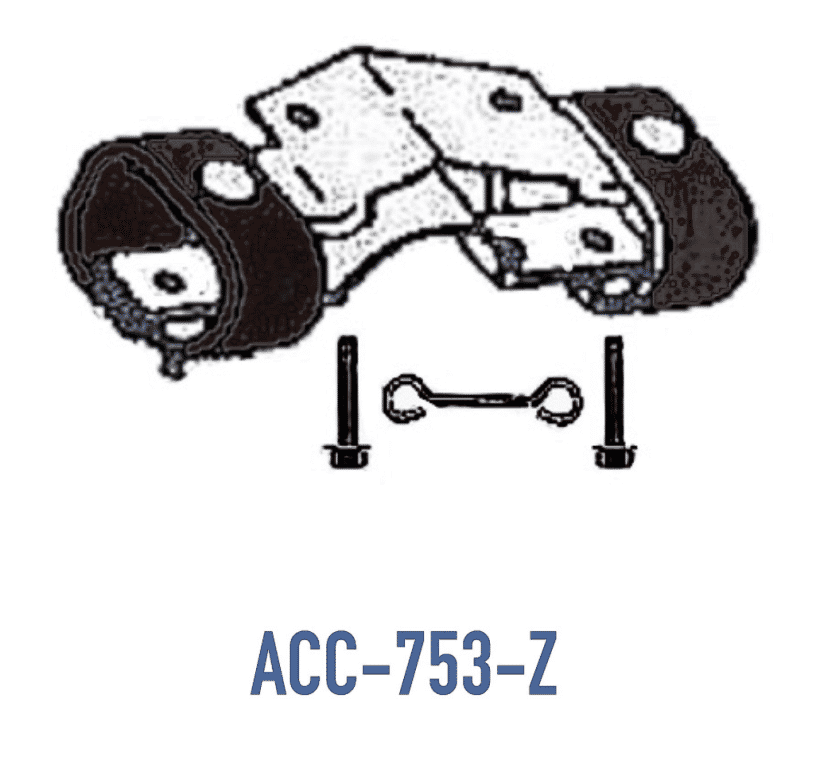

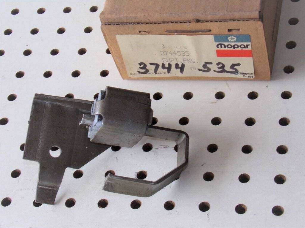

@david hill Did you check this place? C Body Hangers, muffler and tail pipe

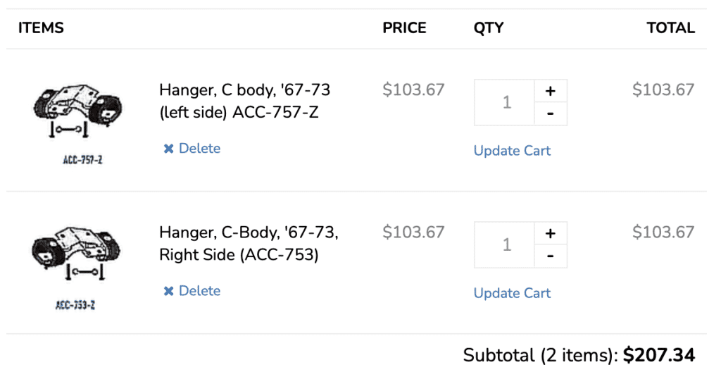

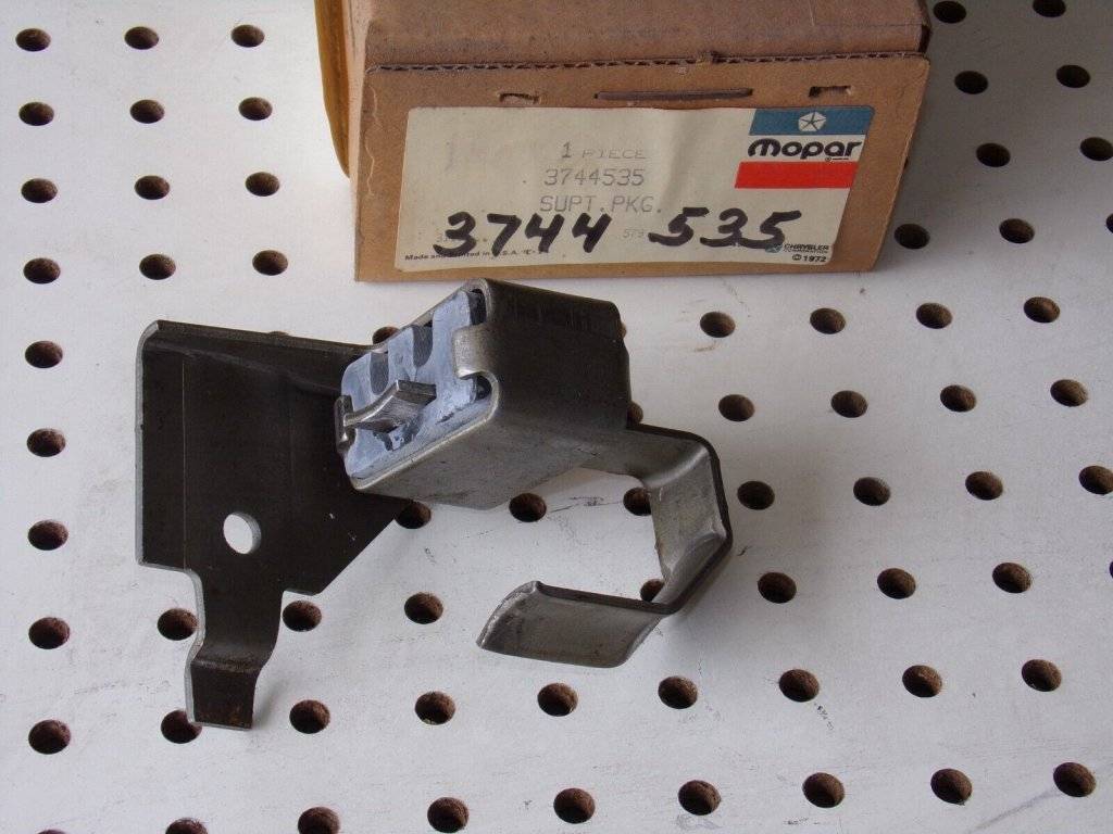

Thank you both. If memory serves, I bought all the ones that @marty mopar and Len Dawson had for other cars. @saforwardlook has also recommended Accurate Exhaust, and so if I cannot find a NOS part then that's what I will order.My Barracuda exhaust came from there. The Formula S uses a big single rather than duals and they make a really nice reproduction.

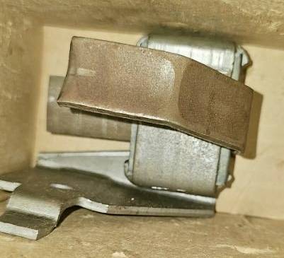

@ayilar Hilltop has one for $175 that'll most likely work on your 72 Chrysler, even though it says 67 to71. NOS Mopar Left Tail Pipe Hanger 1967-71 C Body 383 440 Dual Exhaust - Hiltop Auto Partsif I cannot find a NOS part then that's what I will order
I agree, and Buttercup is supposed to be a good-looking reliable driver, not a garage queen. @marty mopar and Len Dawson were much more reasonable than the price you quoted, which is why I bought all that they had.@ayilar Hilltop has one for $175 (...)
Why waste money on NOS unless you're going to enter your car in a 100-point competition? They'll be full of road grime after a week of driving. I'd be fine with the re-pops from Accurate Ltd.

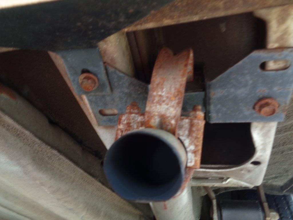

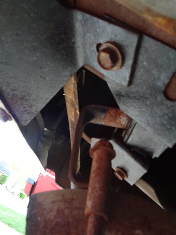

Thanks for the link Tim. Universal hangers don't fit well w/ our 69-73 Chrysler models. The exhaust from Waldrons fits pretty well. Universal hangers were found everywhere w/ this hacked exhaust system I removed. There are some very tight clearances over the rear axle and rear bumper. Just trying to do a better job w/ fitment. The previous exhaust hung lower as it was installed. The new Waldron system fits up underneath nice and close like the OEM did.Most of the places selling NOS items typically ask big money for parts they sell.
Thought you mentioned you were looking for an NOS hanger. Thats why I was trying to help you out with the link.
Since you already bought up everything, send a set to @david hill to install on your car.
Not a chance!I am interested to see how David's Hurst compares to my memory of my 70 300 with TNT.
