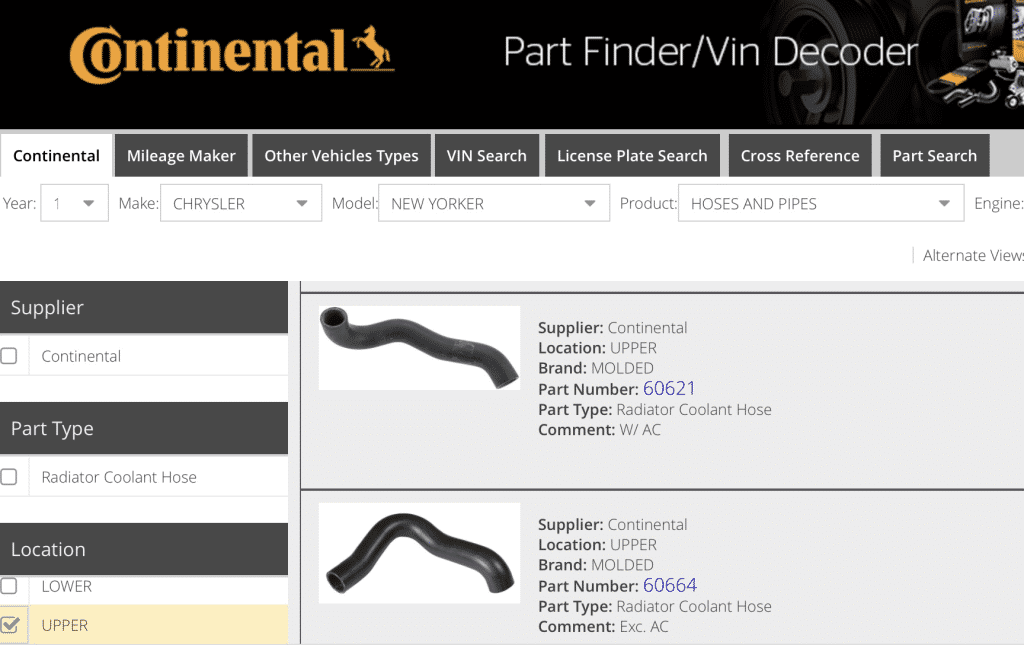

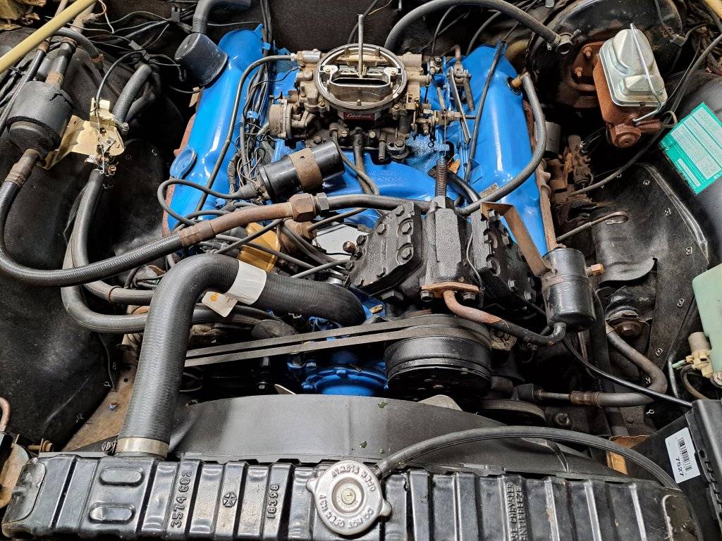

@david hill is currently breaking in the rebuilt engine. He recommends that the radiator hoses, which he and I had replaced about 2.5 years ago, should be replaced (more on this below). I checked on Rock Auto, and they have the following Continental and Gates models. I don't know, but to the eyes of both David and me, the pictures look rather different! :confused:

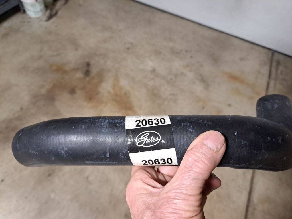

The Gates 20630, which works great on my 1970-1971 Dodges, is not correct: I had bought one back in 2021, and it did not fit Buttercup -- so David had to replace it at the time with a local NAPA part. The Gates 20630 hose is still in Buttercup's trunk, for possible use on a Dodge:
That NAPA upper heater hose from 2021 is now getting changed. David thinks that the likely cause is coolant contamination. Off the car it will thus go after break-in, as will the lower heater hose (which David tells me is swollen at both clamps).
The hoses that David asked me to order for Buttercup this time are Continental (upper) and Gates 20663 (lower). The question was, which is the right Conti part number?
--> For my 70 300 TNT 'vert, I used the Continental 60664 as that was the unit that the manufacturer recommends for a 440 with A/C (and it matched exactly what David had on his own 1969 300 TNT 'vert, see here; BTW, for that Chrysler also, the Gates 20630 was listed as compatible on RA but did not work).
--> However, for a 1972 T-code Chrysler, the Continental website says P/N 60621 for a 1972 NYB with A/C and P/N 60664 for one without A/C.
I am puzzled, because David and I think that the 60664 should work too (@lemondana said, in another situation, that both the 21 and the 64 should work).
Sooo, being curious, what I have just done is to order both (plus a Gates 20663; Edit: by mistake, I ordered the Continental 60659 -- it should fit, we shall see), and then we can see if it matters for the upper hose whether a 1972 Chrysler with 440 has A/C or not.
Well, folks, the verdict is in. From @david hill a few minutes ago:
1. "The lower hose 60659 is the proper lower hose fit." No surprise there, but nice to confirm.
2. " The Continental 60664 is a perfect upper rad hose fit. The 60621 doesn't have enough belt clearance." David was expecting this outcome, but I was not as the manufacturer specifically recommends the 60621 for a Chrysler with 440 and A/C (see my post above). BUT it is not really surprising, as David pointed out to me, because the same manufacturer recommends the 60664 for a 1969 or a 1970 Chrysler with 440 and A/C -- and David and I both installed the 60664 on our 1969 and 1970 300 'verts, both of which have A/C and a 440 TNT -- and it is a perfect fit for both cars.
Bottom line, for A/C cars, I will use the 60664 for all fuselage Chryslers with 440 and A/C.

As Michel stated above, I found clearance issues w/ the 60621 comes pretty close to the Alt -A/C dual drive belts. These belts under extreme conditions can come in contact w/ the upper Radiator hose. The A/C compressor placement is exactly the same for 1972 New Yorker as the 1969 - 1970 Chrysler 300. As the first two photos show the original upper hose Vs the last photo 60664 replacement upper hose. I like a little more clearance given Buttercup sees a lot of highway driving.

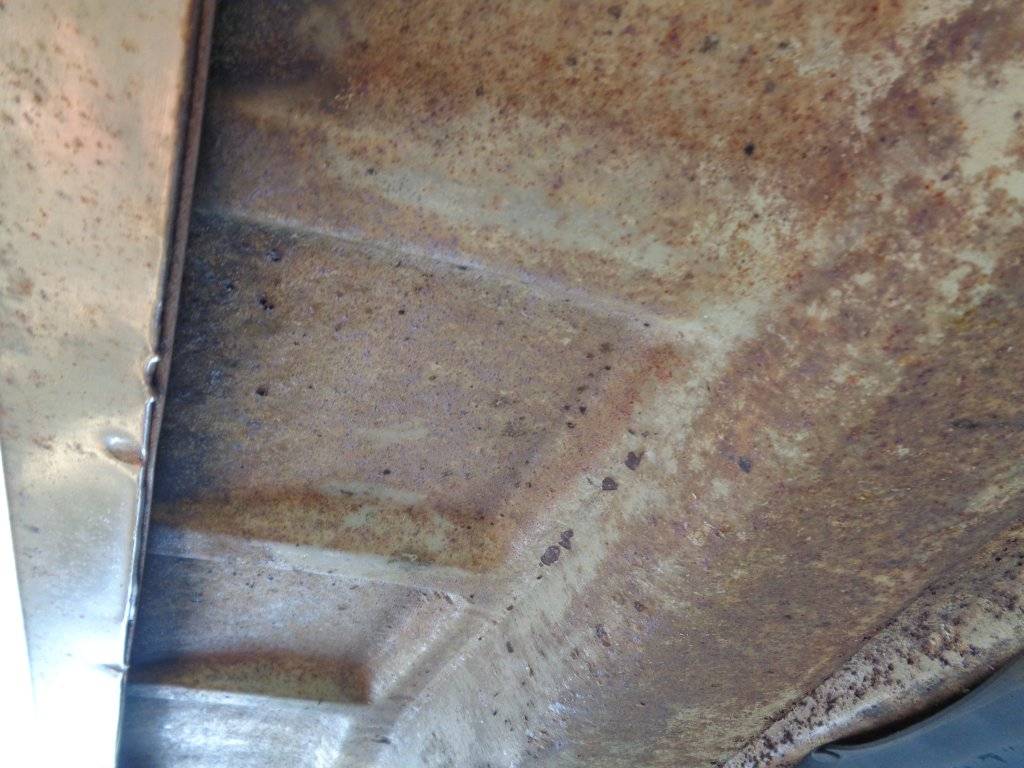

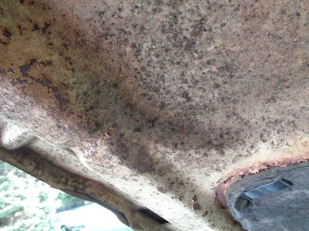

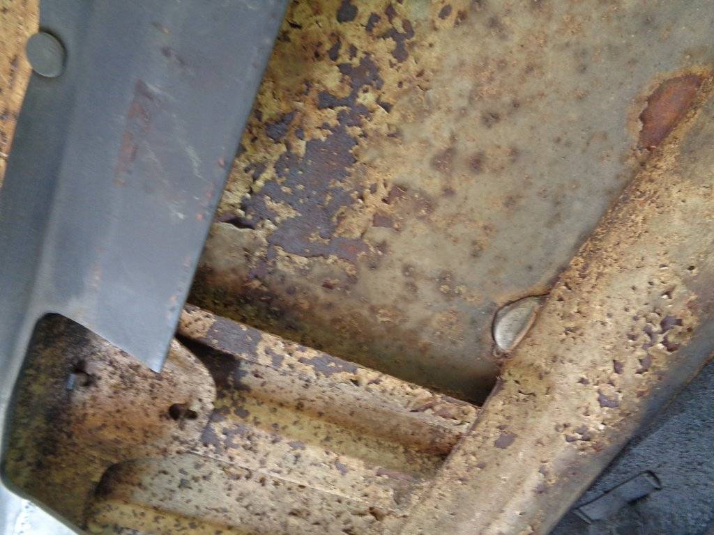

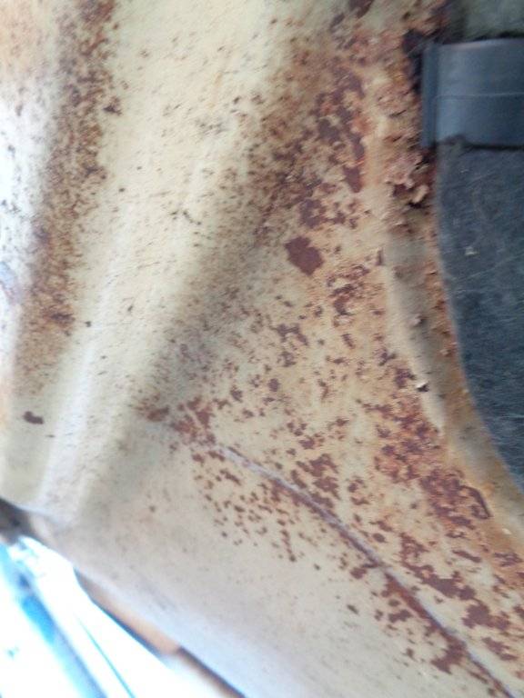

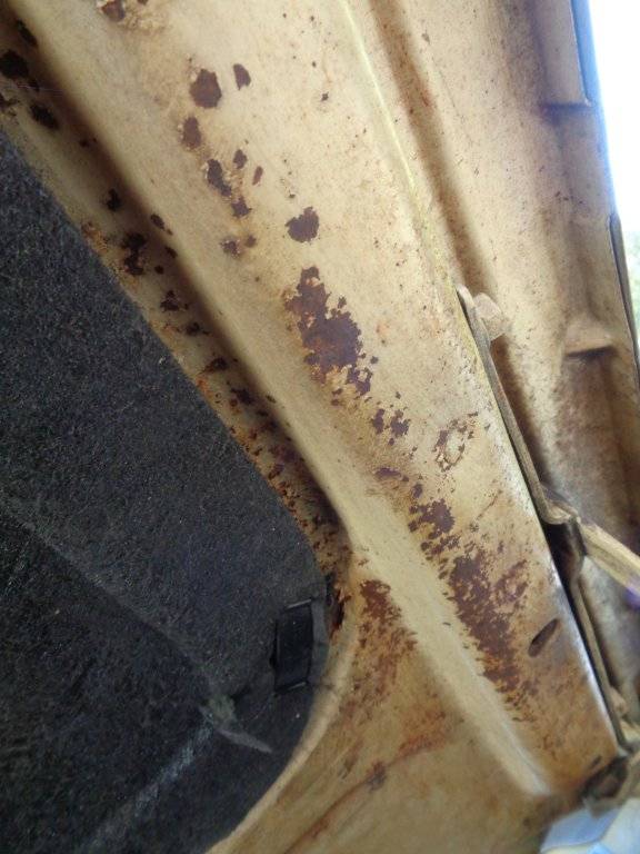

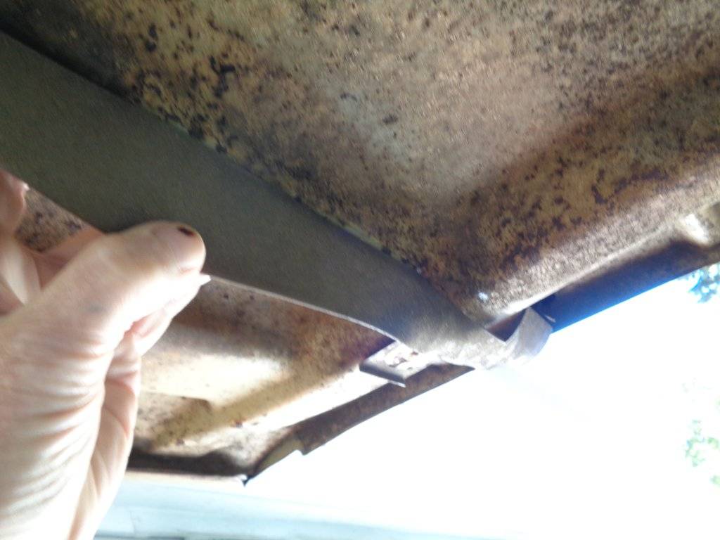

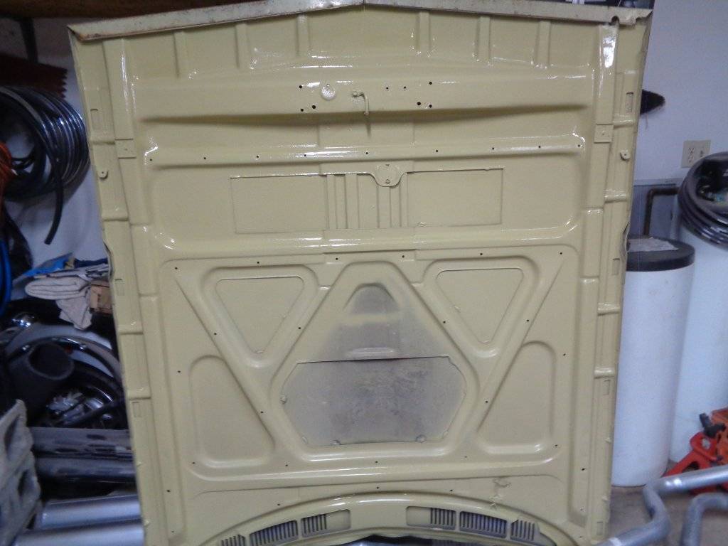

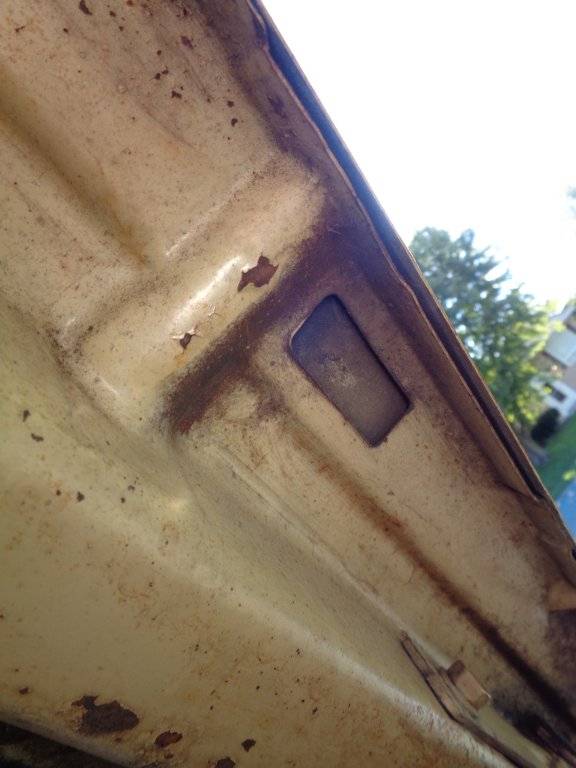

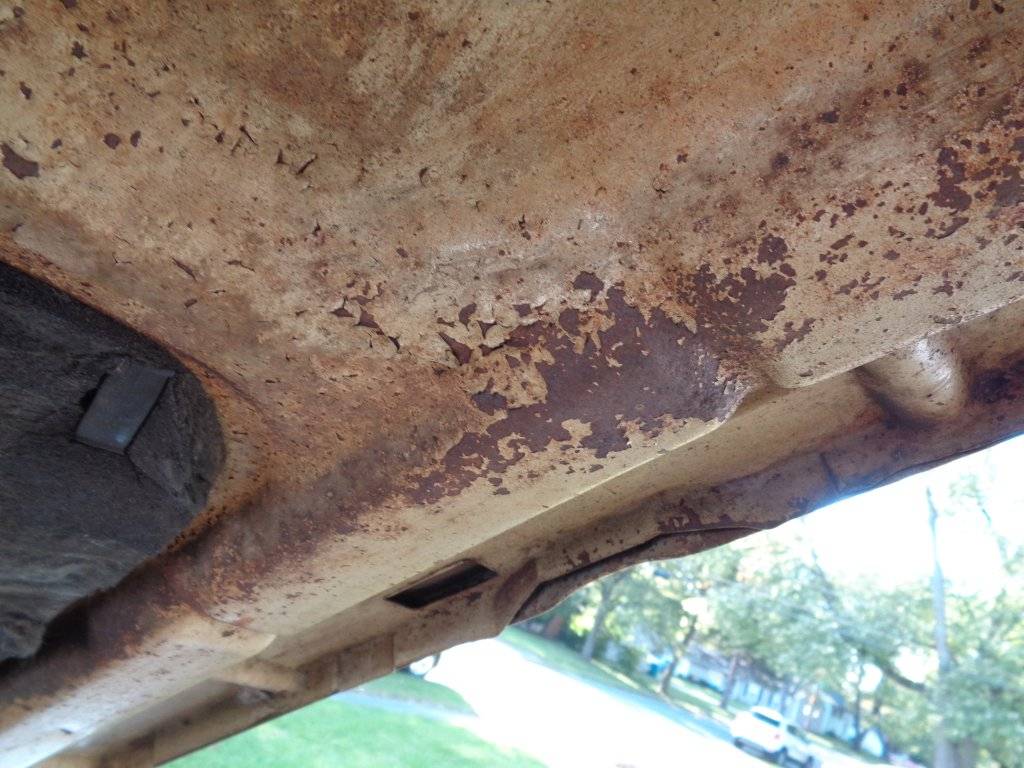

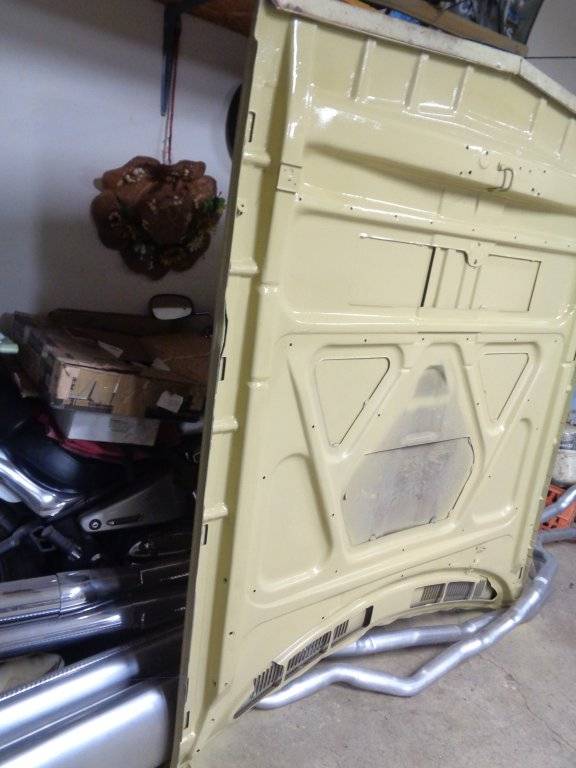

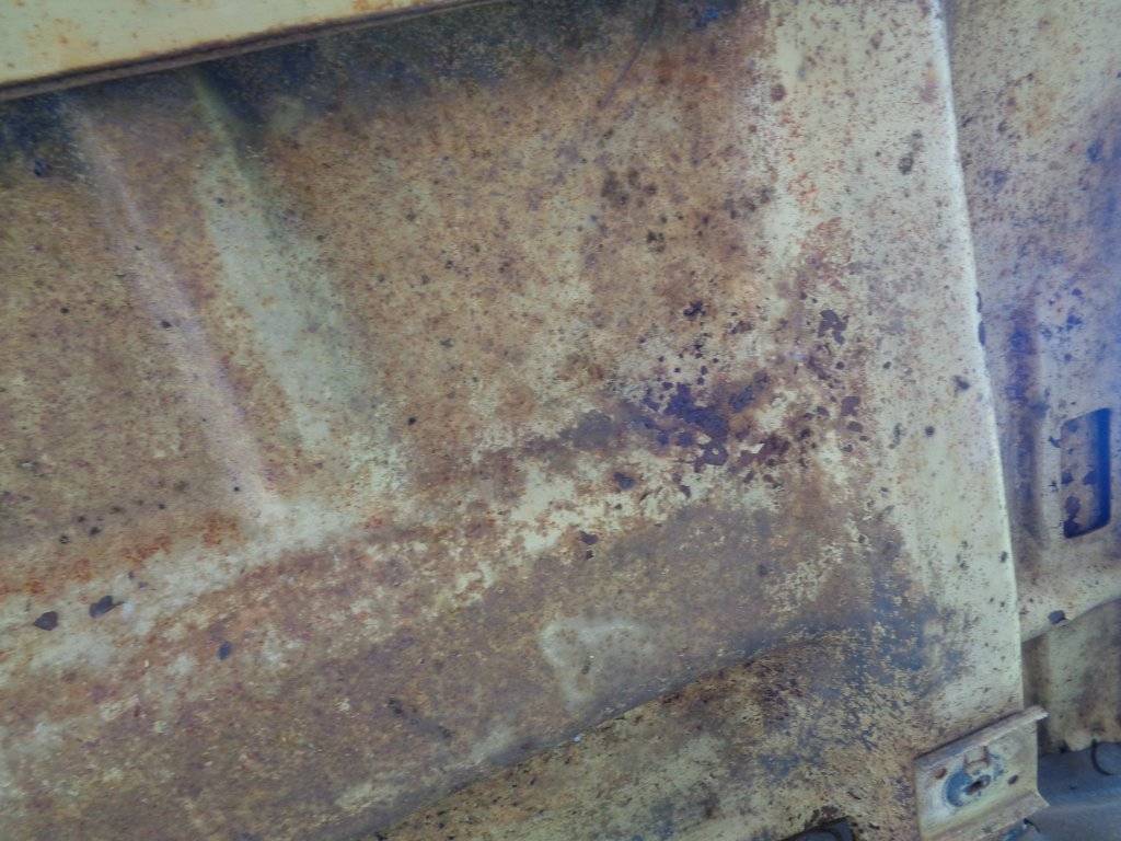

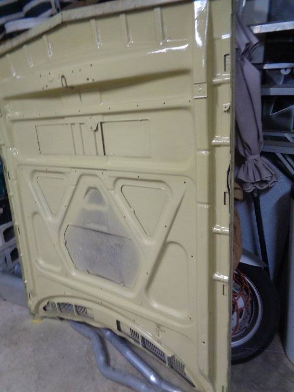

One of the tasks that Michel want done was to clean and repaint the exposed metal surfaces of the underneath side of the hood. As you can see in the photos below a lot of the hood frame the paint was chipped away or missing. Update I can't upload camera photos taken from my phone. Whats up @Joeychgo, never had this happen before.

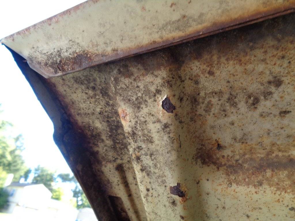

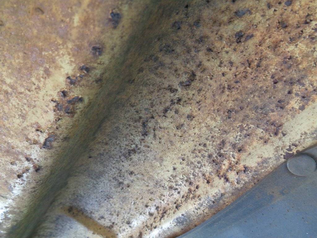

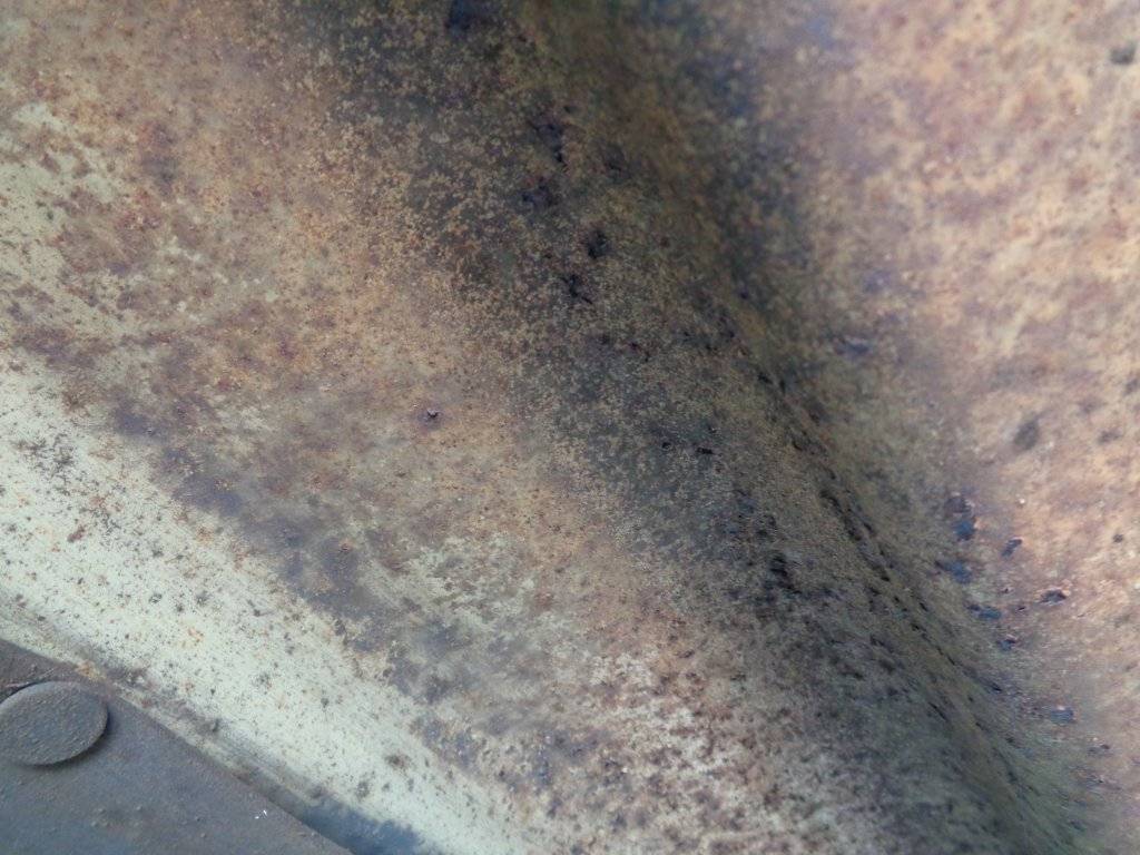

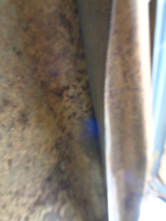

Here are the last of the before photos. If you look closely, you can see rust pits in the metal surface which had to be sanded out. some heavy pitting areas remained after multiple attempts sanding priming.
Wow, I can tell that was a lot of work to get that underside just to the point of paint ready. Unless you had it blasted?
My thoughts on blasting were getting rid of all the media afterwords. Also possible contamination during the paint process = complete disaster.
