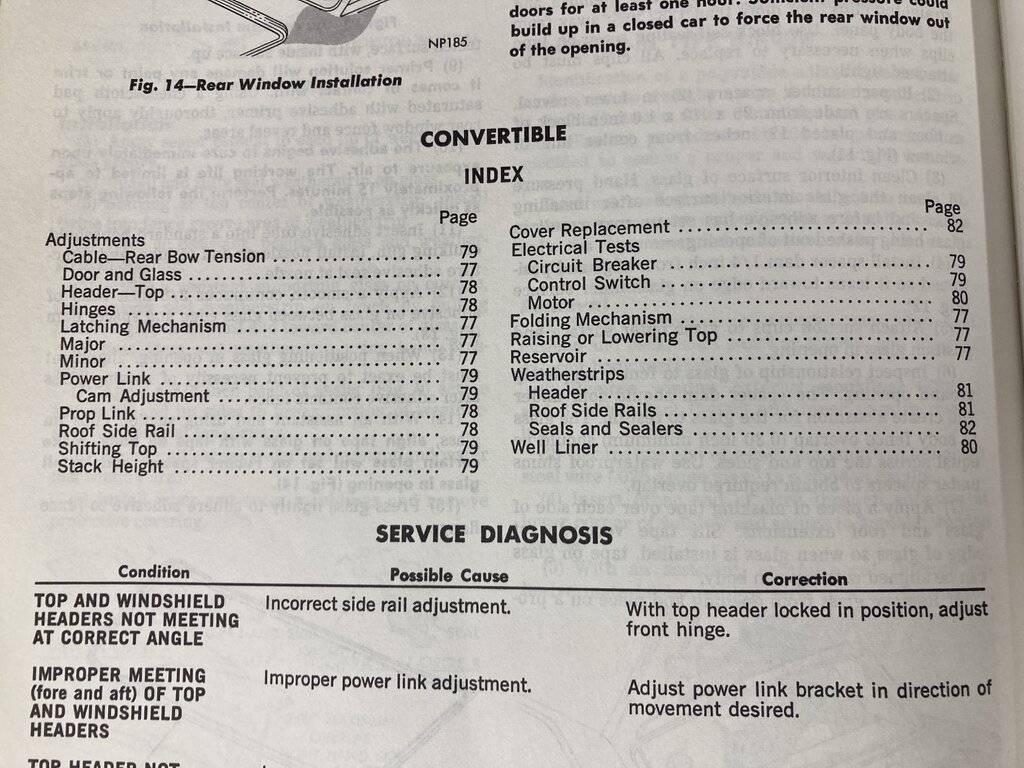

Service manual should be helpful but I’m not sure that there’s enough there for someone who’s never done it before to be able to use it as a step by step guide. This is from the ‘67 FSM.

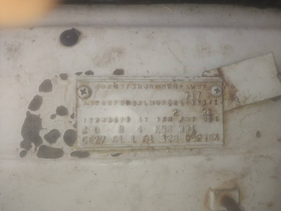

But fender tag pic would be very helpful!!
With the "Made for Export" tags, would the 383 2bbl have been specific to export and also have a lower compression ratio, as a result? With a different VIN engine code or markings on the block, too?
Just looked in the '68 Chrylser parts book. There is a 383 2bbl "L.C., Export" piston listed, but found no VIN engine code for such. Further mystery . . . LH HP manifold for the 383 4bbl and 440HP also fit the LH of the 383 2bbl 3-spd manual trans cars, according to the same '68 Chrylser parts book. FWIW

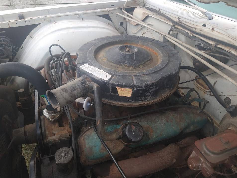

Incredible car but can someone please tell me what's wrong with the battery or circuit leads?![]()

Definitely would not have caught that. Nice car stillOK, if you look carefully at the starter relay, you will see that its a MANUAL starter relay, lacking the neutral safety switch connection. The NSS itself must be disabled, as the car runs along, goes into gear et al despite the NSS lead dangling in aether nnear the relay. This I shall remedy ASAP. I strongly suspect the trucker who flipped her to me to be the culprit here, as in the case of that Carter F & F* (Finagled & Fukt) carb that came with her. God be thanked my Stromberg still works very well! The tiny leak I imagined last month turned out to be the fuel line.
I'll take a closer pic of the relay if you want to look....
FWIW not all export cars actually got exported, some might have been diverted to fill a customer order. i know of a barracuda that had export tags but never left the states. the then owners bought it new from a dealership
