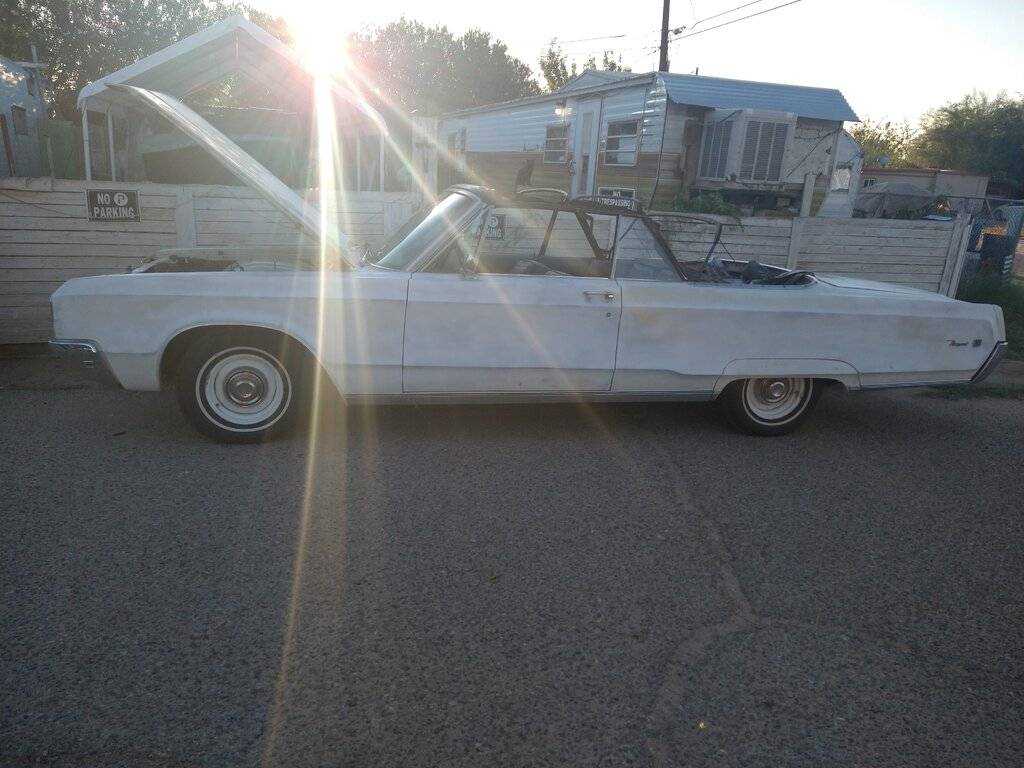

View attachment 487301Gertrude, drivers side profile-in front of Mansionem Mauritius. This car has ALL her original major parts, excepting the vinyl top. The new one is boxed up in the trunk. This weekend, Deo volente, we WILL get her covered properly. The motor drives the frame up and down just right! Nice to have such in working order. Courtesy lights in back seat all work too, as do the door pin switches!! Such makes prepping her for full Family Duty easier.

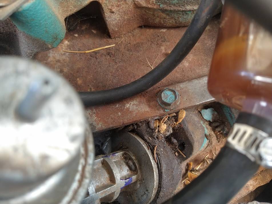

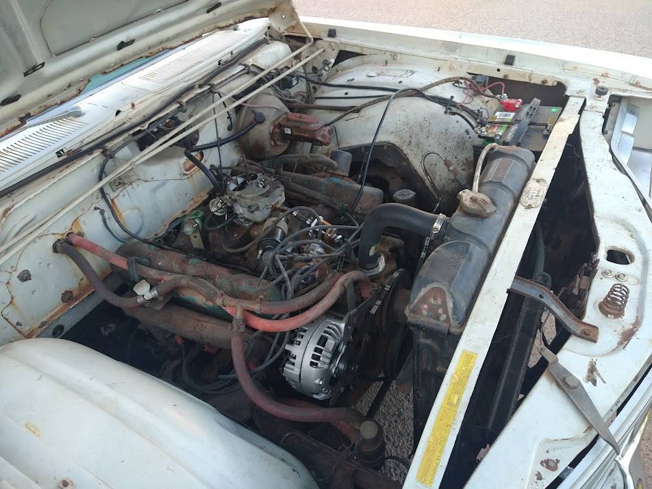

View attachment 487302Yonder carburetor came within a few nanometers of DEALBREAKING, despite prior warning about it. I remain AMAZED the old fool who sold me this thing didn't have the sense to TRY A DIFFERENT CARB, but also am VERY GRATEFUL he didn't! For had he done so, he would have SAS* KEPT this car. He admitted to me he still wanted it somewhat. Well, he got to wipe our meager savings out and take it home to his Desert Cactus Paradise near Mexico.

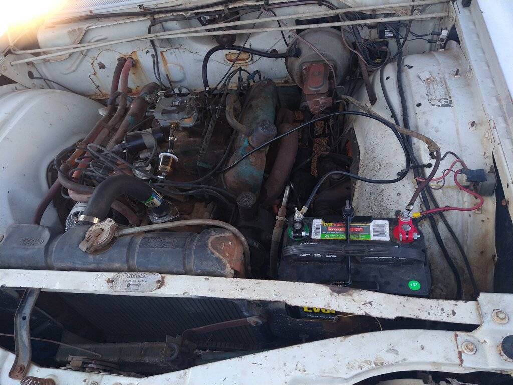

The battery got a nicely refurbished, primered pan(from Mathilda) , new marine terminals and a brand new OEM battery bracket. Any of you see something WRONG in this pic? Look CLOSE at stuff.... NOW do you see anything WRONG with that battery or circuit leads?

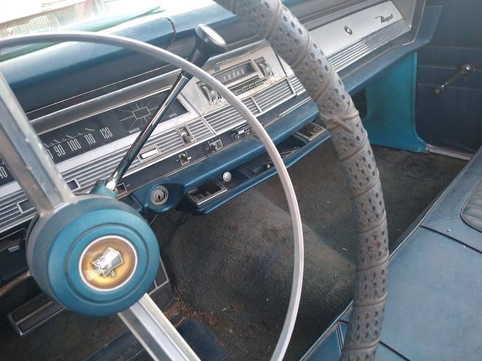

The passenger compartment functions quite well, despite severe deterioration of the rear seat. Excepting the fuel gauge, very instrument in the instrument cluster works! I guess I'll leave the shitty old ammeter be for now, given that, though I WILL install my vital stats gauges as I had with old Tilly, as I hate relying on idiot lights to tell me that I just slagged my motor. Better to have QUANTITIES with which to assess Quality!
Even the lighter is original! Could Gertrude be a ...... Survivor?

The thing that jumped out at me was the dark color of the fuel in that filter... you may want to drop/clean the tank before allowing a chance for the working carburetor to become fouled by whatever slips through the filter. I'd replace the rubber fuel hose with something ethanol rated at the same time JIC.

The crap may well already have infiltrated that Stromberg I fear, though it was already showing symptoms of some moonshine related deterioration. I failed the Emissions test by an order of magnitude yestermorn, which surprised nobody there, as the thing had been a true "barn find" with rat-**** on the intake manifold and stuck around the distributor to prove it.

DAMN ALL FLIPPERS! Discovered the CHEAP REMAN alternator was a SQUAREBACK, with the 5/16" retainer bolt threads at the bottom STRIPPED. thus assuring poor charging. So I cannibalized another Mathilda component, the shitty Duralast 60A alt, which at least IS a roundback, and works.

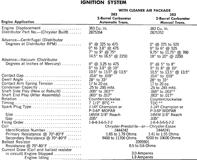

Happy tidings! Today I tuned Gertrude past the Emissions test, with "Flying colors" as the saying goes. To achieve this, I installed the distributor built for Mathilda by the redoubtable Halifaxhops, re-gapped it to peg the dwell on 30 degrees, then after reading the 1968 Plymouth FSM for the Fury, dialed back the timing from the 12.5 degrees BTC I WRONGLY ASSUMED to be valid for a 1968 383 to ~9 degrees. The 68 FSM actually specifies 7.5 degrees BTC for motors with the CAP, though I removed the broken distributor vacuum control valve, as all it contributed to the system was a whistling leak. Still, by retarding the timing a bit, I kept a good smooth idle, yet got some acceleration without backfiring. I hope to further retard timing to spec, once I get a carb that will support it.

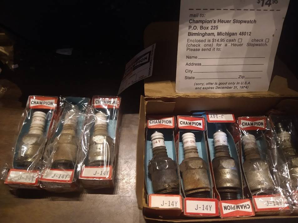

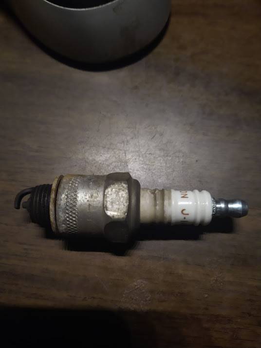

Finally, I replaced some VERY OLD sparkplugs! The flipper told me that this car had sat for 11-12 years. I now believe that to be about HALF the actual time this barn find sat! The spark plugs turned out to be old school Champion J-14Y plugs!!! Wish I could find reliable data on WHEN they went from the J-14Y to the modern J-14YC! THAT would help me ascertain WHEN the car had last been driven.
It just so happened, I had a NOS box of 10 of these, dated 1974, which furnished 9 shiny, clean replacements for the RUSTED BUT OTHERWISE IMMACULATELY CLEAN old plugs which were in the engine! This car indeed had been WELL KEPT, while it was driven anyway....
No pitting, very little fouling. Others had NONE! Still haven't used or leaked a drop of motor oil. Yes, we're blessed here.
