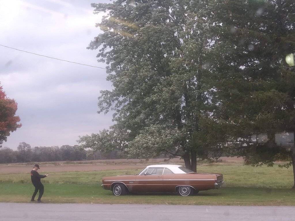

Meet Maggie May!
A few shots before put in the garage...
