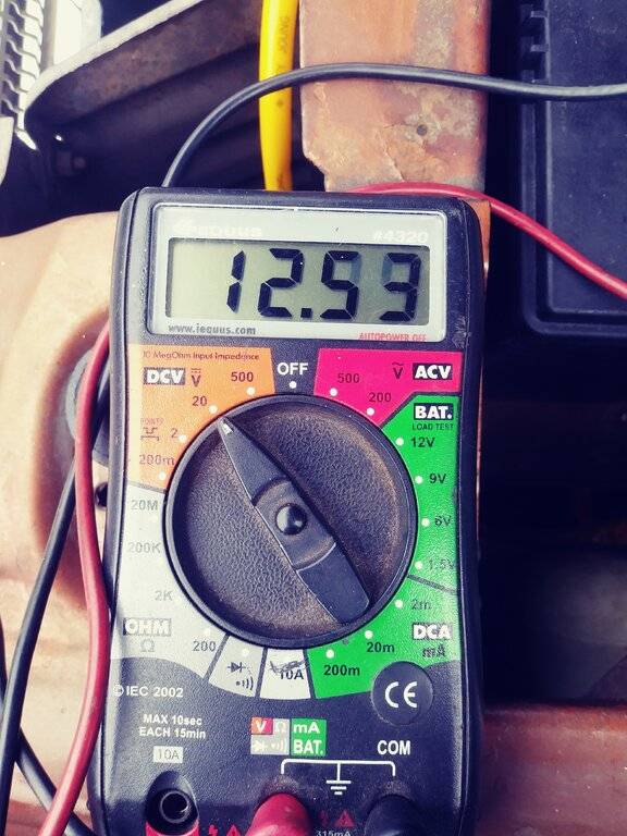

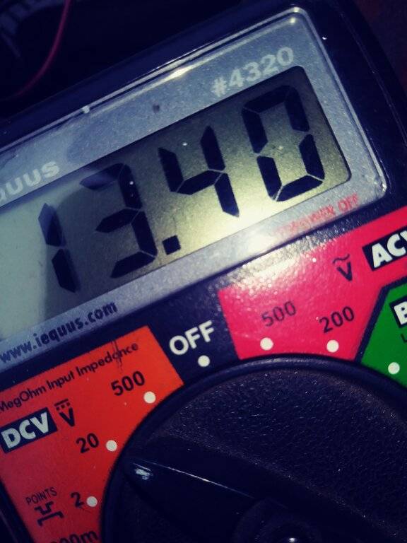

My multimeter showed no charging at idle but rev it up it goes to 13.35 volts.

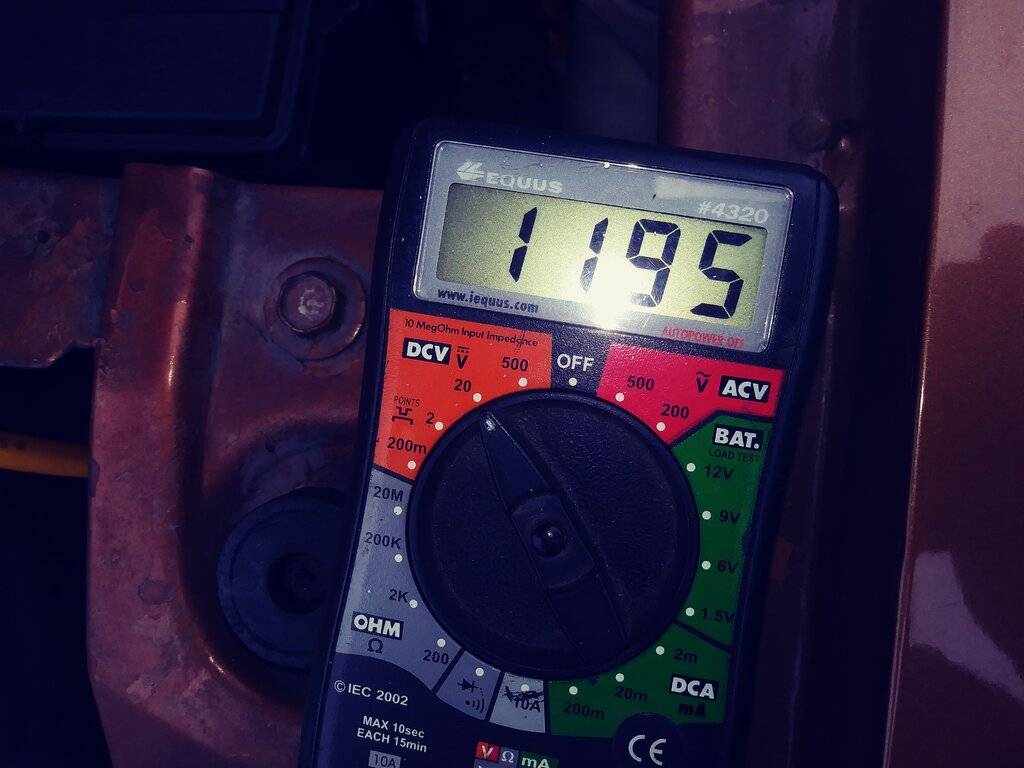

Turn on rear defog,front defros,and headlights,drops below 12 volts.
Concerning since the Pertronix needs 12 volts to run the engine.
