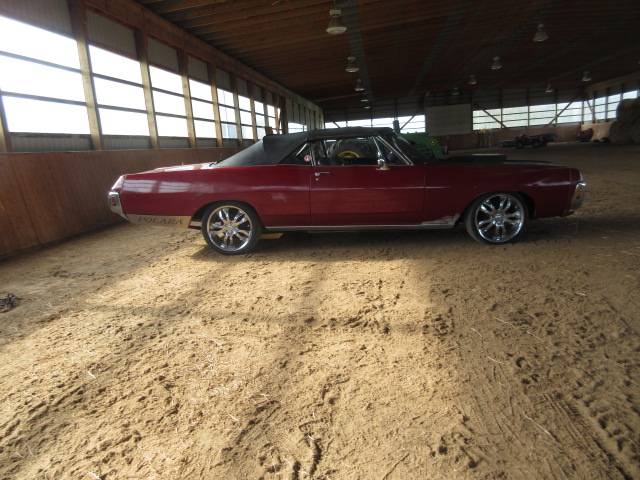

Meet Regina FQ3, a 1970 Polara convertible who turns 51 today
Well Ellie May is a DL27G0D127970 built at the Belvedere plant, as mentioned the last owner was a butcher and did a lot of teenage stuff to it, monster stereo, led under carriage lights, went as far as changing the the rad overflow and wiper fluid reservoirs with 40 oz. bottles of Jack Daniels??? He has slapped in a couple of Monte Carlo bucket seats and just reoriented the bolts into the floor with no anchoring what so ever and to boot the floors are rusted right out.
I have so many things lined up for her to pass the safety, roof is shot, intake manifold needs a new gasket ,floors, dash to be redone, new carpet, I could go on and on.

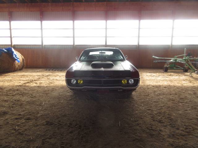

I know I’ve seen this car make its rounds. Especially the hood
I luckily found another hood with no cheese on it at all, I plan on alternating hoods from time to time, Ellie May will be wearing different tops from time to time.
Last owner had the car for 8 years parked in a temp shelter, he says he put the scoop on himself after a tree fell on the car. Not sure to believe him or not.
If you’re ever out in Maryland….I’ll take the hideous horrible ugly no good hood off your hands haha

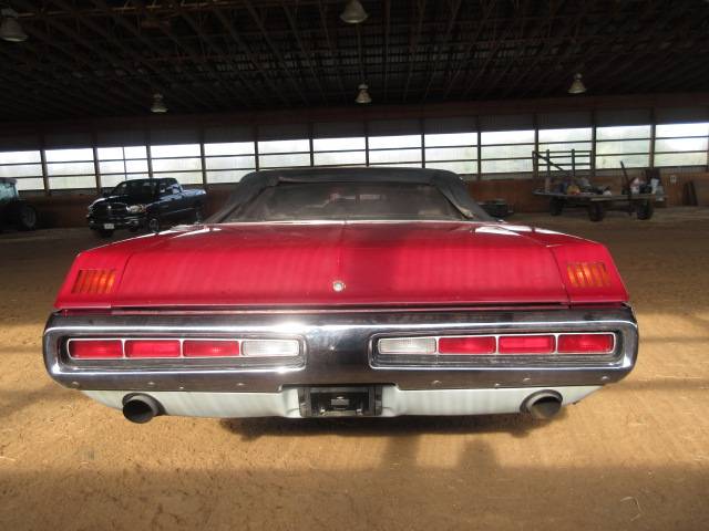

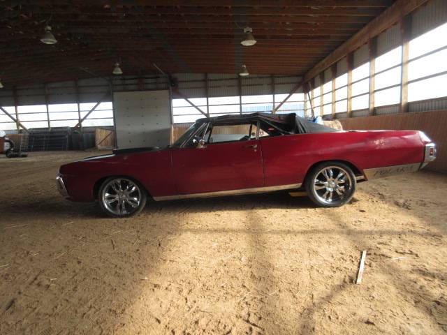

For records, here are the photos from the ad in Iowa.

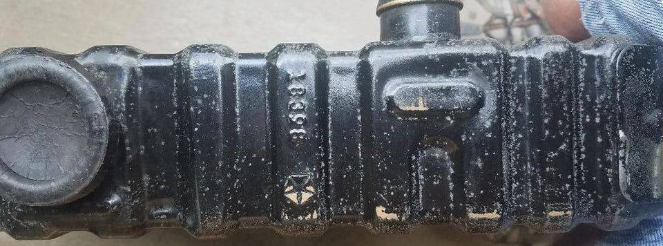

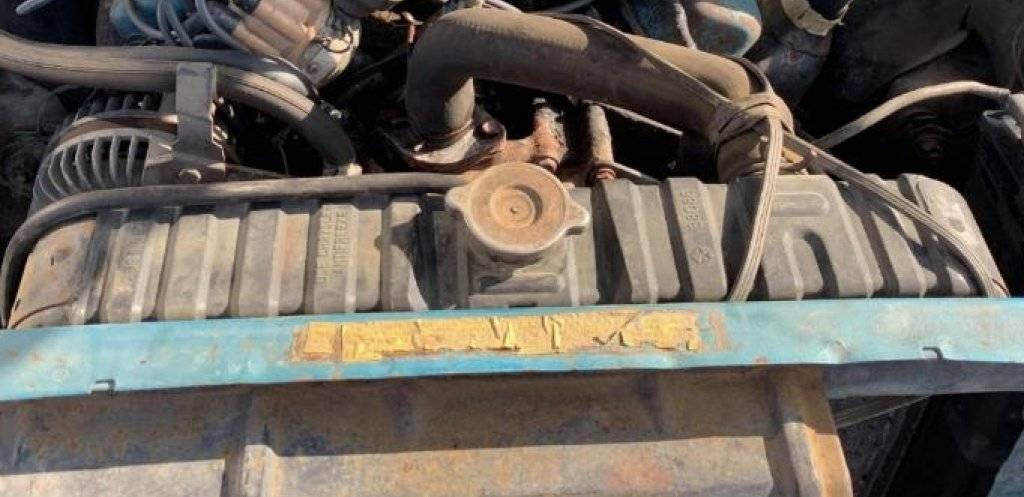

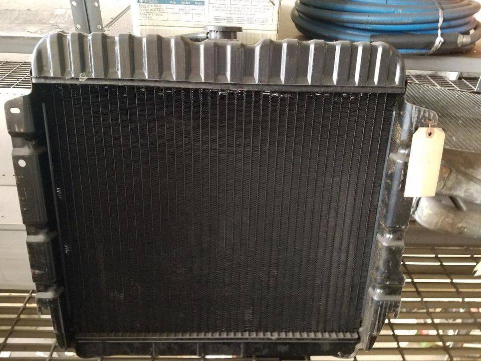

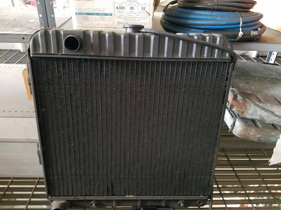

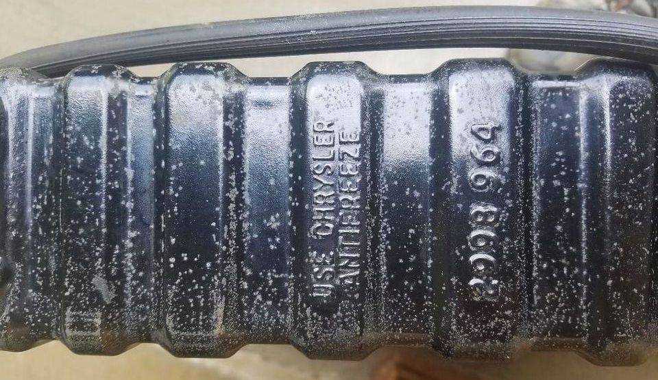

Good news continue to come in for Regina: the 22-inch (P/N 2998 964) radiator has been delivered, and @71Polara383 tells me that it is very, very nice. Thanks again to @marty mopar and @Rustyrodknocker for helping me get this NOS item!

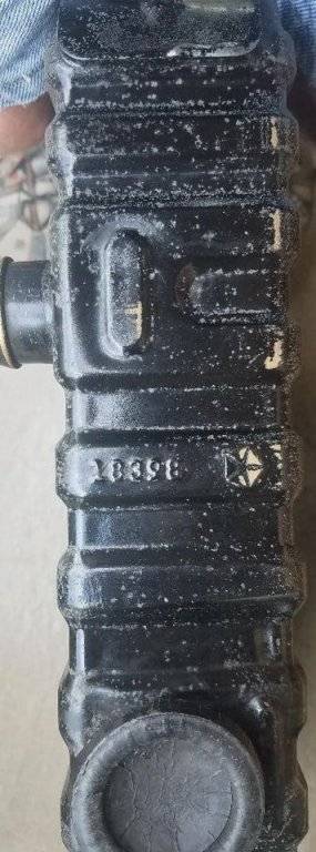

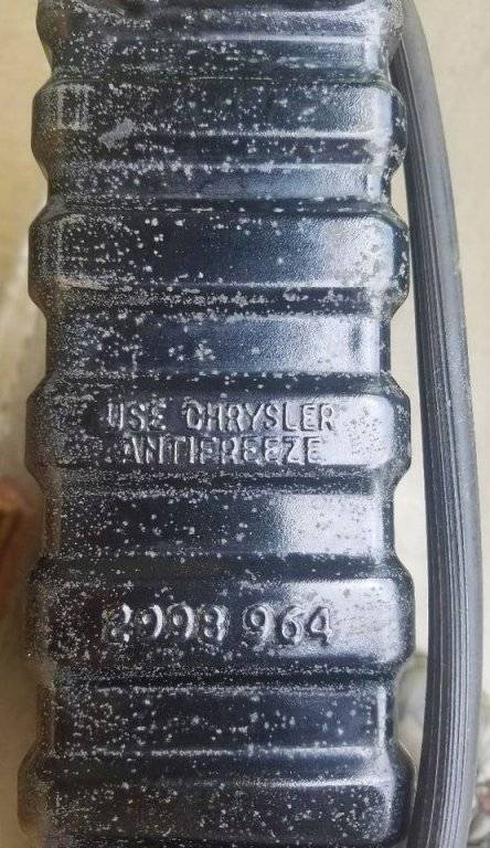

It is worth noting that the radiator that I bought is not the exact same as the one that was on Regina. MyMopar.com 's table with 1962-1974 radiator specifications (now sadly unavailable, but luckily I got the info when it was still up) lists two radiators for 1970 C-bodies with heater only: 2998963 and 2998964. The latter is what I bought. I do not have a high-resolution photo of the original, but the differences in the stamped 5-digit nbr (driver-side) and in the placement of the numbered stampings (passenger-side) are clear in the photos below:
1. Regina's original radiator:
2. driver side of the one I bought (top view), the stamping location is the same though the numbers are different):
3. passenger side (note where the "use Chrysler antifreeze" instruction is located relative to the 2998 964 stamping -- both differ from the original):

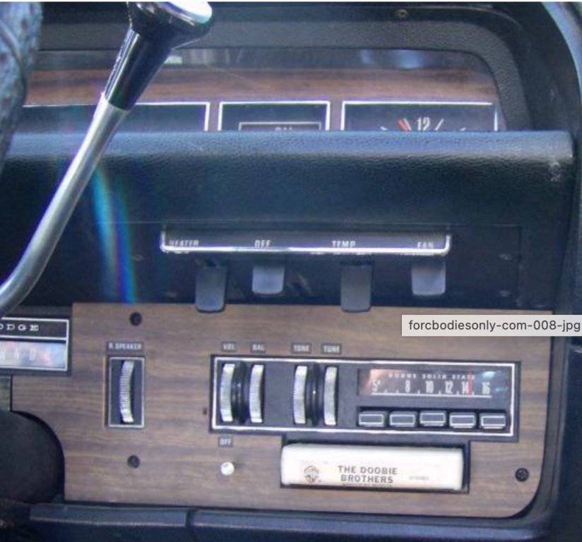

Radio and speakers. The time to refurb the R22 AM/8-track radio and the dash speakers is when Wyatt replaces the pad. Regina does not have the R31 optional rear speaker, so that is not an issue. For both the radio refurb and the three new dash speakers, I plan to follow advice received in this thread and go with S/M Electro Tech:
[/URL]
meanwhile, I thought that I should illustrate, for the record, the difference between 3- and 4-speaker controls with the R22 option on the 1970 Polara:
1. Polara AM/8-track R22 radio & R31 rear speaker:
1970 Polara AM:8-track R22 radio & R31 rear speaker.jpg
2. AM/8-track R22 radio, no rear speaker (Regina), note the missing "R Speaker" thumbwheel to the left of the radio (it would have been between the two screws holding the "wood" panel):
AM:8-track R22 radio, no rear speaker (Regina).png

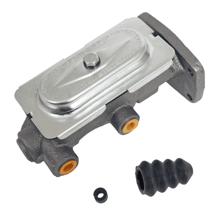

Back in March of last year, @71Polara383 replaced Regina's booster and master cylinder with those from DH23L0D301864 (a 1970 Monaco that he and I parted the year before). That poor Monaco left the factory equipped with disc brakes, but a previous owner at some point installed incorrect-for-that-car-but-fine-for-Regina replacement drum brake booster and master cylinder -- so we repurposed them for the time being.
Of course, the plan had always been to restore the originals.
Master: In a separate thread that I started last year on 1969 to 1971 P/D/C master cylinders, though, posts by @Davea Lux @CBODY67 @PH27L7 @1970cat @Furyman together have led me to believe that the leaky master on Regina when I bought her (in early fall 2020) was likely an aftermarket unit (even though it had surface pitting like an original). I have therefore followed the advice of @Davea Lux to replace the MC rather than rebuild it; since @traintech55 likes the bail wire type better than the typical single-screw replacement unit, I looked far and wide to find one. Turns out that the Raybestos MC36221 sold on Amazon through Raybestos' factory store has the correct look, so I ordered it. Here is the photo from the Amazon listing:
Booster: Regina's booster seems to be original, and so it will go this weekend to the Power Brake Booster Exchange in Lynnwood, WA. To paraphrase @Trace 300 Hurst I have, like him, found in prior dealings with the company that Booster Dewey, Booster Steve, and their staff are competent, do quality work, and underpromise/overdeliver. What's not to like? I am asking them to replate the booster using "gold zinc" as that is the finish I see on all the original 1970 Polaras that I have found with B51 power drum brakes on FCBO.
The Raybestos MC36221 booster that I bought was made in China, and looks like the generic replacement booster that we have seen on many cars -- here is a photo from the Summit site. I guess I can't win every time...

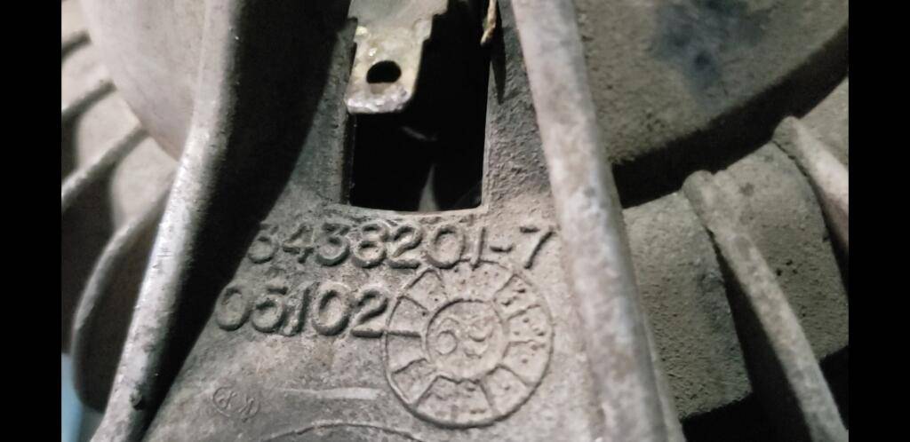

Today, @71Polara383 sent Regina's alternator out for rebuilding. He found a Midwest rebuilder he likes (Forest City Auto Electric in Rockford, IL).
Hopefully, after we get it back, the difficulty in raising/lowering the top that started after I returned from the Midwest C-Body show last year will be a memory from the past.
Meanwhile, here is a photo of the alternator -- P/N 3428201 and date stamps are consistent with the build date :)
When the alternator comes back, we will also be replacing the voltage regulator as a precaution.

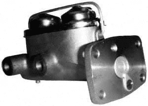

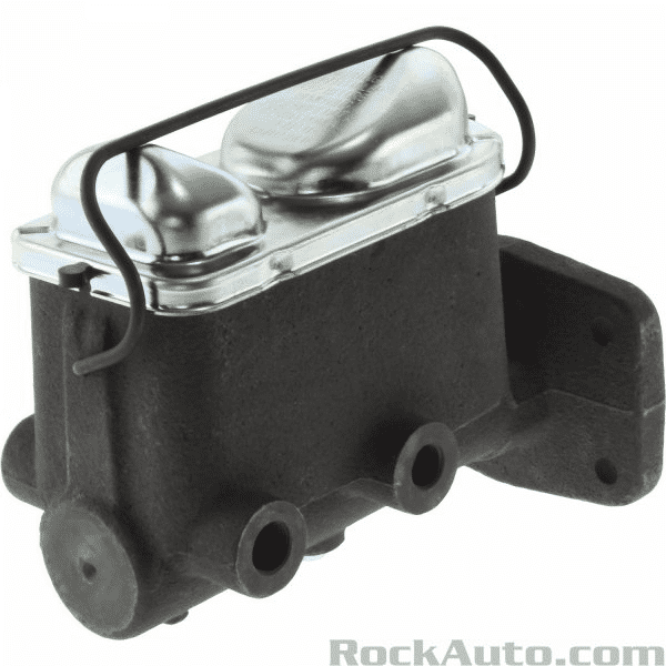

The replacement you received is a master cylinder used on drum brake cars only and should not be used on a vehicle with disc brakes because the volume of brake fluid that master cylinder holds is insufficient for a disc brake car.
Here is a view of a correct one that I would buy from Rock Auto:
More Information for CENTRIC 13063055
I have learned to trust the Centric brand for quality, correctly listed parts.
I really do not trust Raybestos listings anymore from my experience in terms of what I actually receive vs. what I expect.
The replacement you received is a master cylinder used on drum brake cars only and should not be used on a vehicle with disc brakes because the volume of brake fluid that master cylinder holds is insufficient for a disc brake car (...) I really do not trust Raybestos listings anymore from my experience in terms of what I actually receive vs. what I expect.
Thank you -- but Regina has the B51 power drum brakes, not the B41 power disc brakes. So it is a drum brake that I needed, and that is what I ordered.
I have been happy with the Raybestos brake pads and the disc brake MC that I bought three years ago. But my experience is a single data point, what has yours been?
