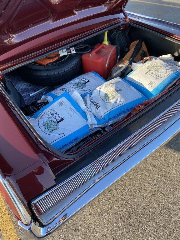

Who needs air bags to change the attitude? Just a few bags of dirt and mulch will change the ride height, smooth out the bumps and yes, make it into a tail dragger. I could likely benefit from new springs, but not too bad when empty.
Probably close to 400-500 Lbs in the trunk plus full tank of gas.
View attachment 461245 View attachment 461246
Empty, except for about 50 Lbs of tools.

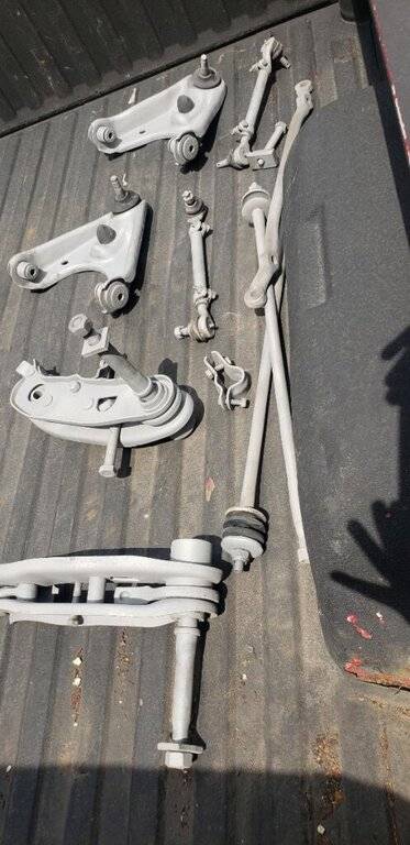

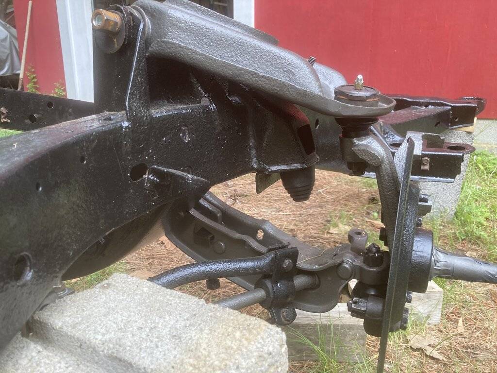

@71Polara383 has blasted Regina's control arms, strut rods, centerlink, tie rod adjustment sleeves, and sway bar hardware. Here is a photo he shared along the way:
We have replaced the control arm bushings (4 Moog K7006 from Rock Auto for the upper CA; 2 Moog K7007 sourced through Pep Boys, of all places, for the lower CA -- the 7s are very hard to find, thanks go to Wyatt for pointing me in the right direction), the bump stops for the lower (Moog K7293) and upper control arm (Dorman 31052 *), and the upper (two Moog K772) and lower ball joints (initially I had planned on installing 1 Precision Suspension Technology BJ10220 passenger and 1 PST BJ10221 driver -- but Moog K7003 / K7005 from @mobileparts came in just in time and so that is what went on the car; Snow White, Regina's N-code sister, will get the PST parts).
Today or tomorrow, Wyatt will install new tie rod ends (Moog ES352R outer and ES355RL inner), idler arm (Moog K7014), and pitman arm (PST PIT18757 **). New KYB KG4507 front shocks have already been installed, the rears KYB KG5512 will be going on in the next few days after the front end is done. (Note: the torsion bar boots could not be replaced, due to lack-of-space to remove the bar).

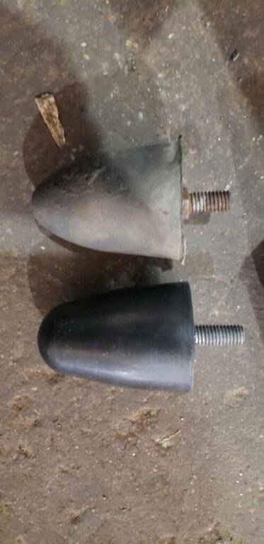

*: FWIW, the only replacement UCA bumpers I could find were the Dorman. The good news is that they are an exact replica (see photo below -- the perspective gives the impression that they are different, but they are not). One remaining question mark for me is whether they'll last for the rest of the car's life -- I don't know, as this is the first time I have bought a Dorman product. In any event, the upper bump stops should only be of use in extreme cases, and I don't plan on taking the car airborne...
**: PST offers a discount to FCBO members, but only on orders above $200. I placed my $350+ total in two separate orders, however, and was told after I requested the discount that they did not qualify :wideyed:

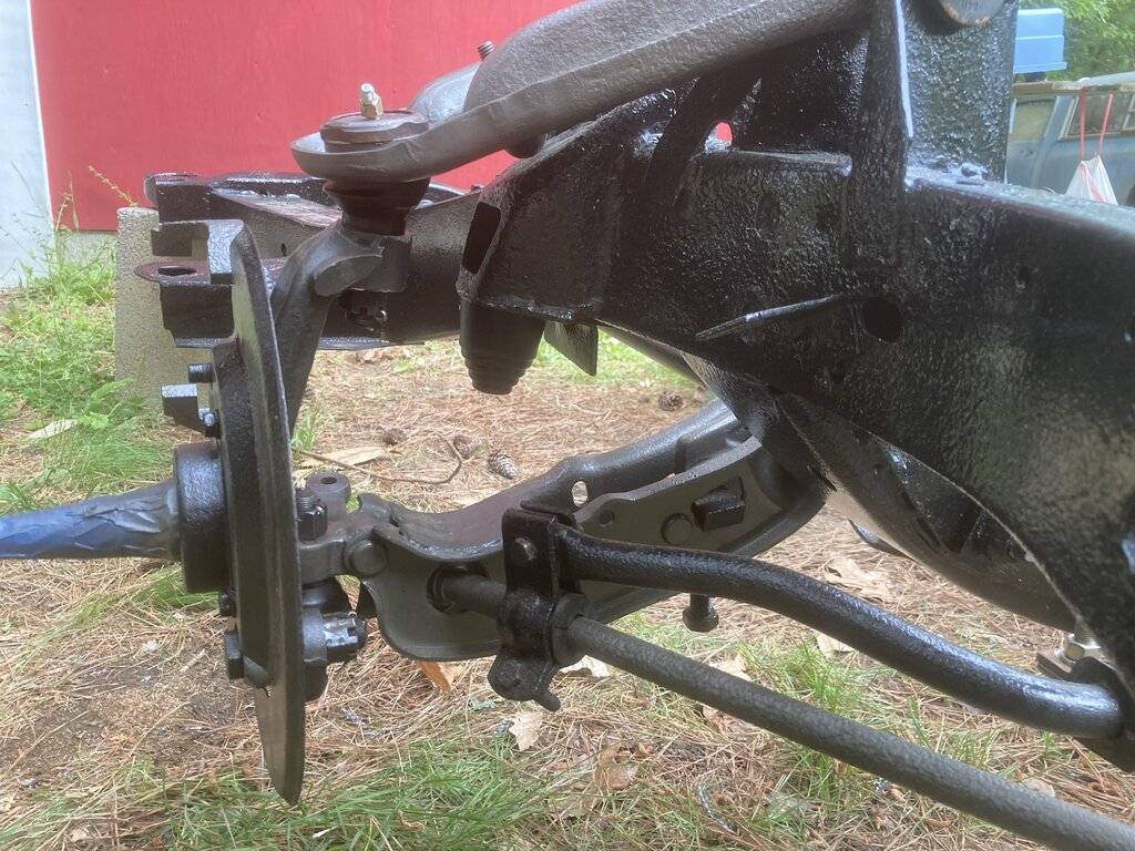

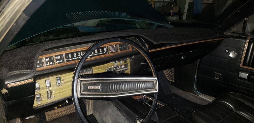

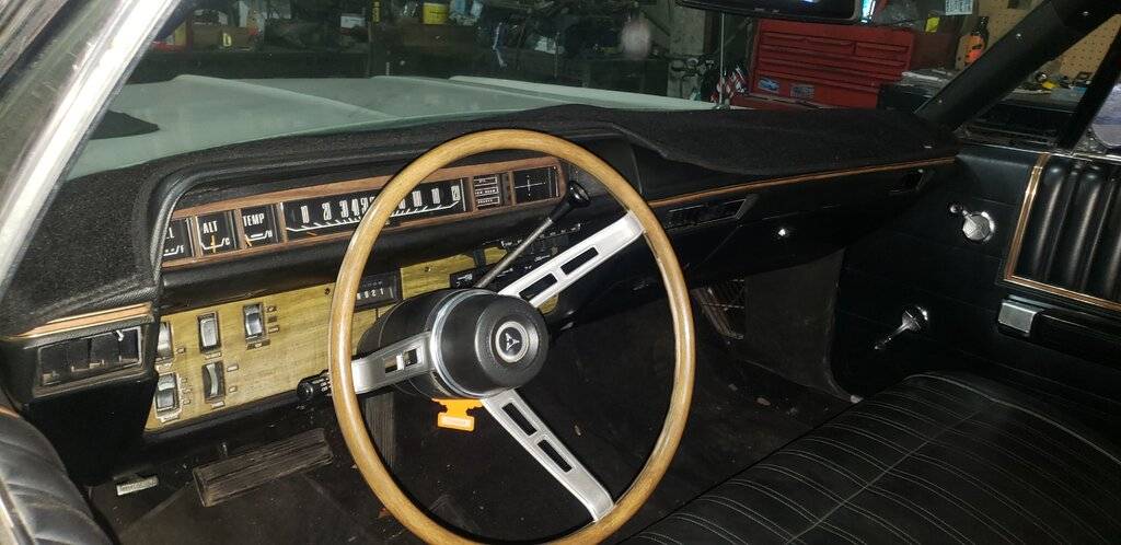

Here's the pic he send me, taken last night. I think his description is correct -- sorta fits. I'll follow up with the company and let them know that the fit could be tighter.
PS: Could it be that the dash pad would work better on a later-model hood? (Edit: the cutoff is in early January 1970 if memory serves) I need to try on Snow White.
PS: Could it be that the dash pad would work better on a later-model hood? I need to try on Snow White.
I think you are right. That's a after December dash pad cover, good eye.

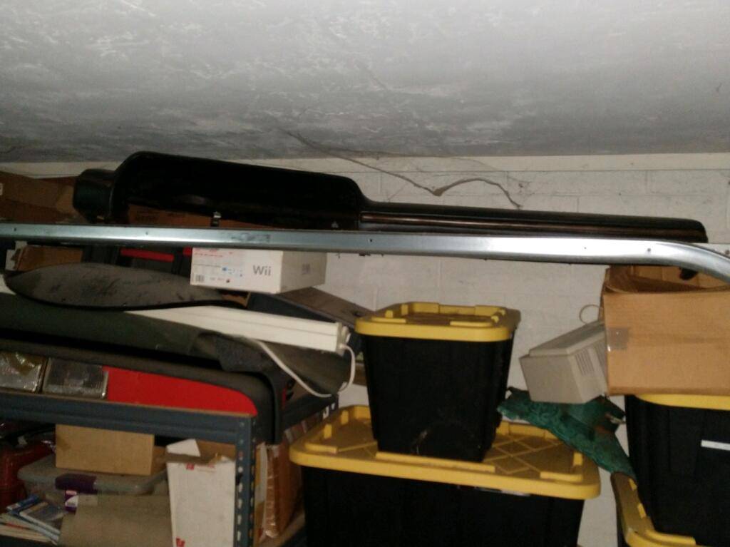

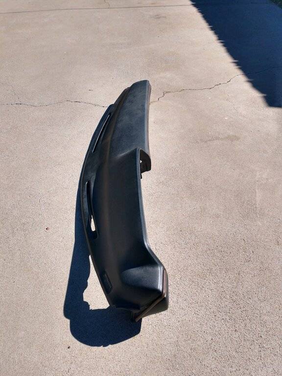

Well, thanks to @71Polara383 , the lead morphed into a purchase -- a full month later than I thought it would, but it's winter and we are are in no rush.

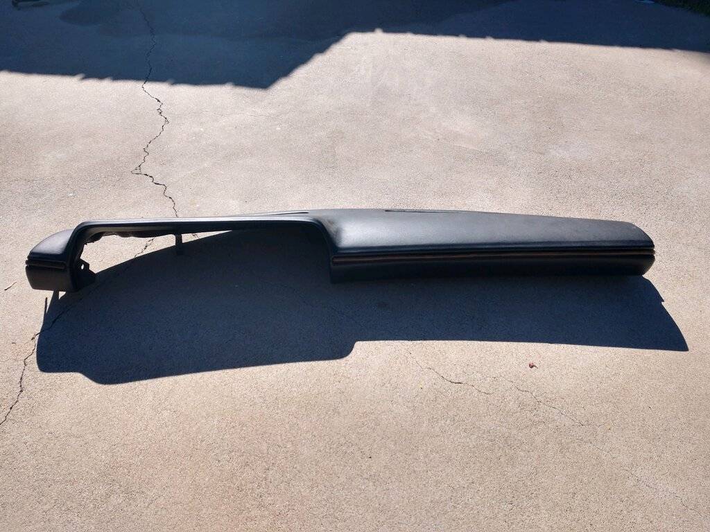

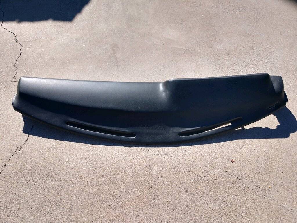

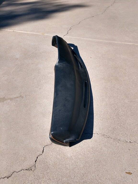

The non-A/C dash that I just bought comes from a 1971 DK41 (police sedan) that was going to be restored but has since disappeared. The dash was redone by Just Dashes as part of the car's restoration many years ago, and it was put on a shelf by the owner. Since the full project will never materialize, he and I made a deal: including shipping and taxes, I am at less than 40% of the current JD cost. Fingers crossed that the pad is as nice as I hope it is -- a few pics below as an appetizer (pardon the dust):

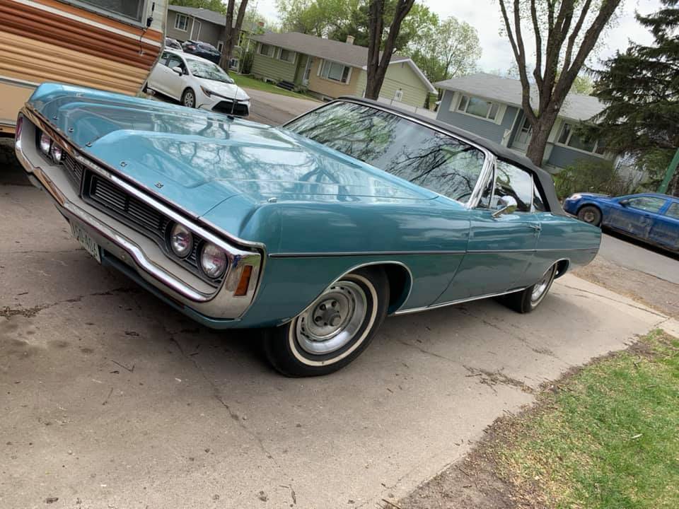

I acquired DL27L0D148841 from @Tobias74 earlier this month. This Polara convertible's scheduled build date was 51 years ago to the day: October 31, 1969. The color is my favorite, and I had yet to own a fusie C-body with a console, so I took the plunge and thus deviated (some more...) from my long-term goal of keeping ´only’ four fusies.
Tobias himself had scored this ragtop in August from a seller in Regina, SK. That person apparently had gotten it from the original owner, who is now very old. Here she is when she was being advertised in Saskatchewan this past summer.
We learned in this post that the car was bought by the first owner for his wife. Tobias also told me that the 'vert was used in local harvest parades. The car must have been used for some other things as well, because the first time I put her up on a lift, I found evidence suggesting that an aftermarket hitch was at one point welded on but later was removed (see the photo below). Tobias has promised to help me get in touch with the first owner, and I look forward to hearing first-hand about the car's history.
DL27L0D148841 is one of only two known surviving FQ3 turquoise Polara convertibles (hence her name). The other also has a 383-2, black bucket seats, power windows, and a black top but DL27L0D110005 (i) was in very rough shape the last time we heard of her -- back in 2016 -- and (ii) has a buddy seat rather than a console.
Thanks to research by @Bill Watson and @kmccabe56, and posts by @Fratzog, we know that just 25 FQ3 Polara 'vert were produced for the US market in model year 1970. Although I have been unable to find out how many FQ3 'verts were among the 144 manufactured for the Canadian market at the Belvidere, IL plant that year, their number was likely a single digit (assuming that color choices were similar for the Canadian and US markets). Bottom line, the likelihood to find another in this condition is pretty small -- hope springs eternal, but I am glad I got this one. Cherry on the cake: I like fender signal repeaters and she has the L31 option (Edit: I initially thought that the car was the only Canadian 'vert with the L31 option code, but 86/144 cars came with the option -- 85 of them by way of having the A01 Light Package).
Even if she was built on the day of Halloween 1969, Regina is neither a ghost nor a Frankenstein. She was repainted in the original metallic light turquoise. Tobias had told me that the paint job was professional one and indeed, while it is not flawless, it looks good -- among the few imperfections I found are a bit of "ghosting" on the hood (which I hope will buff out), three small bubbles and a hairline crack on the deck (Dutchman panel, driver side), a couple of bubbles on the RHS front (of which I was aware before buying the car) and rear fenders, and a couple of bubbles on the RHS rear fender extension. There is some overspray on the gas cap and on the springs, but that's easily fixed. Most importantly, the car appears to be very solid underneath. The only bondo that I could find when I put her on a lift is a bit of fiberglass on the left-hand lower rear quarter, just behind the wheel; the rest of the underside appears original and free of any structural rust.
