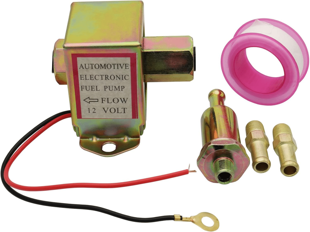

Anything like this will work.
EDIT: That link doesn't want to work. Look for a Facet cube pump with 5/16" in/out
There's many similar. I've read that the Facet brand is better quality, but I went the cheap route because first I'm cheap and second, I'm not relying on this to drive the car, just make it easier to start, so if it fails, the car can still be driven as usual.

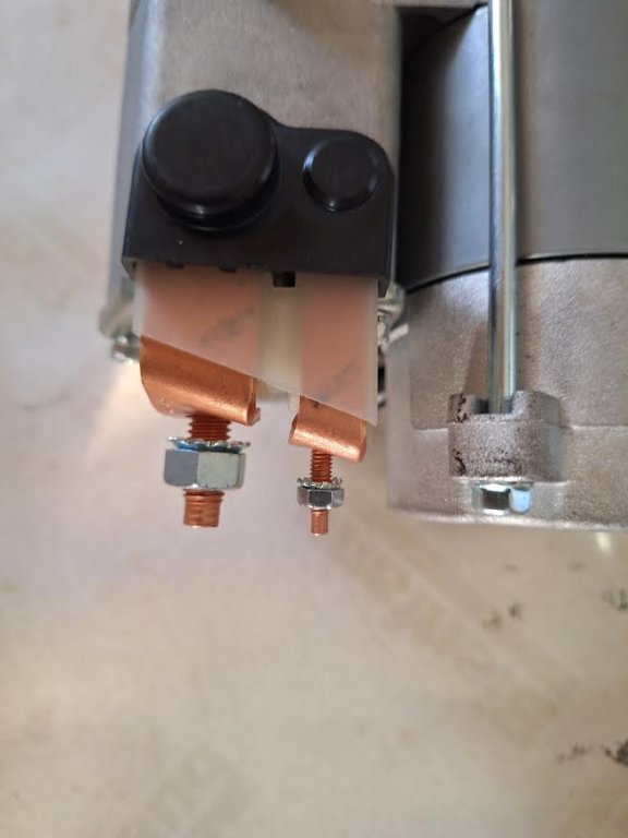

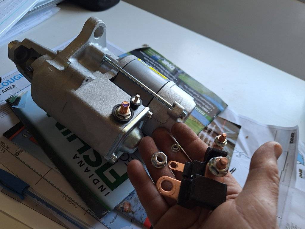

On the mini starter conversion kit: I removed the connector from the mini starter (see photo) and installed the mini starter without the conversion kit to see if one is actually needed. For peace of mind, I am ordering the conversion kit (I just ordered it now from the link posted above) because with it I know I can tighten everything down correctly. The mini starter might work as it is now, (see photos) if everything is tightened down correctly, but I can't guarantee that considering the very small space and working blind on the smaller terminal. The conversion kit will put my concerns to rest because access to those terminals will be much easier.

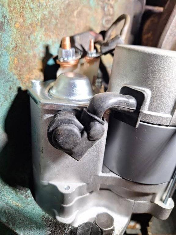

You shouldn't need the kit, you have a lot of room the way it is, but I won't argue that it may be easier to get to the terminals.
It looks roomy, but it's tight. If I were in a garage, a better work environment etc. I'd spend the time slowly tightening everything down etc., but the kit is less than 20 bucks and it will go fast once it's in. I'm working on this in my back yard under a tent from harbor freight. Not ideal, so I want to make things easy on me.
And it will be much easier to service under adverse conditions on the road away from home.

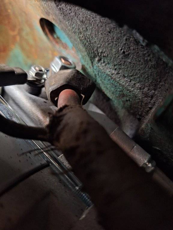

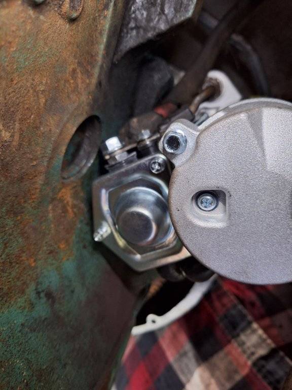

Done. I received the conversion kit (posted here in this thread) today and installed everything. So much easier this way. Super easy access. I did have to bend the threaded studs so they align with the main axis of the starter. If I left them as they were, the battery cable stud would be too close to the block and that is what I want to avoid. Anyway, copper is soft, problem solved. Tomorrow I'll try starting her up.
