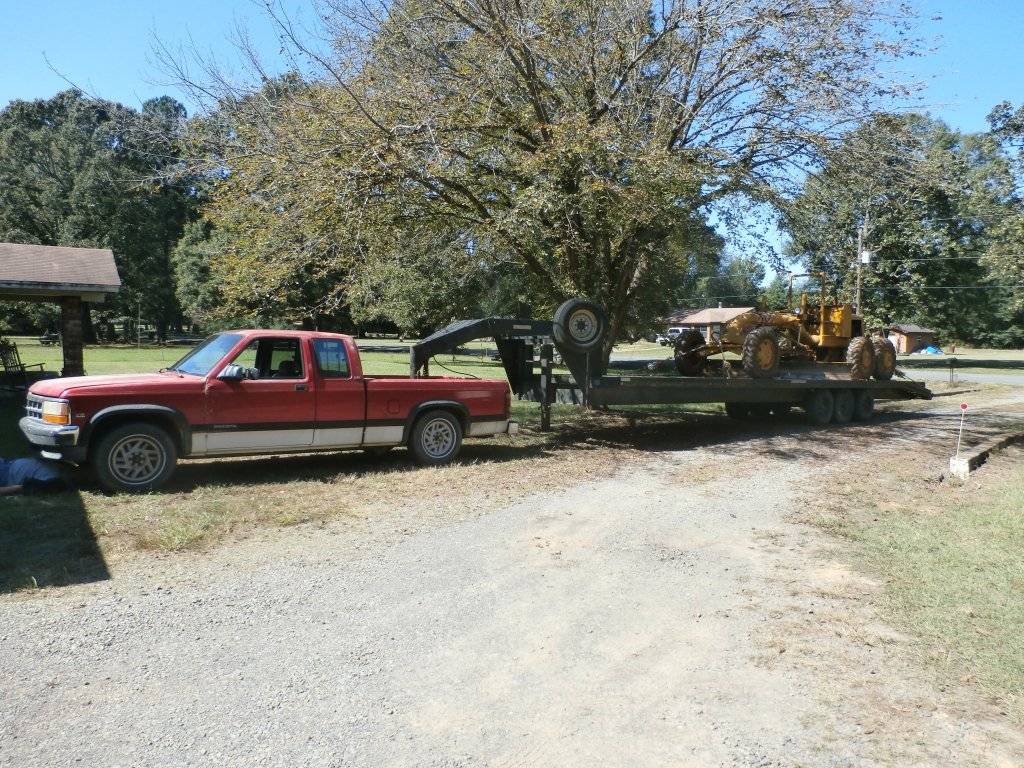

I don't know anything about the 46rh durability, except the one in this V/8 93 Dakota that I bought new in 93 with a 4.33 rear. It has 300k ----HARD--- miles on it.
The only trans maintenance has been to suck out and replace 6 quarts of synthetic ATF Plus 4 fluid every 10k, keep the factory trans cooler fins cleaned off. Trans pan has never been dropped.
What you see is typical of the way I have used it. 3600 rpm at 55 mph, o/d off, 235/75/15 tire.
Synthetic engine 10w30 every 2K. Rear synthetic 75w90 every 20k.
Love to have it in my 64 or 72 New Yorkers with a 3.91 gear.
Just saying.
