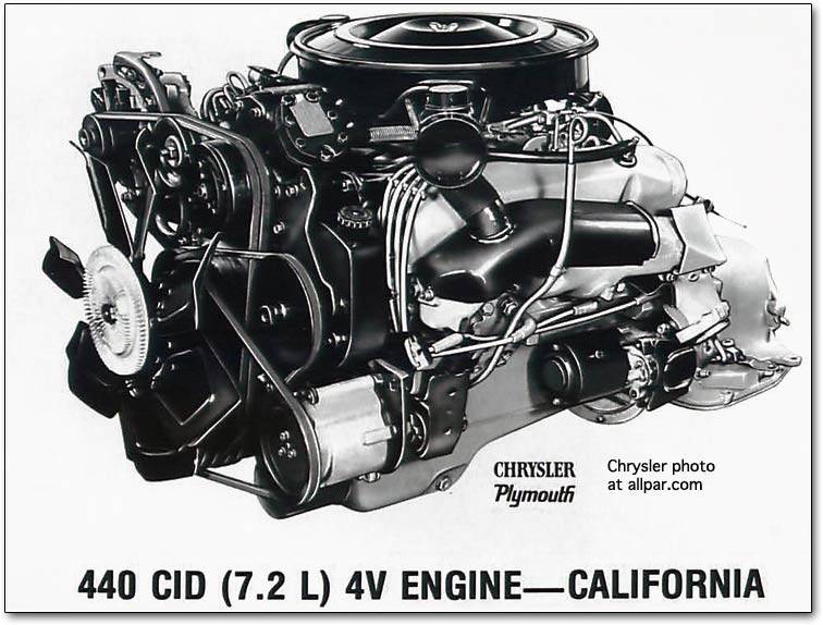

I think I can explain why some believe that Mopar painted the oil filters with the engine block, but I never saw one like that. I started looking at brand new Mopars around 1974. The Chrysler engines in cars changed slightly sometime in the 1970's.
The first photo provided below is an old black & white photo of a 1977 440. The second photo is a 1969 440. As indicated here, and as my memory serves, the 1977 oil filters were not painted the same color as the engine. Those filters were also different than what was sold in the dealer's parts department.
However, it appears that in 1969, Mopar oil filters were painted the same color as the engine block.

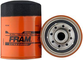

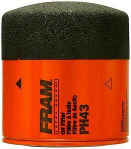

I use a 4" filter on the 440 like this.
The 318 gets this longer filter which wont fit the 440.
They both fit for most applications. I do not use Fram filters, the mount gasket and threads are the same for both filters. I used to use Fram PH8A on everything 40 years ago. Quality went to hell about 20 years ago. Now use Hastings filters. As I recall, some of the small fury's had a clearance issue with the long filter with the big block. The older stuff '75 and back can all use the long filter.

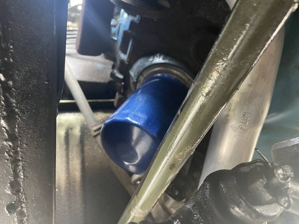

Hey I’m not going to a car show but I’m having a tough time finding any filter that will fit my 69 318 , I’m just trying to find a filter that will fit ? Here’s a picture of the one that I have on now and it appears not to be wide enough to cover the area of the filter I’ve tried 3 different filters that all said they fit ? Any help would be appreciated
