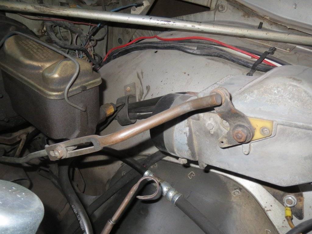

I actually have spares of the 2 rods shown in the pic so if it turns out you need one or both you would have first crack at them.Not yet, it's on the list.
if you need parts I maybe able to help
