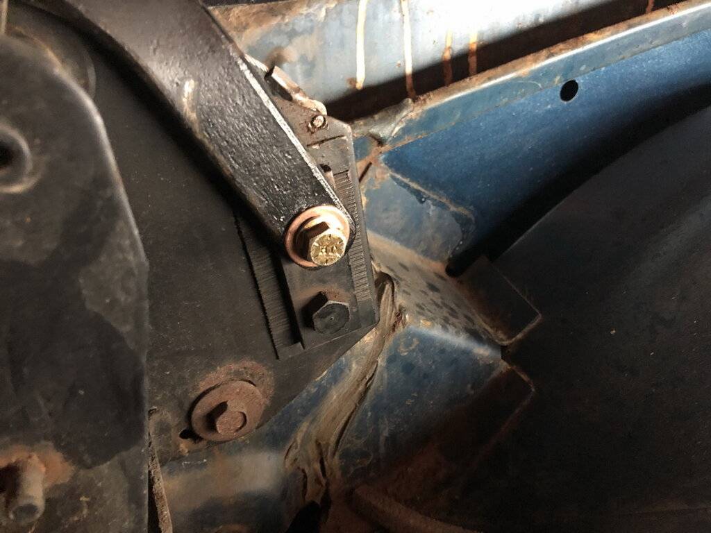

i believe you are right that it is a shoulder bolt. the arm for the rear bow pivots there.
After inspecting the top system and realizing it was not a major leak I chose to just power through it and put the top down. New cylinders and hoses were ordered.

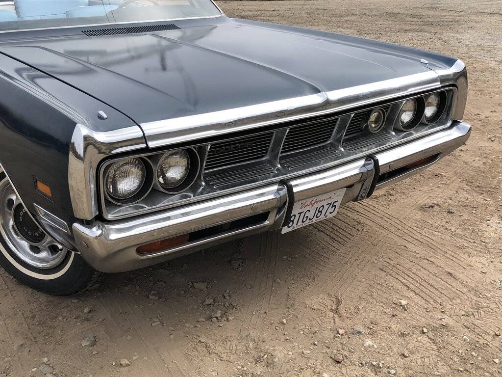

The Spring Special trim (missing its DODGE lettering), also note the grill is polished with no paint.
Hard to see in this picture but the fender extension is banged up
Well not much to say here, the other side is just as bad, no buffing this out.

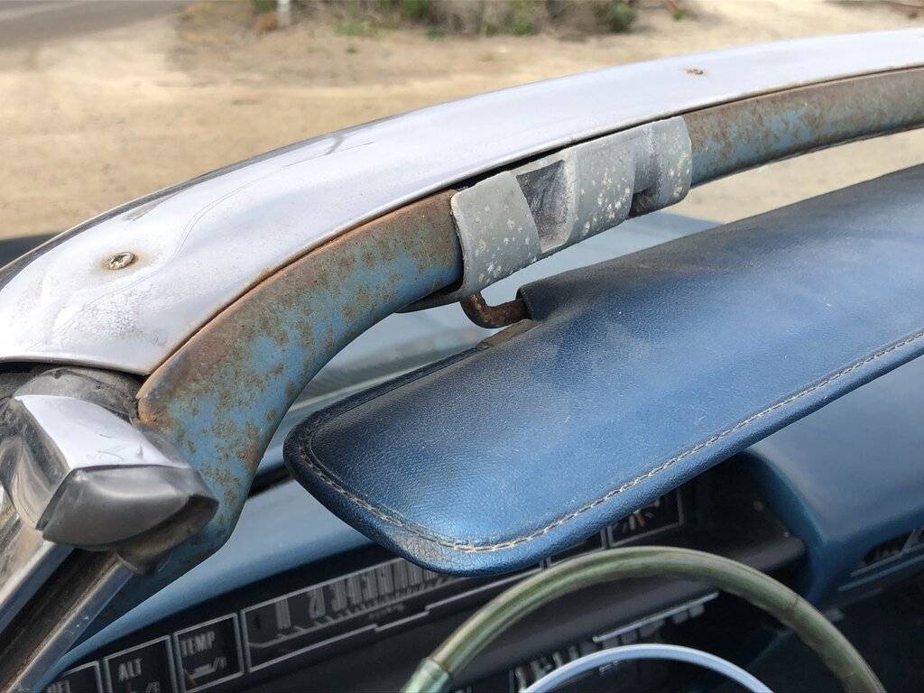

Both the visor brackets and the mirror mount are heavily pitted.

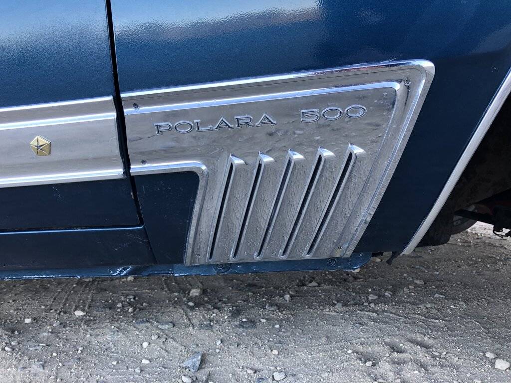

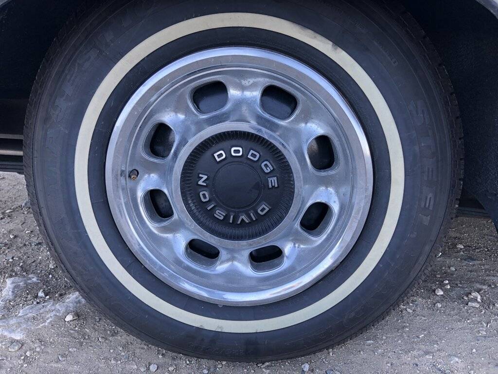

The wheel covers along with the 500 trim are polished, will need to be cleaned up and painted.

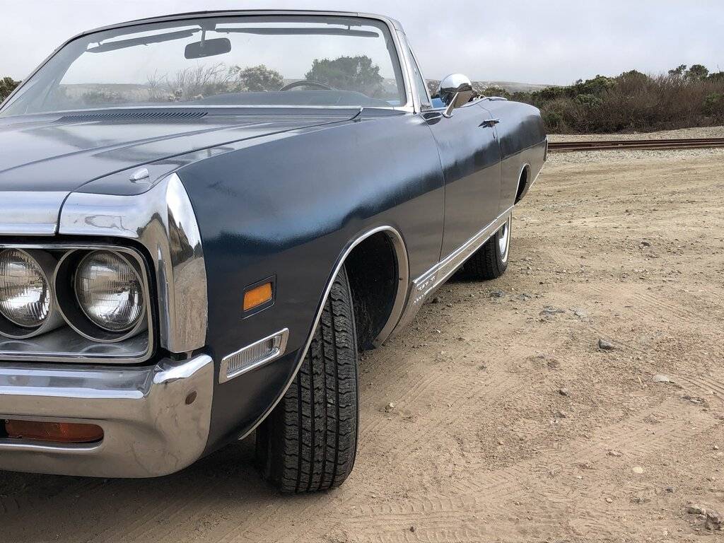

Throughout the car it is showing its age but overall it is a solid car.

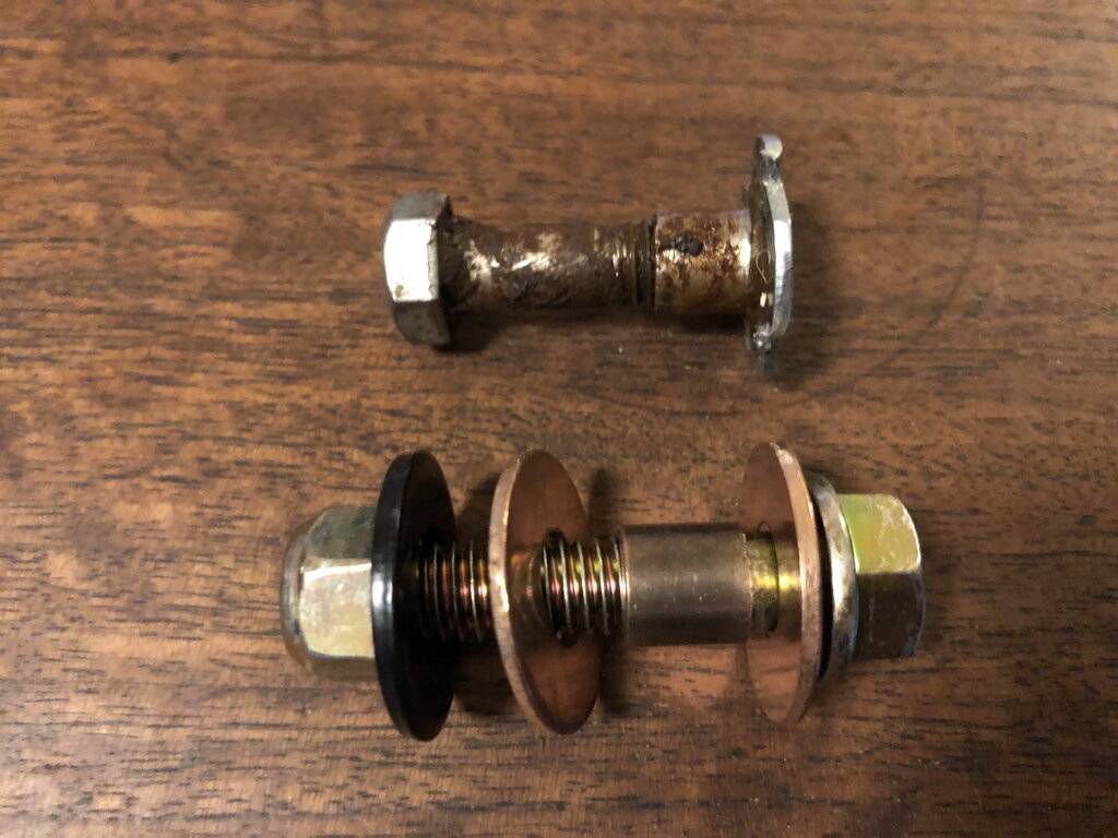

McMaster is generally pretty quick with orders and I got the hardware I needed to fix the top pivot bolt.

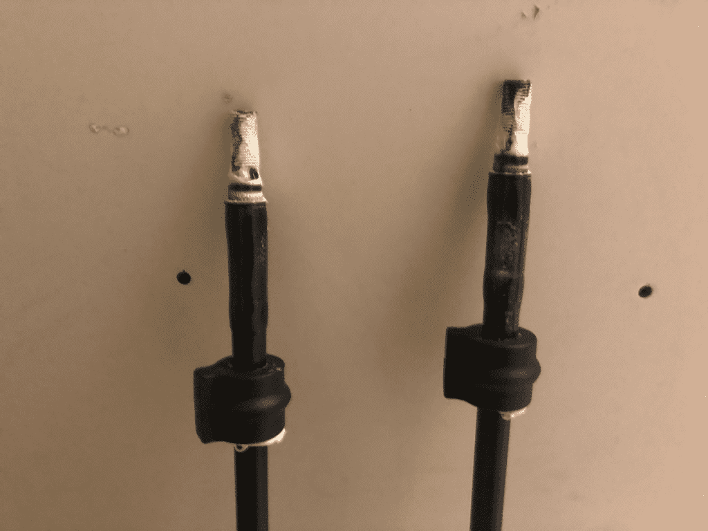

Installed the new lines but they were way long, 16" on each side, not easy hiding this semirigid line. I'm going to look into this some more.

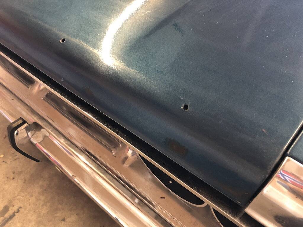

I was curious about the Spring Special trim and went to remove it just to fined 5 studs through the hood holding it on.

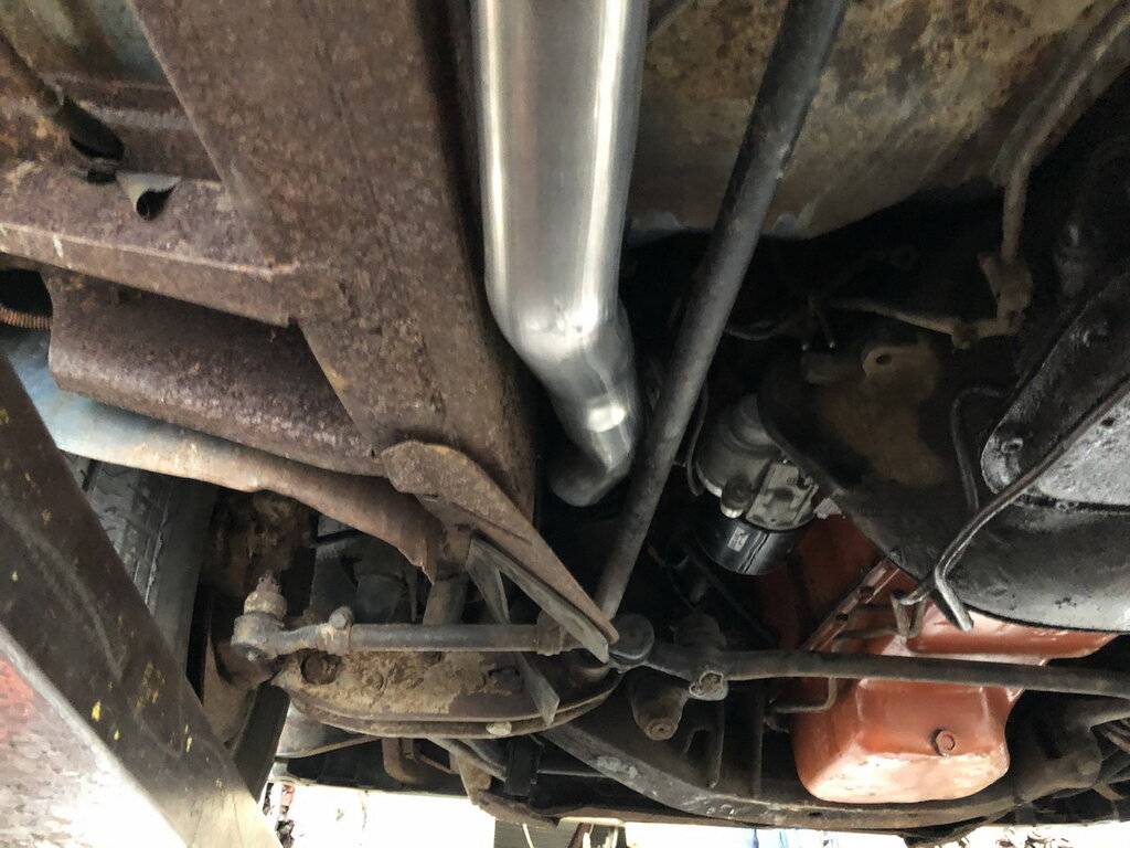

Once i had all the new exhaust in the car it was banging against both the frame and the torsion bar on the left side, this same exhaust was used on a friends car with no issues so I needed to have it looked at.
So I took the car to an old school exhaust shop and had them look at it, we heated to pipe up and put a flat spot where it was rubbing the torsion bar. When I fired it up it was just as bad, he was still under the car and said I needed to see it. We swapped and he gunned it (in gear) forward and reverse and you could see the engine rolling bad, the engine mounts were like Jell-O.

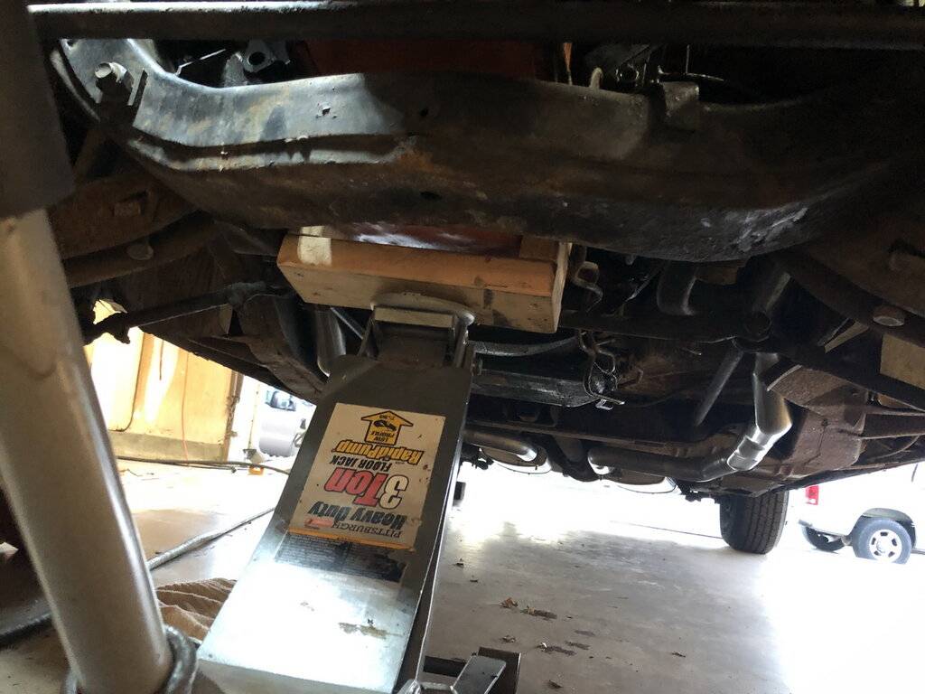

I had a set of quality mounts already so we spent the morning swapping them out, not as easy as you would think.
No worries, we had a cradle to jack against.

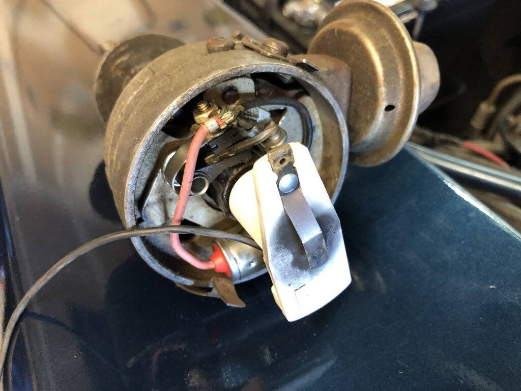

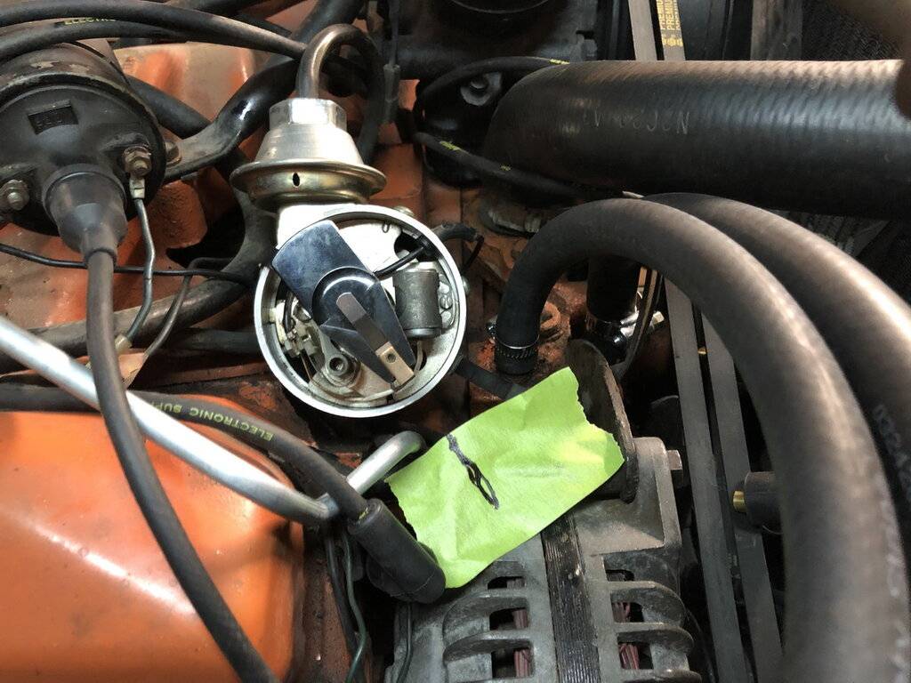

When working on it we bumped the distributor and the cap came off, turns out it only had one locking strap (that way when I got the car). It still had the factory original distributor.

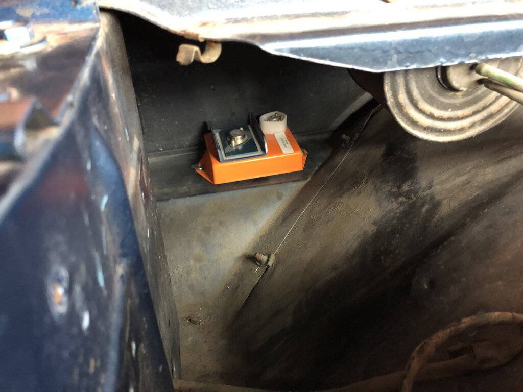

Not wanting to use the original distributor and fix it I chose to get a new one and upgrade to electronic ignition. Like the CHP car I chose to put the module in the fender.
Not wanting to wait till I had the new electronic distributor I used a slightly used points one, with everything lined up it fired right up.

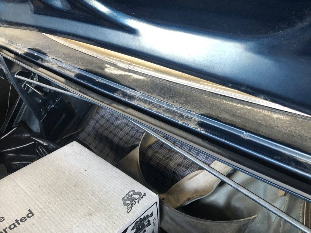

One thing I noticed when I got the car were these rivets in the trunk opening channel. They don't seam to serve a purpose and don't appear to be original.

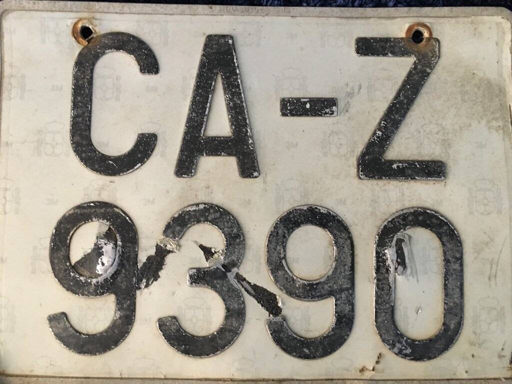

Plate that was on the car when he (the previous owner) got the car., plate is 8x11. Spain

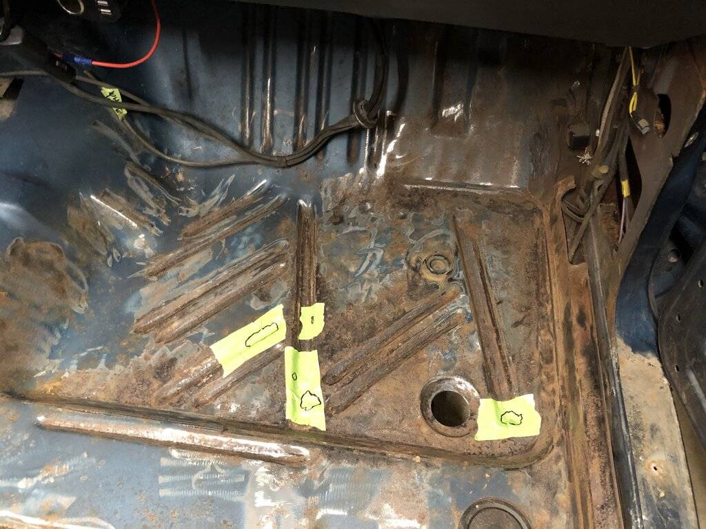

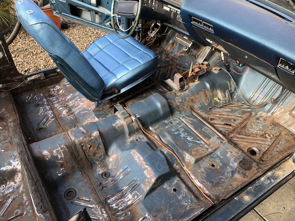

Took some time to pull up the carpet and inspect the floors, I had peeked under a couple times and saw enough rust to warrant a more thorough inspection and cleaning. Most of what I saw turned out to be surface rust and cleanup up quite nicely, I did take my rotary tool and go over the full floor hitting all the grooves and areas of surface rust. The only issues were a handful of holes in the front right foot well. Once I take care of those I'll put a coat of sealer on the full floor.
Not bad for a 52 year old convertible that spent time in Alaska.

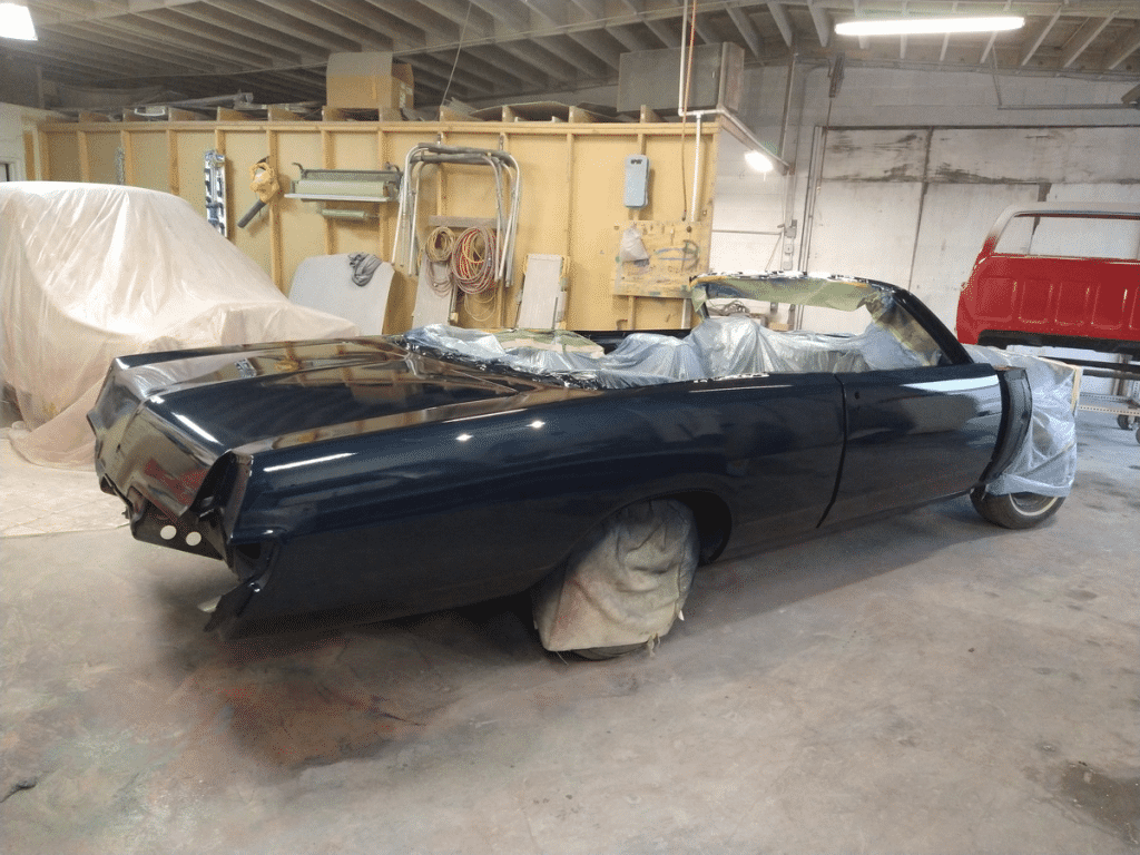

It has been a while since my last update. The car went into the body shop last July and five weeks later it was painted. This version of the B9 blue is far better than what was on the car.

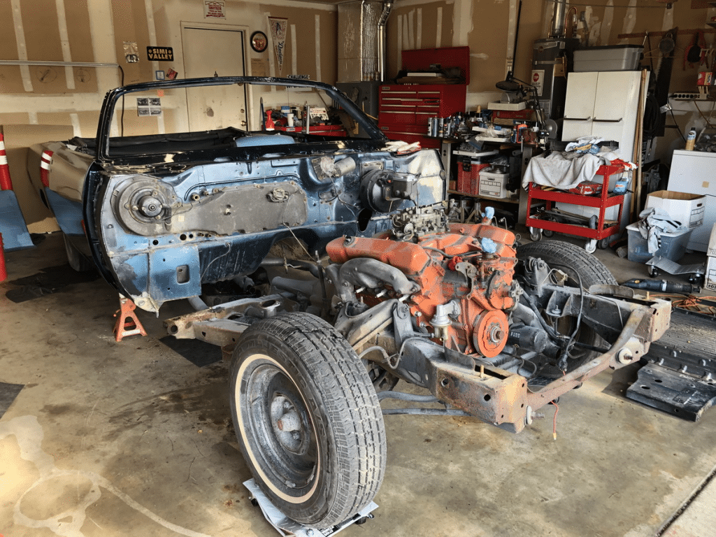

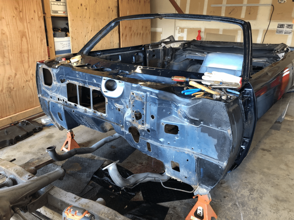

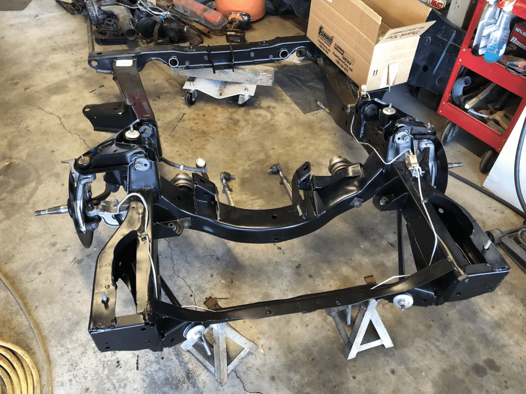

Once I got the car back home I waisted no time in pulling the front frame assembly.
That out of the way I got the firewall stripped.

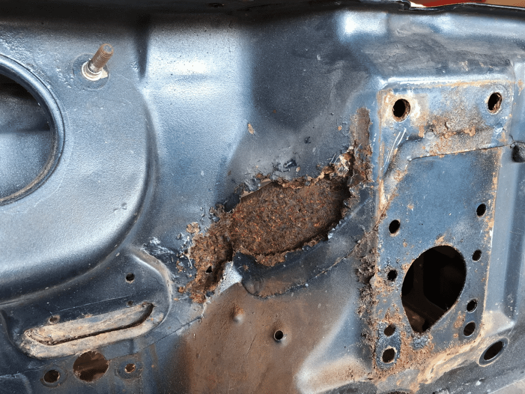

Discovered a rust area, will get taken care of prior to painting the firewall.

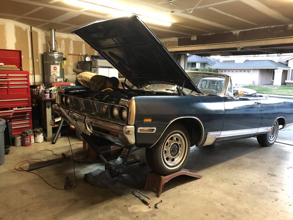

Once again my garage is taken over with a split 69 Polara

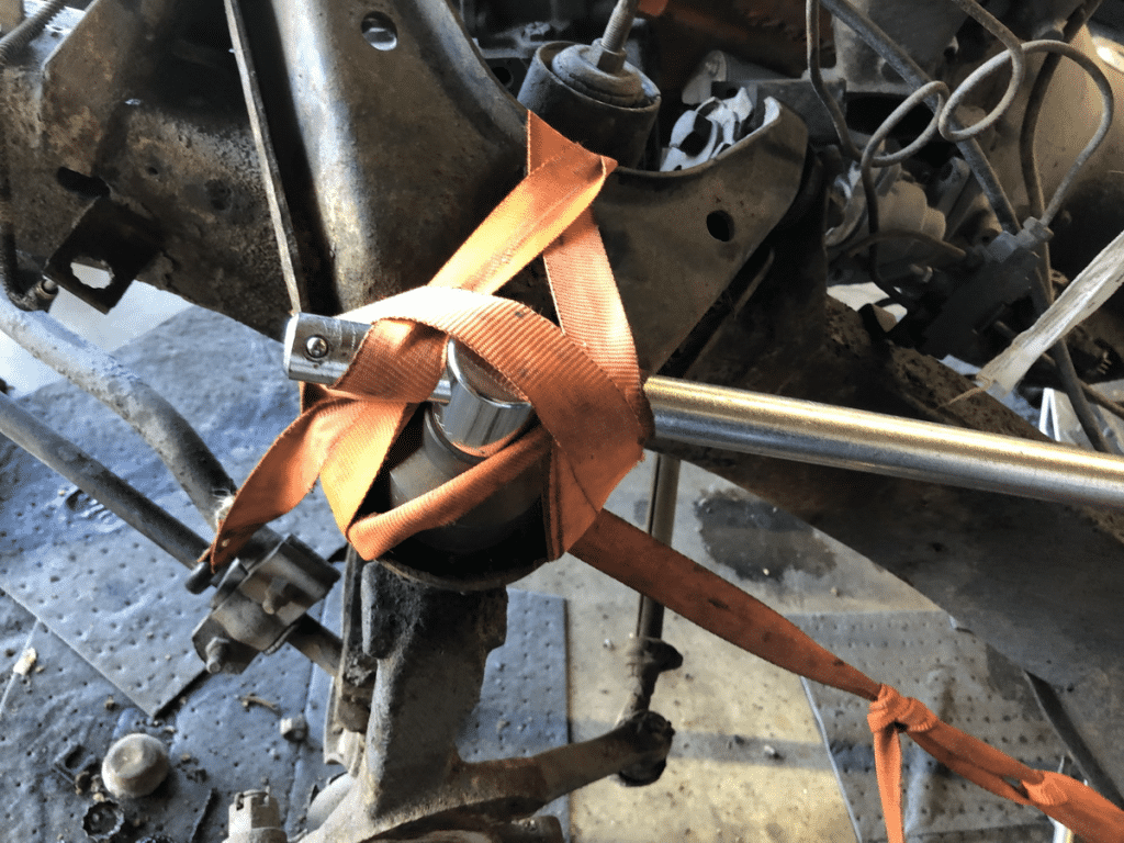

On the left side my socket didn't want to stay on the ball joint, I win.

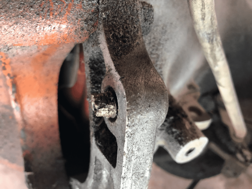

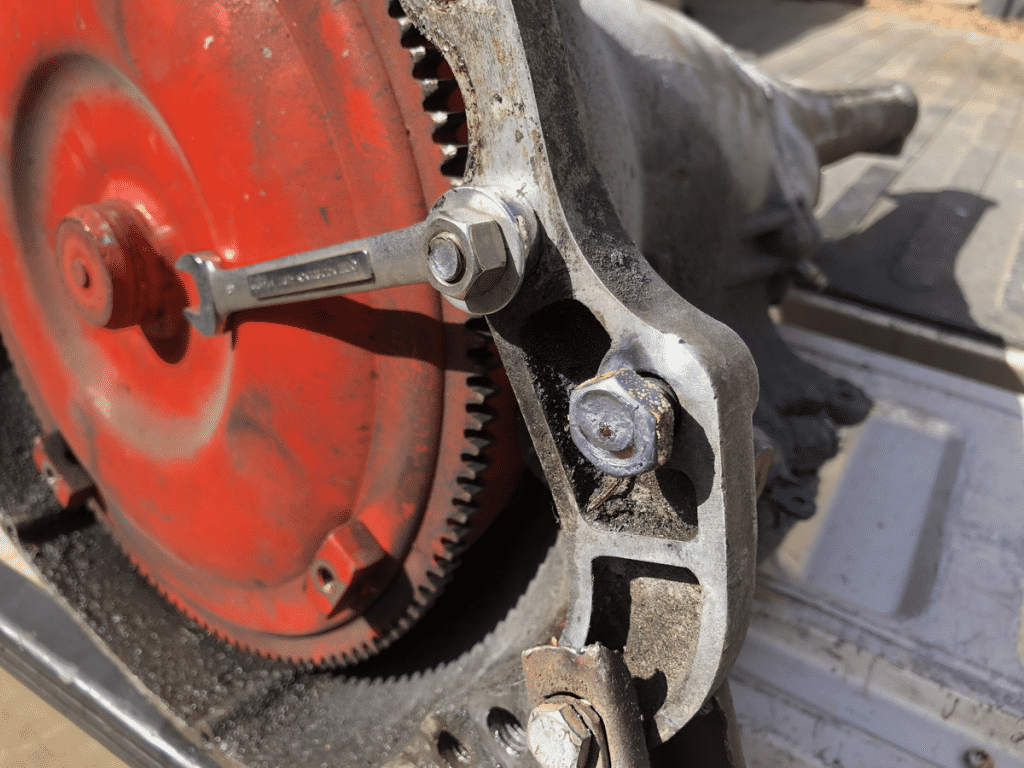

The starter bolt was broken and you can see where they tried to drill it and remove it.

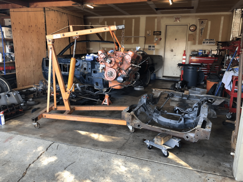

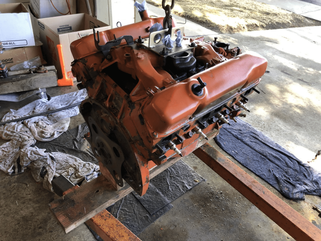

Engine and transmission removed.

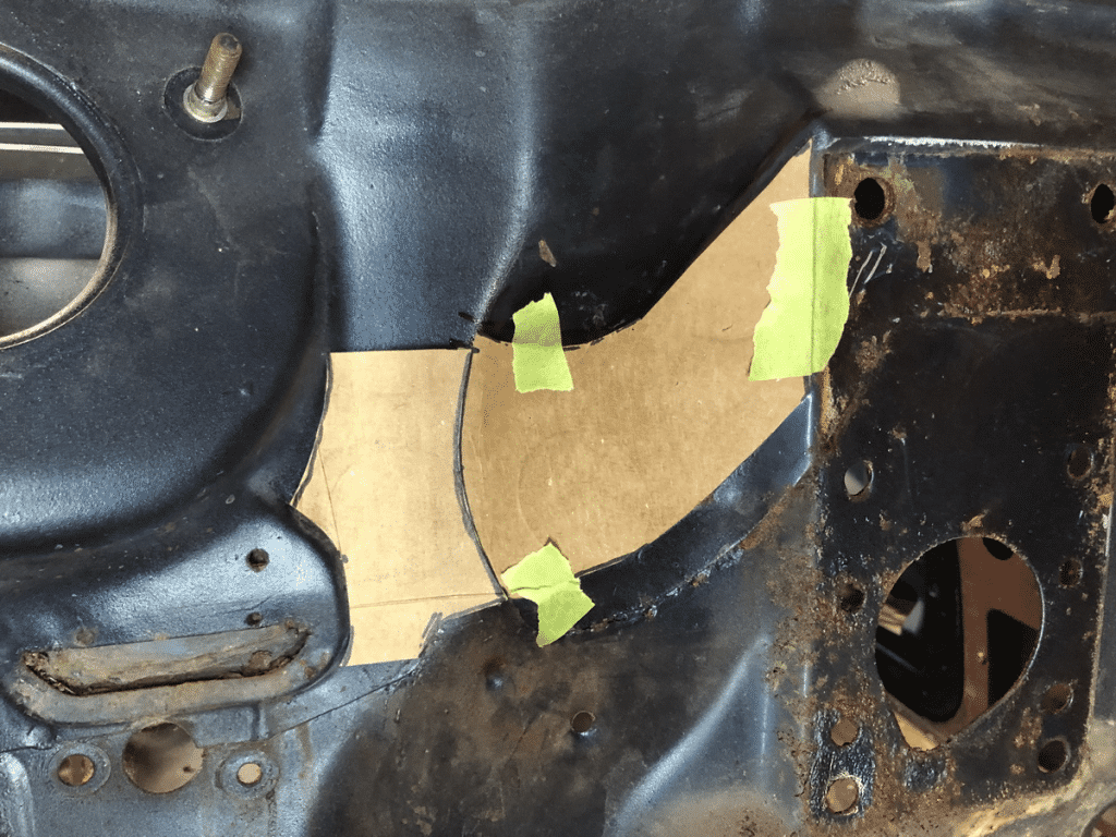

While I waited for my body guy to be available to finish out the firewall I made a patern of what I felt the repair should look like.

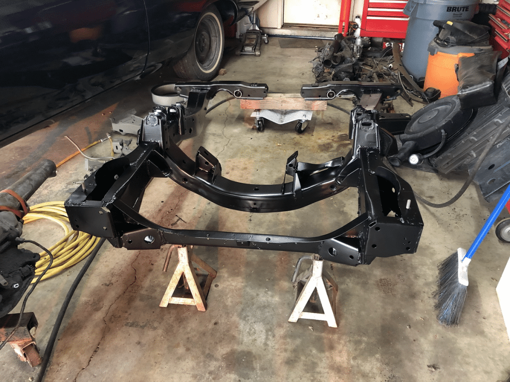

Couple weeks later I have the frame back from the powder coater.

I took the transmission to my friends shop where he welded a nut on the stud, it took multiple attempts to get it clean enough to get a good bond. Even still it took me a half hour of back-n-forth to work it out.

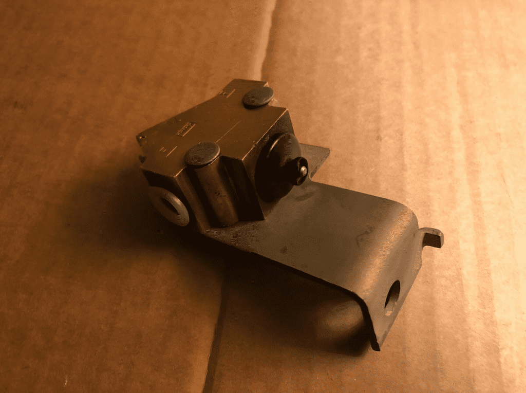

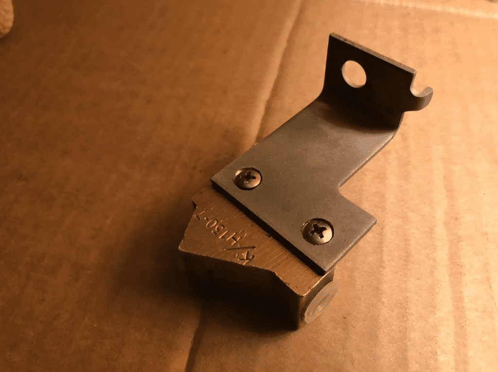

I found an NOS brake hold off valve but it didn't have the bracket. This is the NOS valve attached to the original bracket.

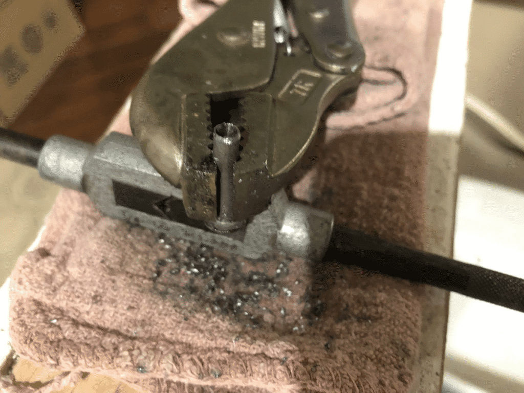

I carefully drilled the rivets and tapped them, it almost didn't work, the wall was quite thin.
The original bracket was counter sunk and machine screws into the rivets.

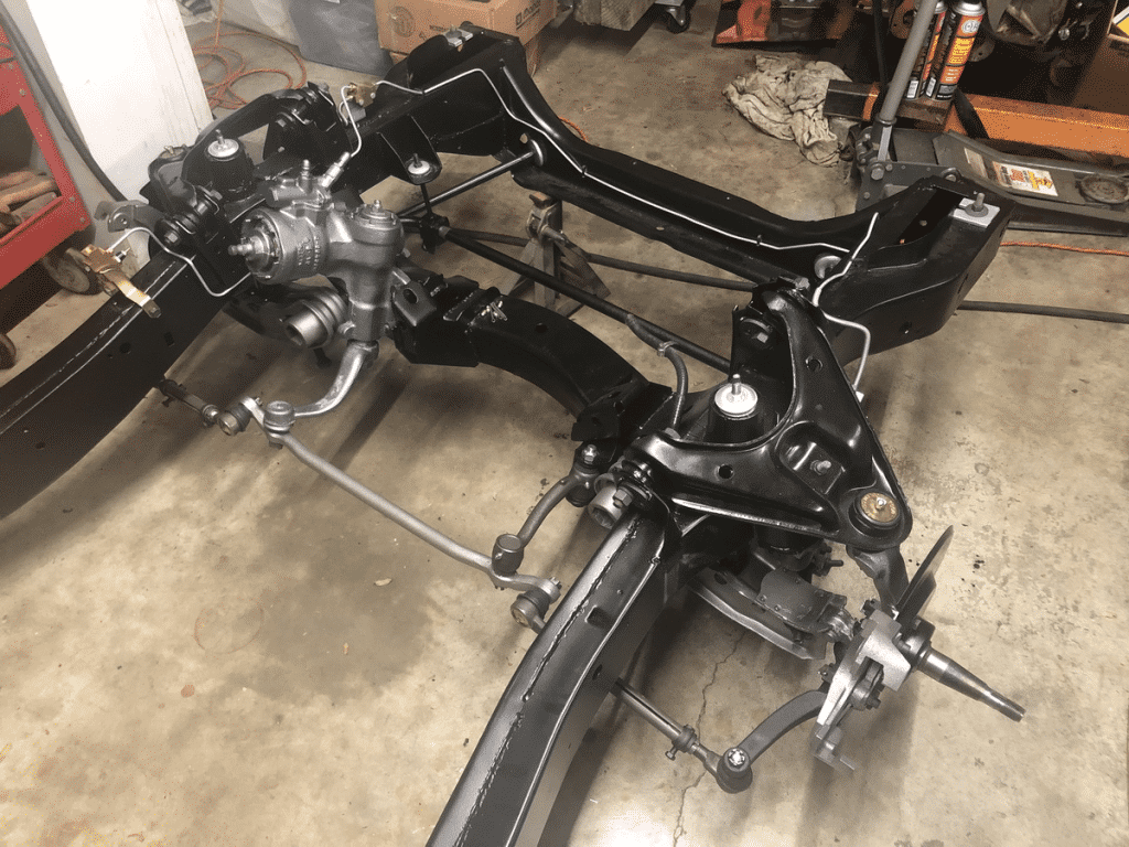

The frame largely together.
Just need to grease and cotter pin everything

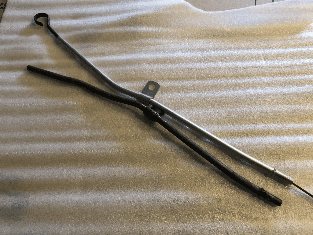

Original dipstick tube was bent multiple times, took a while but I found a correct one.
