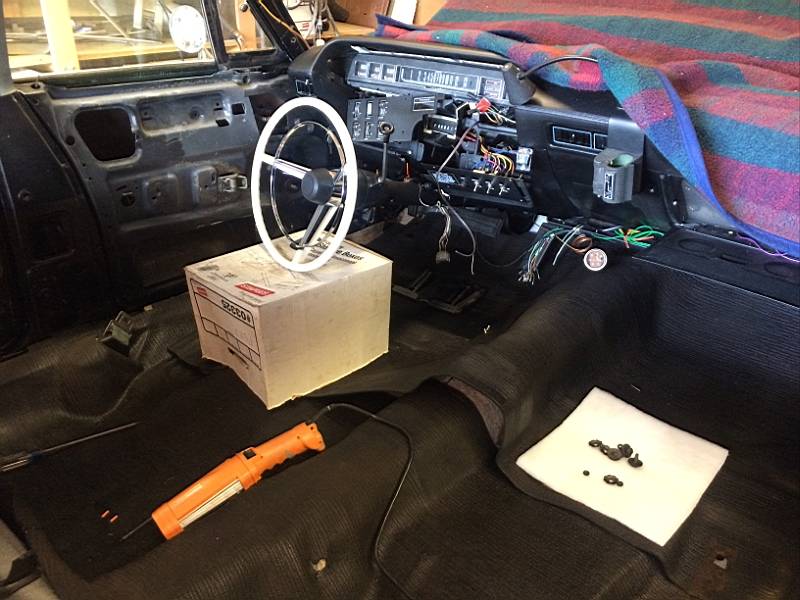

Al original package tray was acquired and installed, a fresh coat of black was applied over whatever color it was. The CHP lights were installed by drilling pilot holed from the bottom side, one speaker hole had to be opened up to bring the cable through.

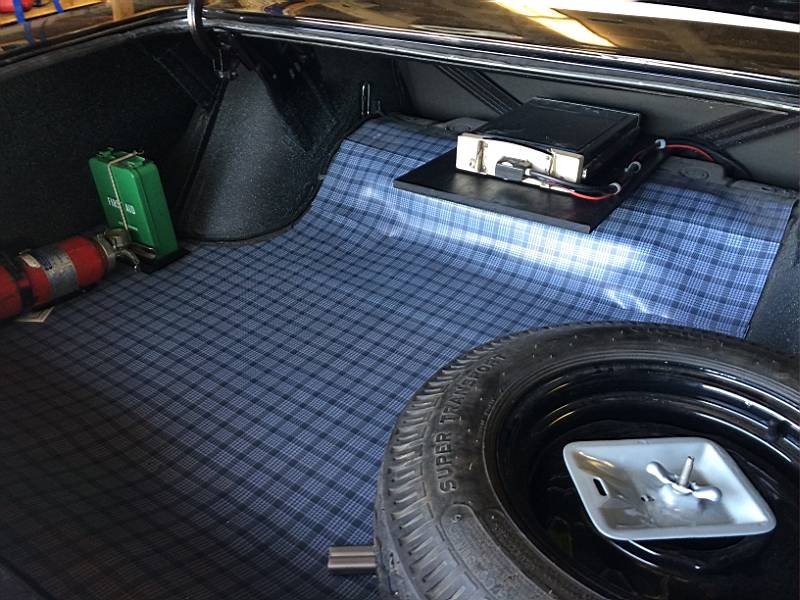

An original CHP radio was mounted on a piece of plywood just as CHP did, and NOS cable was used.
A reproduction battery cable was cut and lugs added, the terminal block was pulled from a CHP car.

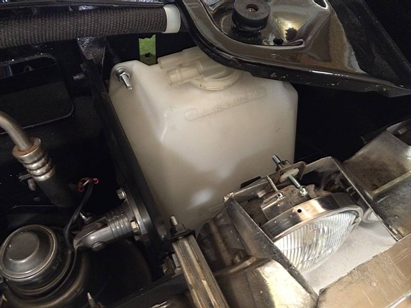

The CHP had a bulletin about adding a Cadillac overflow bottle in as needed, this car had one but I didn't like the way it was placed. some adjustments were made and it was squared up.

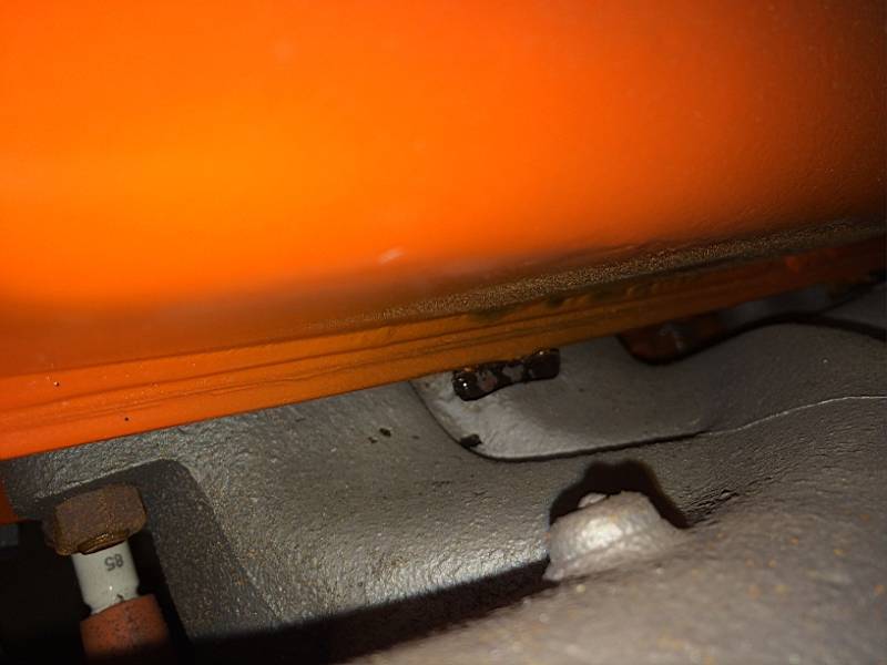

In taking a picture of something else for a friend it was noticed that I had a cracked manifold, I was lucky to have a spare, still need to swap it out.

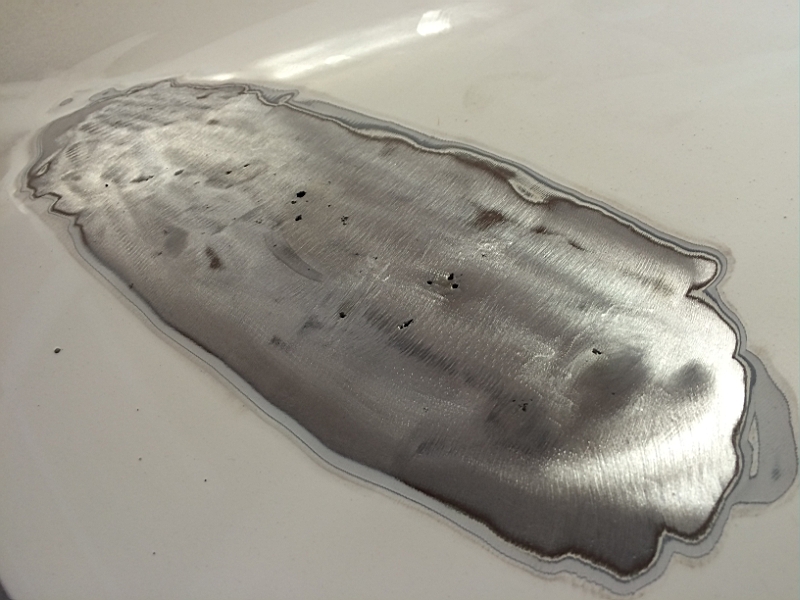

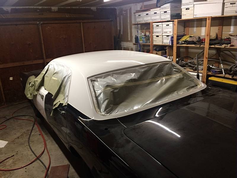

Not to long after to car was painted some blisters were discovered on the roof. Even though the car went to metal when first done it somehow showed up, it was in the area of one of the roof braces so the backside may not received enough rust treatment.

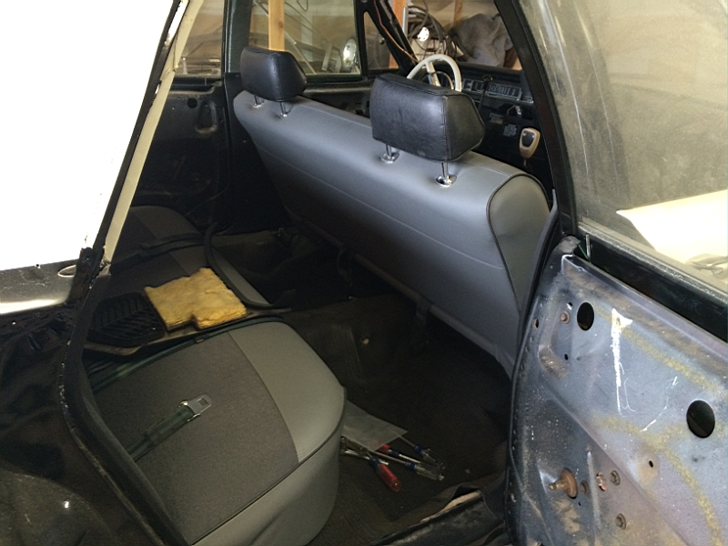

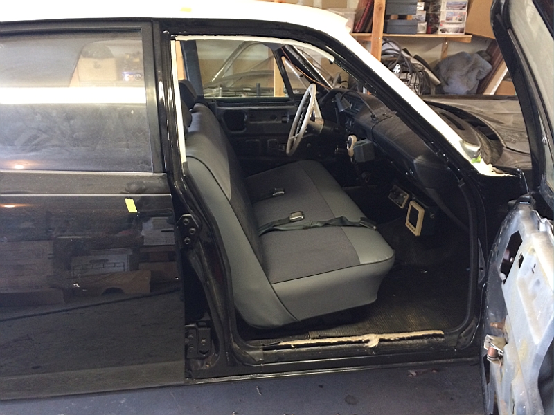

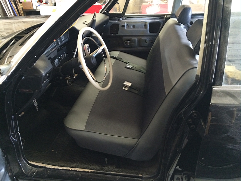

Seats were installed, flooring went in a while ago.

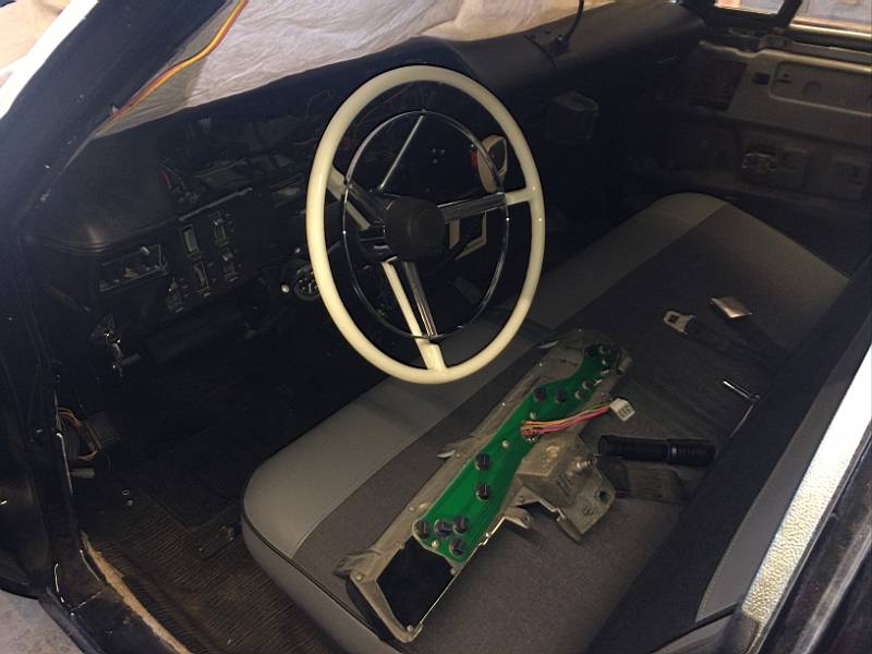

Even though I had the cluster installed but once again it had to be pulled, this time to swap out the gas gauge that wasn't working.
And most recently the roof was repainted, now I wait again trying to get my paint guy to finish it up.
Once this is buffed out all that is left is the front and read glass and all the remaining exterior trim.

Tell me about it, if it wasn't for this the would have been done 6 months ago, I'm ready to give my paint guy the ultimatum and get this done in two weeks or I take it elsewhere. The problem is in my town there are few options and number one on the list is the shop he works at. One excuse or another, time for someone else to get the excuses.
