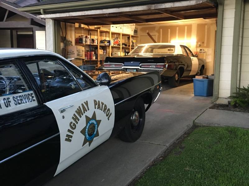

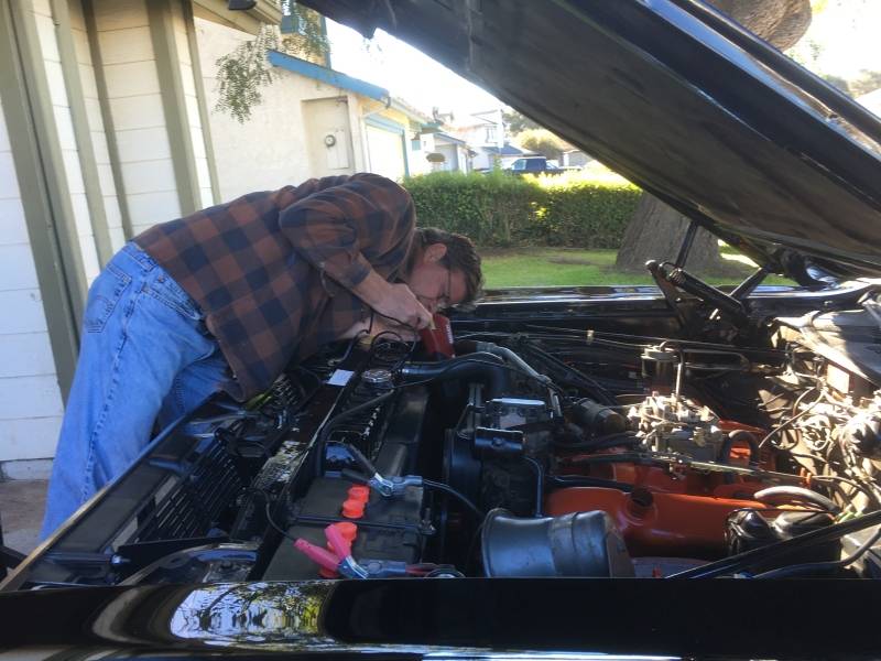

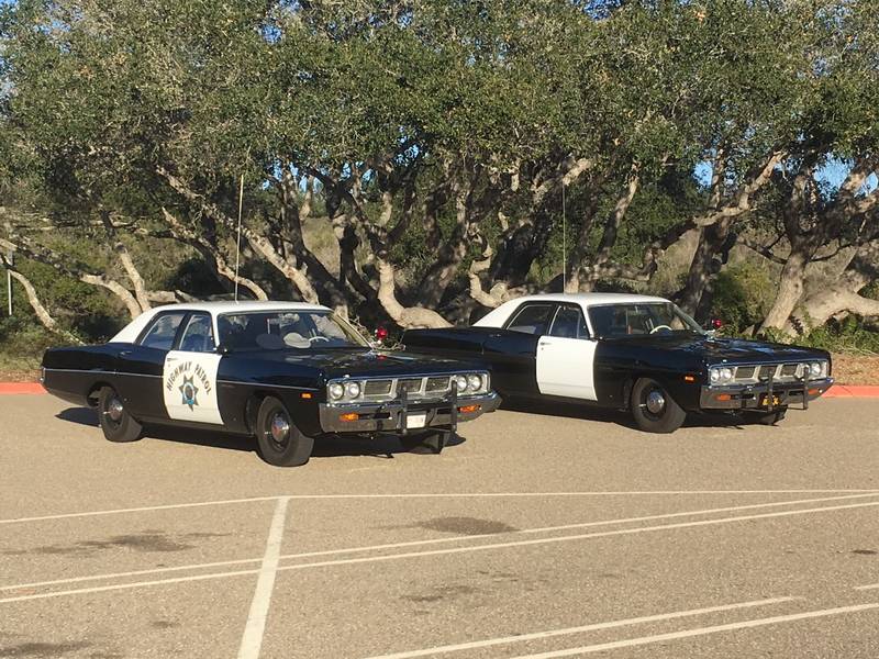

This morning my friend drove up to my place so another friend could do some intensive tuning.
After a few test drives we were done for the day, so we took the two cars out for some pictures.
Until the graphics go on it is still a restoration, once I'm "done" I'll start a new thread.
