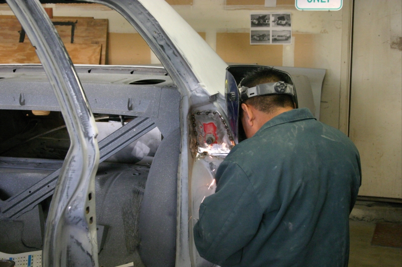

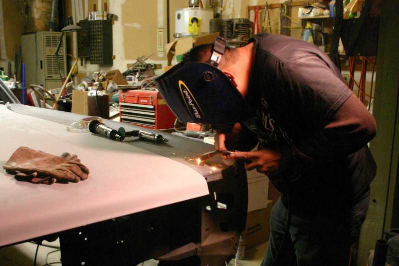

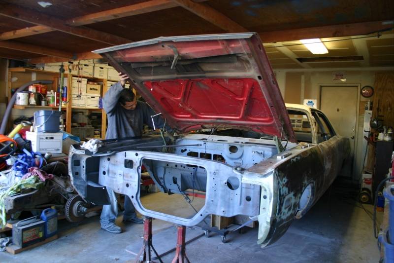

I was frustrated in some of the repairs that I was doing after the show and chose to recruit help. I’m glad I did because every time I turned around he was discovering more problems.

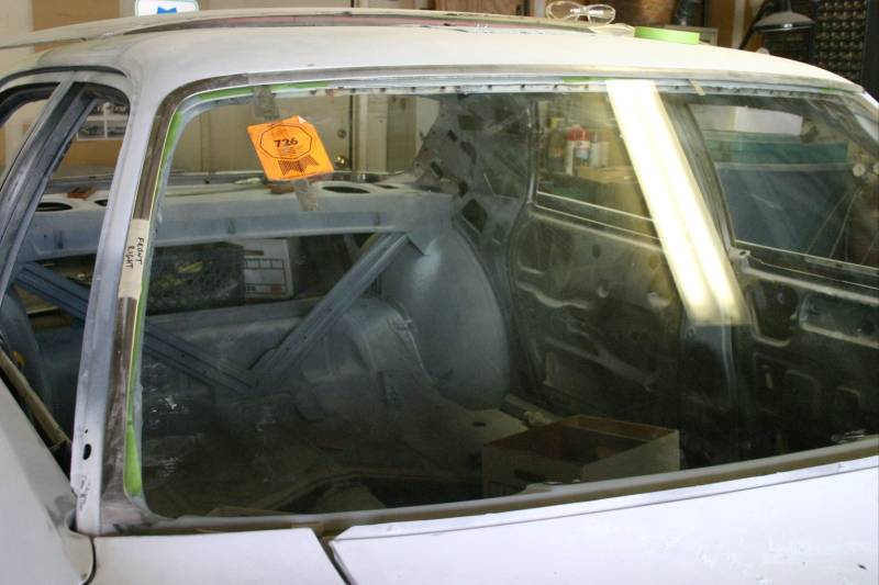

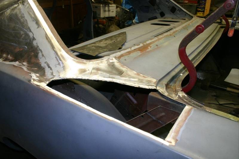

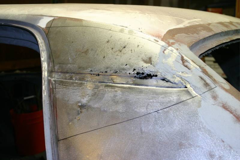

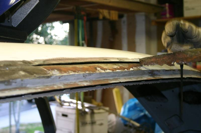

By now I was having him look over all the work that I have done and one thing he wanted to fix was the rear window header. I had left about 2” of the roof attached to the replacement section and he wanted to cut the roof back and but weld the roof to the section.

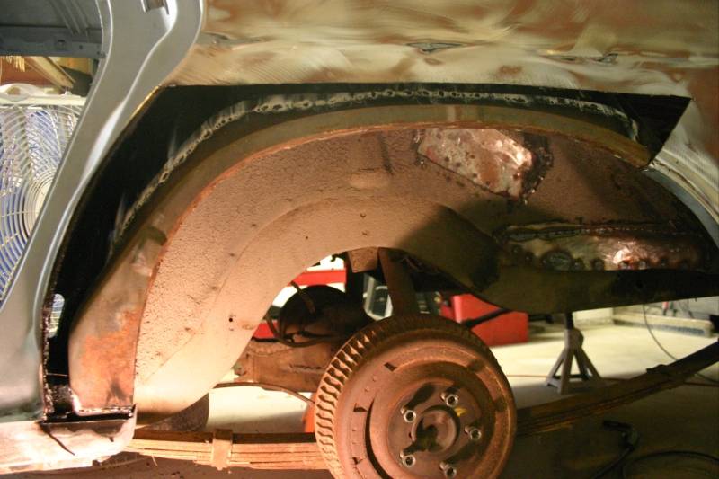

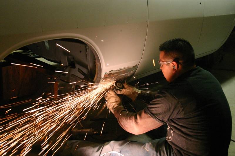

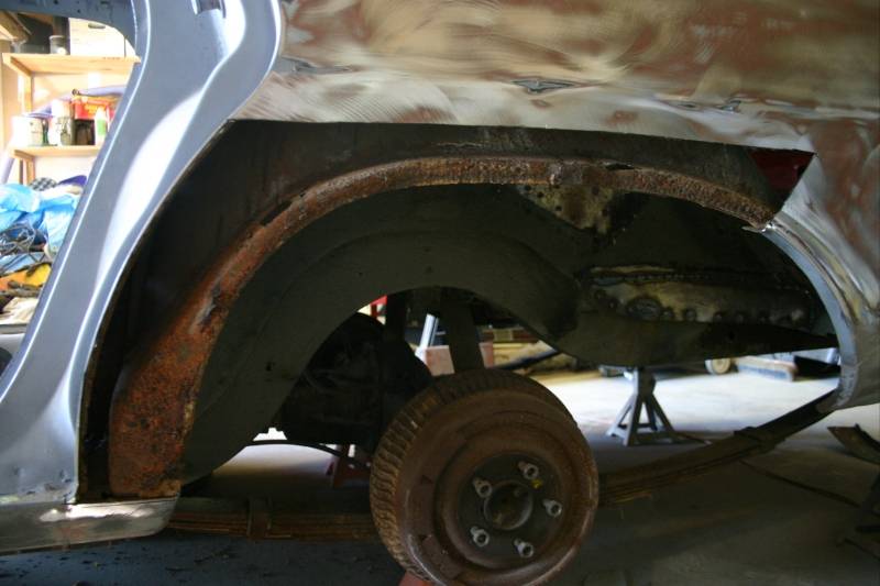

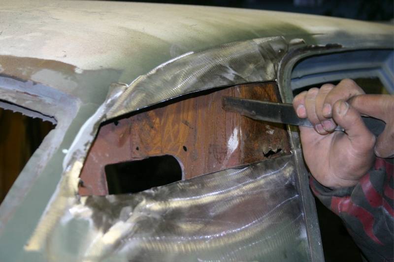

By now we were will into bodywork and there are still discoveries. This time the wheel opening, good this I still had the parts car and that piece was still there (not by much). About 3” of the inside as well needed to be replaced.

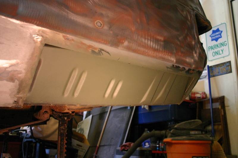

Even though I had already patched part of the lower quarter it turns out the rest was bad as well, fortunately the inside panel was in great shape.
With this repair we were pretty much done with rust repair.

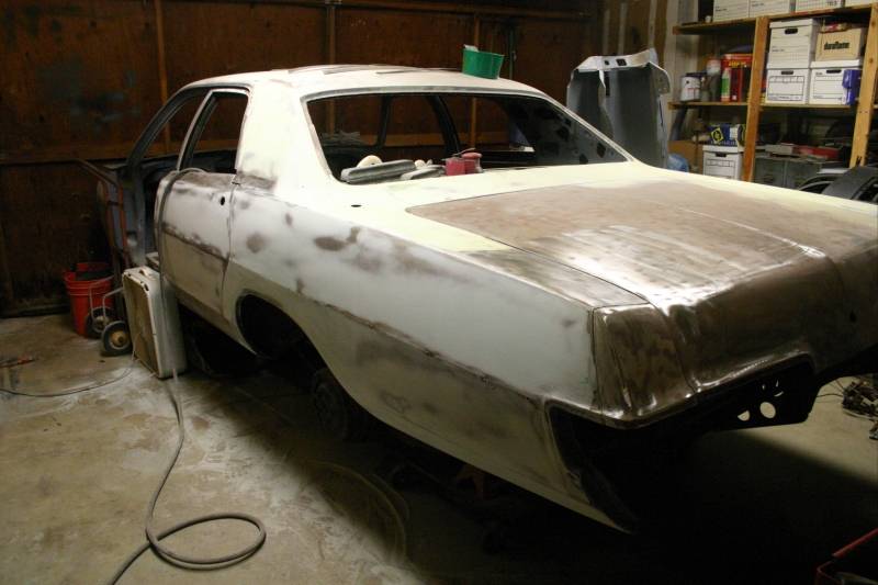

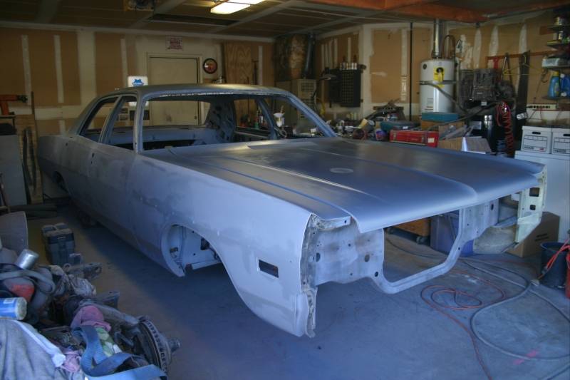

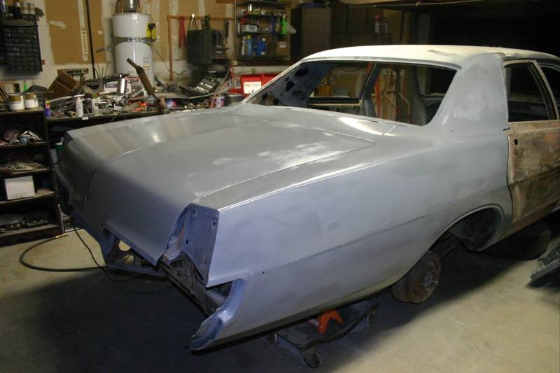

Well under way the rear half was getting close to putting primer on, he has been stripping the car to metal as he goes then skimming each panel with filler.
We were to the point that he wanted to get some primer on all the work that has been done to seal up the bear metal.

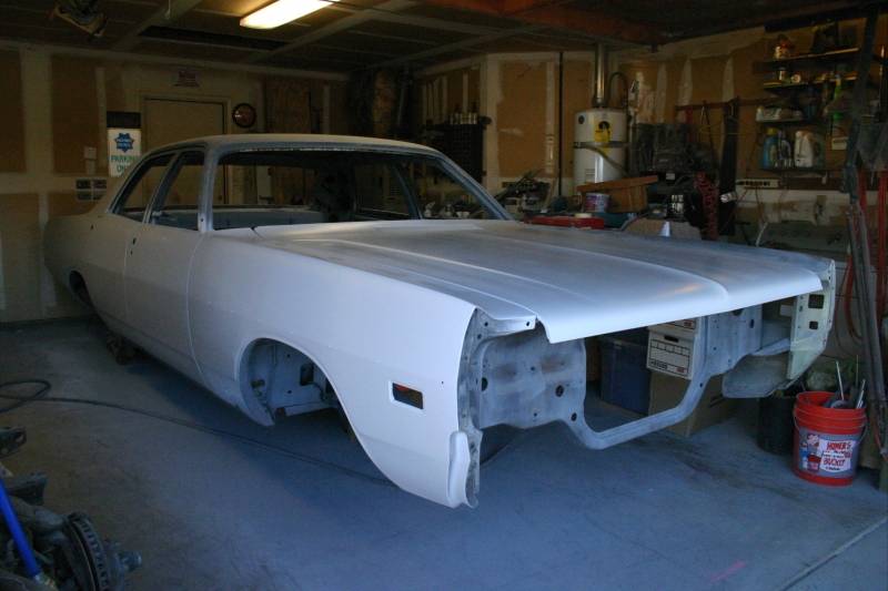

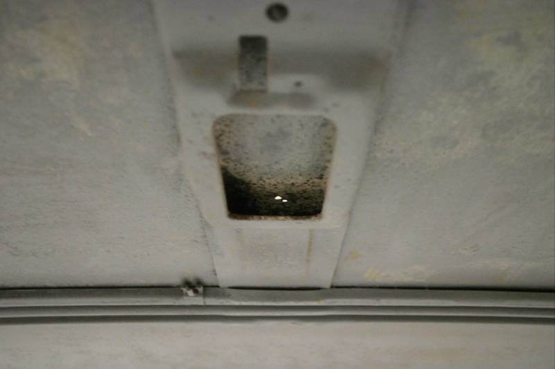

Work progressed forward we installed to fenders and hood and yes I know the core support is backwards but at least you can see the 4” hole put there for the CHP by Dodge. We chose to use the hood from the parts car as the one that was on the car sounded like a baby rattle (it wasn’t the original hood to this car anyway).

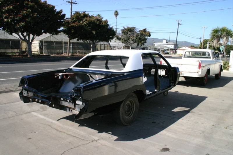

Fourteen months later the bodywork is done and the car primered, soon after I discovered a pinhole right in the middle of the roof.

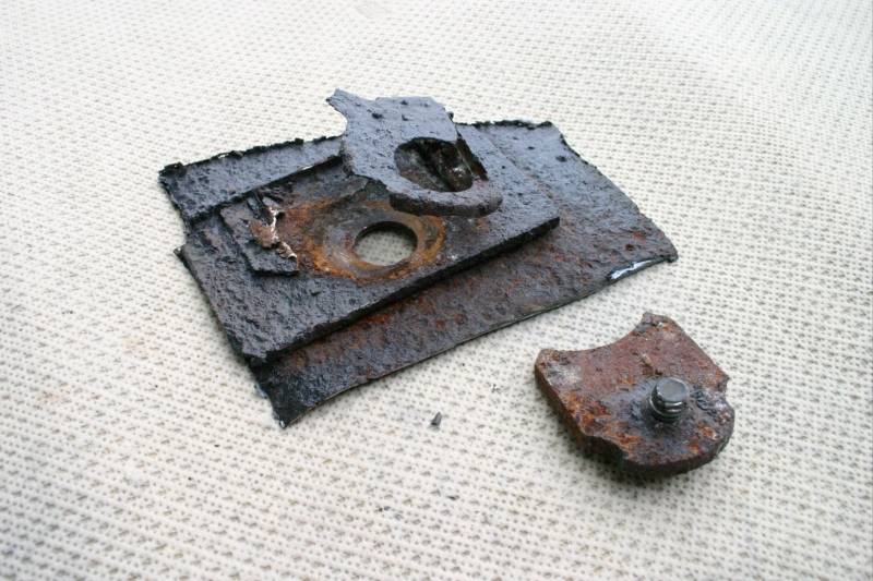

In the final parts of taking to car back apart for painting I went to remove the door strikers which never have been removed and had problems with the left rear. Needless to say couple days before we’re in the booth we are fixing more rust.

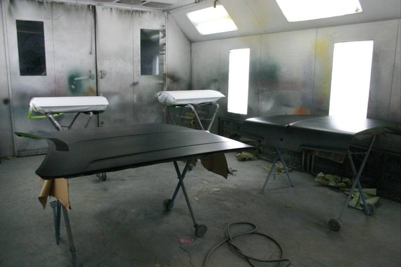

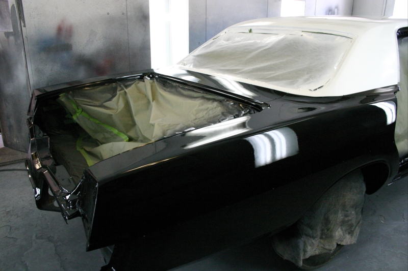

Just over 2-1/2 years into this the car is getting painted. It was a tedious process and we were only able to get the body done as it was all that would fit in the booth, the car was left overnight to dry.
Over the next few days the rest of the body panels were done. We are trying to do this on weekends and after hours as not to impede in the daily operation of the shop that was letting us use their booth.
Three sessions just to get it all done, at least the body and all the panels.
