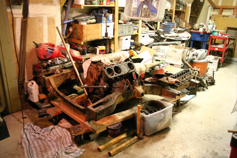

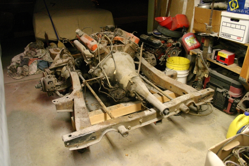

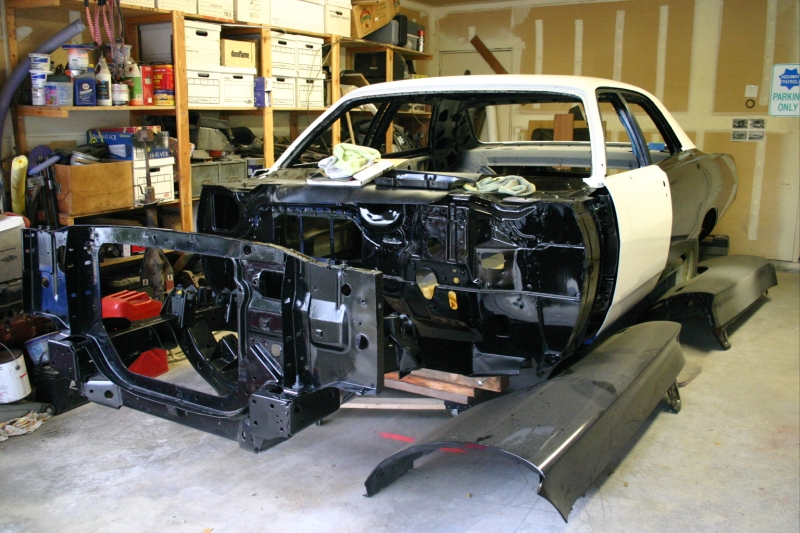

With bodywork winding down I felt it might be a good time to start looking at the engine and frame. After a few days I had it all apart leaving the engine lower end and transmission on the frame. Over the next couple weeks I focused of freeing the engine, I’d brush a mixture of ATF and acetone in each of the bores and try and work the crank. Each day I’d start with beating on a 2x2 with a 5lb sledge and rotating the crank the other way and trying again. Each time I’d get another 1/8” of travel till I was finally able to bust past the stuck spot.

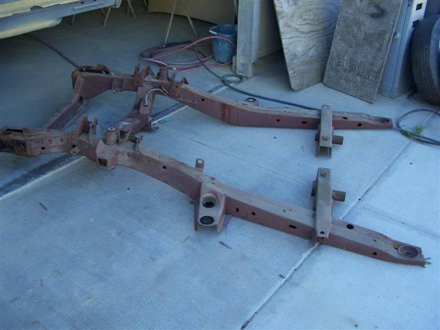

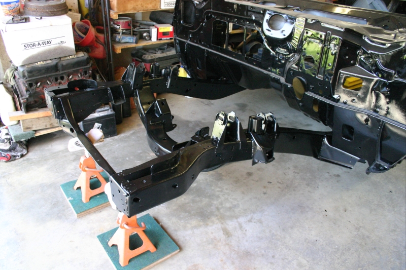

Sometime while the car was being painted I sent the frame first to a body shop to be put on their frame rack and squared (the front foot or so on the left was bent down a 1/2" or so probably from the previous incident with a cow). End Quote.............
Alan, you took the frame to a shop and they straightened it off the car? You then reinstalled the frame after the repair? Were you satisfied with the outcome?

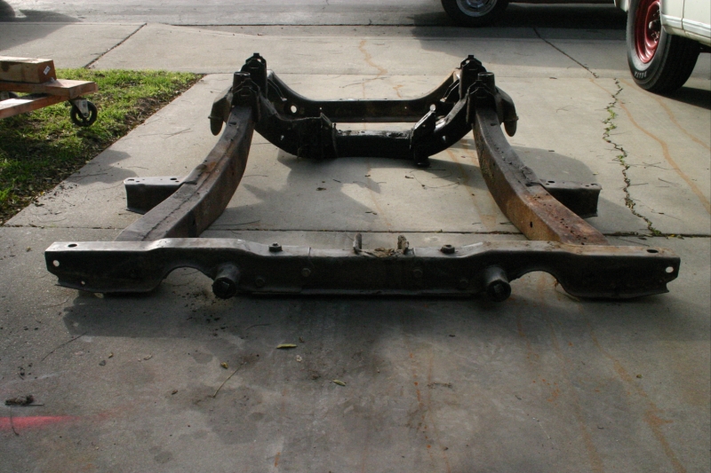

I have an issue with a frame that need to be addressed..............
The rail on the left, the cars right took a wallop. The damage is in front of the wheel probably the forward most 14 inches, the left side of the cars rail pulled a bit from the hit but not as bad
Thank You, I guess I should look into that. My frame is rock solid but has the twist. Frames I have located have been rusted up, scaled, or beat up
I am under the impression that the 69 Frame is the same but it is still too far away. There is one 100 miles from me, $200.00 seems reasonable but I'd really rather keep the original
