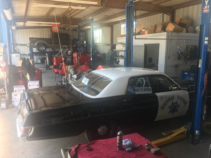

After leaving Fresno I still had a 3 hour drive home, halfway was the transmission shop (Garr's Transmission in Paso Robles) that rebuilt my transmission. this was a carry in bench rebuild so they haven't seen the car. When they did the rebuild they said to bring it back after about 500 miles for a test drive and adjustment if needed, well I have a little more than that and everything felt fine for them. They did look for a leak and felt it might be one of the plugs on the rear of the case, they cleaned it and put some RTV over it, the tail shaft needs to come off to get the plug out.
This gave me the opportunity to get a good look at the bottom of the car and see the areas that I still need to cleanup. The bottom wasn't all that bad but there is another patch that I'm not happy with.

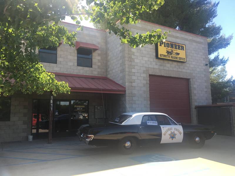

About five miles down the road is Pioneer Machine that did the engine machining, it was a perfect opportunity to drop by and showoff the car, he said they rarely see the cars they do engines for.

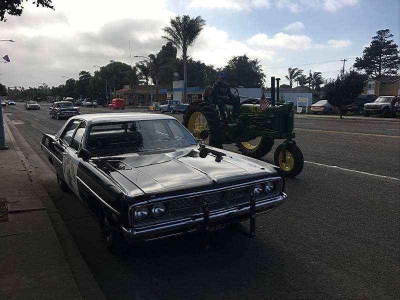

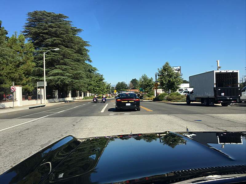

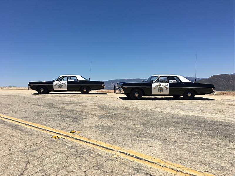

Next up is where the fun starts, I took the car to Newhall for their Fourth of July parade. I met up with my friend Ron and we went to the parade where we met up with the CHP and waited for the parade to start, it was early and it was already well into the 80's. The parade finally starts and we roll off, people love the cars. Just about a quarter of the way (maybe a 1/4 mile) the car shuts down, I try to restart but end up coasting off the parade route. By now it is over 90 and I chose to let the car cool down, after a few more tries I give up and call AAA. The car was towed to the local CHP office where we look at it. At this point it has only been about 40 minutes from when it died and it is hot out. I stand back and let a couple people that may know a little more than I do look at it, their first thought was the pump was bad, Ron just happened to have one in his trunk. Pump swapped we get it started and head out.
We head out with the idea of getting some pictures of the cars together but when we stopped it was just too hot to take time and remove signs and change plates.
I almost didn't get the car started and when I went to drive off it chugged like it was going to die, it recovered and I hit the road home. I figured every mile home was closer to the coast and cooler temps. About 30 miles later our routes split so I pull off to say bye to Ron and the car dies. This time we were stuck for about an hour and a half waiting for the engine to cool down, while we waited I got a fuel filter and some jumper cables. We got the car started got gas right away and hit the road, Ron stayed with me to the coast (another 20 miles) and I gave him the ok, home I went with no problems. I figured the car didn't like temps in the 90's.

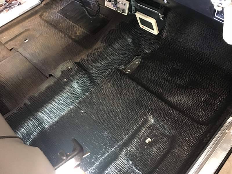

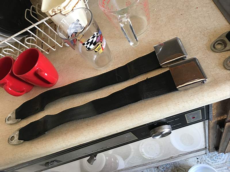

A couple things I felt I could improve on were the seat belts and the floor mat. I pulled the belts out and put them in a bucket of dye, big difference.
While I had the belts out I moved the front seat so I could hit the mats with shoe polish. Three bottles later (full floor) they were like new.

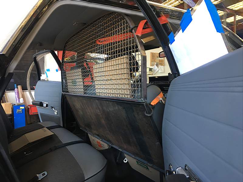

I have known for a while that the car originally had a cage and I had been debating putting one in. I started with a full template that would later be trimmed for clearance. I had a CHP 90's Caprice cage that was built by CHP that was going to used as a guide along with the vintage picture (1961). A local fab shop gave me the quote and I had them move forward.
I almost didn't get the car started and when I went to drive off it chugged like it was going to die, it recovered and I hit the road home. I figured every mile home was closer to the coast and cooler temps. About 30 mile later our routes split so I pull off to say bye to Ron and the car dies. This time we were stuck for about an hour and a half waiting for the engine to cool down, while we waited I got a fuel filter and some jumper cables. We got the car started got gas right away and hit the road, Ron stay with me to the coast (another 20 miles) and I gave him the ok, home I went with no problems. I figured the car didn't like temps in the 90's.

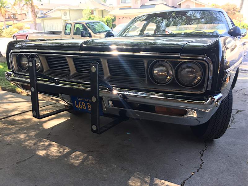

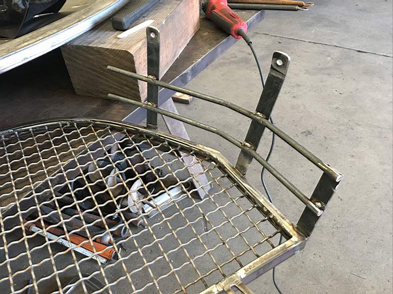

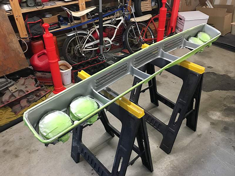

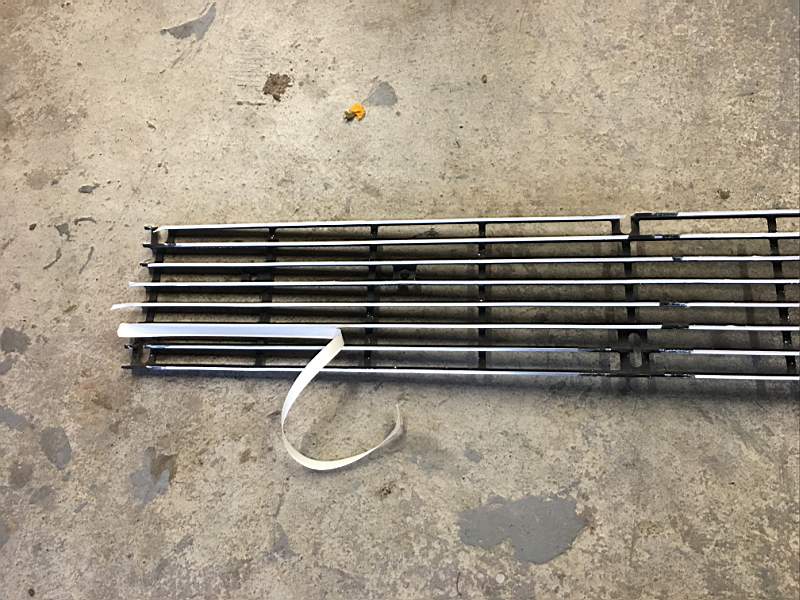

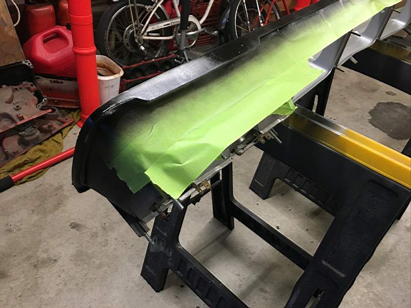

The next item I needed to improve was the grill. The push bar needed to be removed first and then the grill. With the grill off I removed the finish panel and polished the edges of the fins then masked them off, although it was an anodized part I painted it. On the housing I masked the chrome off and painted the silver, after a few coats I changed the masking and did some blackout.
Back on the car what a difference.

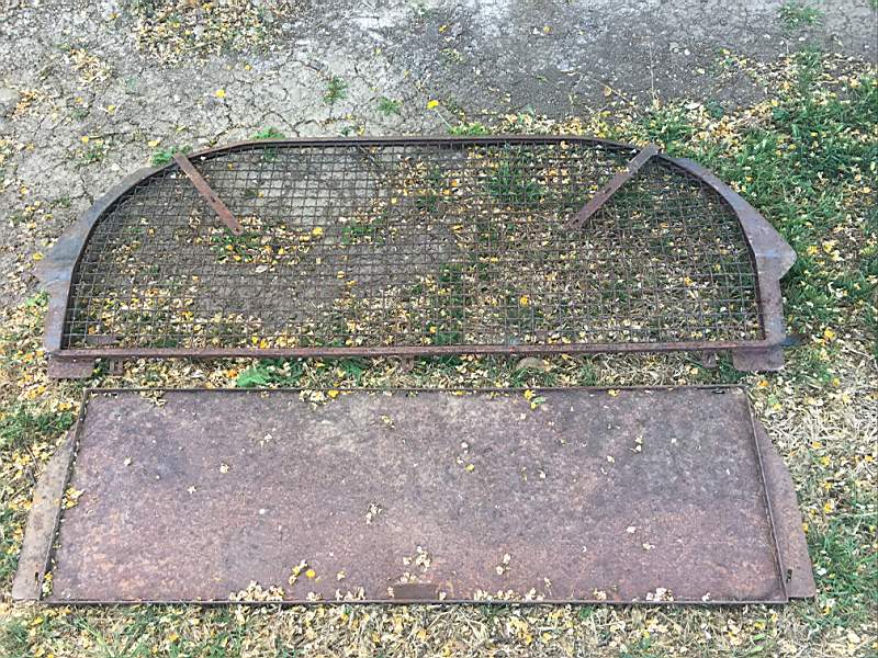

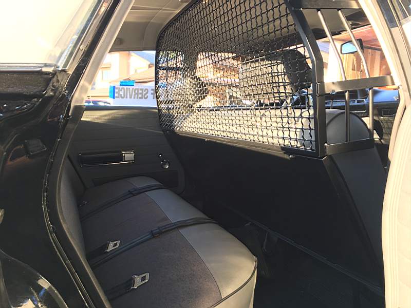

The cage was ready to fit in the car and make the brackets so I took the car to the fab shop where the floor mounts and b-pillar mounts were sized.
The panels were sent out for powder coating and installed

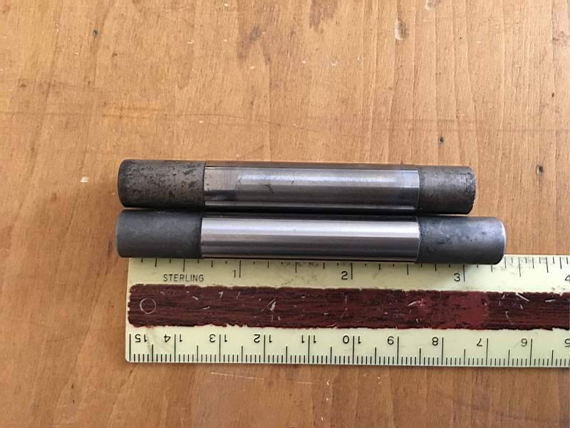

The new pump had a noticeably heavier spring in it and right before we go to install it we notice it needs an adapter, off to the parts store. Adapter added we install the pump and do a flow test, nothing not a drop? So we pull the pump and remove the push rod, at a glance it didn’t look right so I call Ron and asked if he had one in storage, he did so I went and got it.
The new push rod was about 5/16” longer, that is a lot of wear for an engine with about 3900 miles on it. Assembly lube was applied to the rod and it was put in, pump installed and fired up. I drove the car for a little bit and got on it a few times with no issues (but it was only in the 60’s).

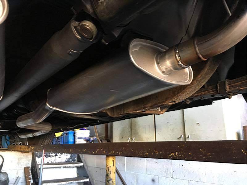

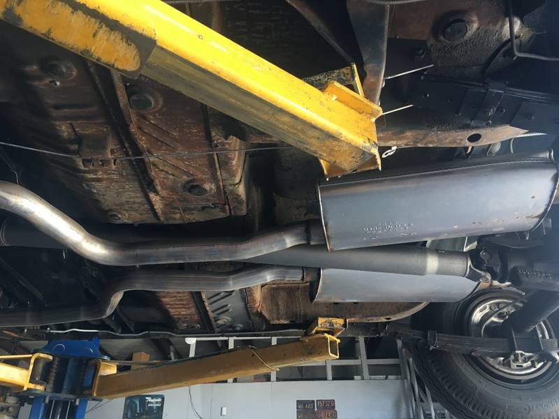

I arranged to get new mufflers installed and one was selected that matched the reproductions that were on the car. I got to the shop and they were still waiting for their delivery, this gave me time to get under the car and look at the areas I still need to detail. The mufflers came in and they made quick work of it. The car was taken for a 20 mile test drive just because, I like the sound of these new mufflers better, not so hot roddy.

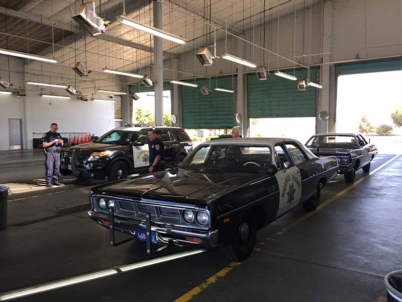

A week later and we are about to repeat the run hopefully with better results. Once again we head out and top off with gas and roll. The drive went great, two hours later we are back at the scene, no construction and the car is running fine.

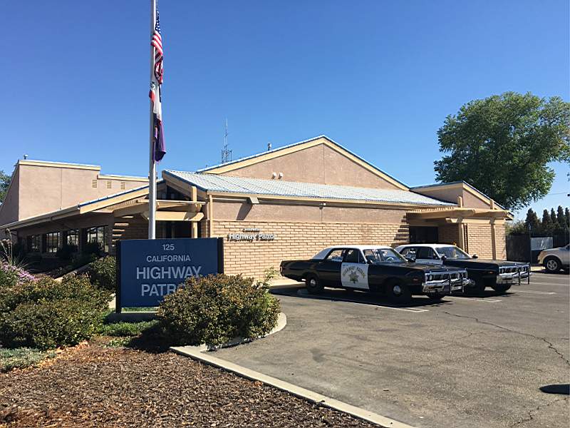

We make a minor detour and drop by the Coalinga CHP Office where their few people came out to check out the cars. They rolled one of the Chargers out for some pictures and on we went. The next stop was a couple hours away, the Chowchilla scales have become one of our regular stops and again they were happy to see the cars.
After a brief visit we headed into Ripon and met up for the Friday night cruise, just lights no sirens.

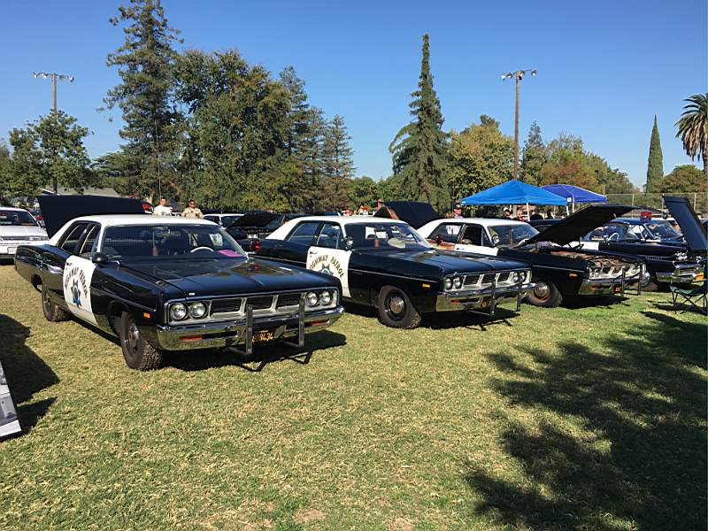

A few other cars showed up (in this class) and one of them was a very nice CHP 58 Mercury, we have a show now. I spent the day looking at the other cars and hanging out at my car, the cage was a big conversation starter.

The cage is interesting. I did not know they were in use as early as your car.
Do you have a photo of the end of the rod? would be interesting to see wear pattern.
I wonder if the cam got damaged in any way.... was this a new replacement rod or the original? Perhaps if the original it was worn down before?
These don't have that much pressure on them, something's fishy here...:stop:
Is it kosher to use an old oil pump push-rod on a new cam?

The push rod was a new OEM piece, in a couple weeks after my next show I'll update the fuel pump rod status. At that time I'll get a picture of the different rods and the wear. With the issues this caused I'll probably be inspecting it on an annual basis, maybe more. The 4200 miles will probably be a typical year, so a 1400 or 2100 mile inspection may be needed till I'm comfortable with it. I hope the new Comp Cam push rod is a better match for the cam.

Next up was a show in Solvang I had been looking forward to, limited to pre 80's cars and the first 300 entries. I was in the 1960-1980 Ford/Mopar (no Mustang/Cuda) the car got a second place. While at the show a couple comes up and says they think this was her fathers car, turns out it is. The person I had been dealing with was her brother but it was their parents that purchased the car from the CHP. They own a shop across the street, didn't know the car was going to be there or I was even local.
View attachment 146794 View attachment 146795
