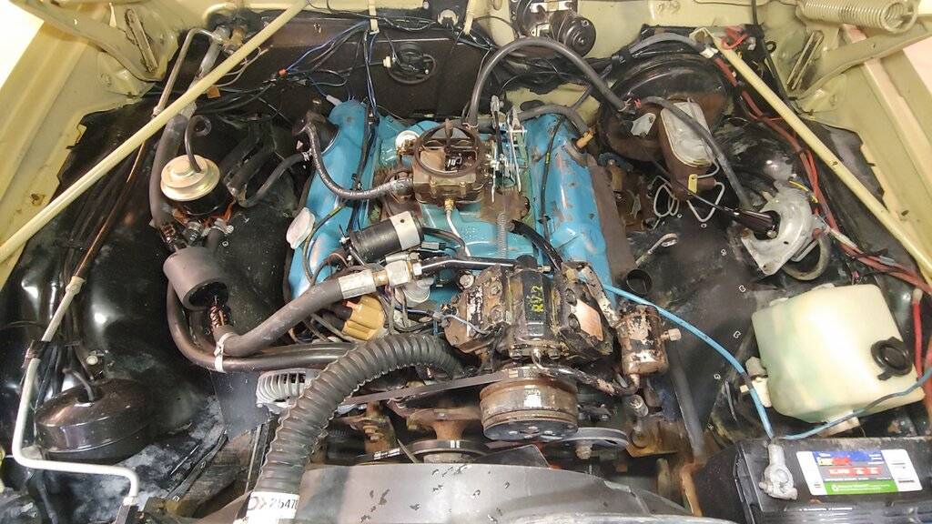

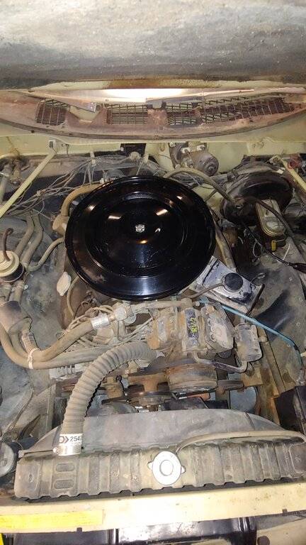

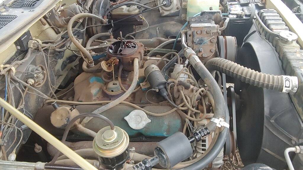

A few before and after pictures.
This is the first round of cleaning and it is not complete. Only the top so far. Will get to the bottom of the car later.
Very dirty car. No one had ever detailed the engine bay in my opinion.
There are so many paint dobs and factory doodles that I am surprised.
Guess I'm used to hooptie's that have been touched by a jack *** far too many times. This car is a time capsule.

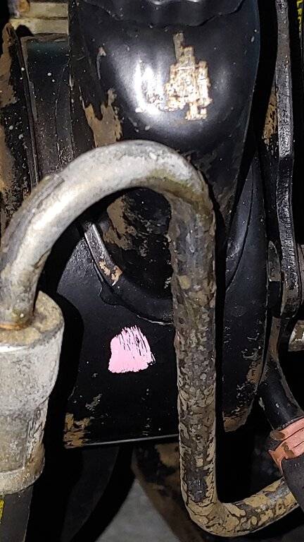

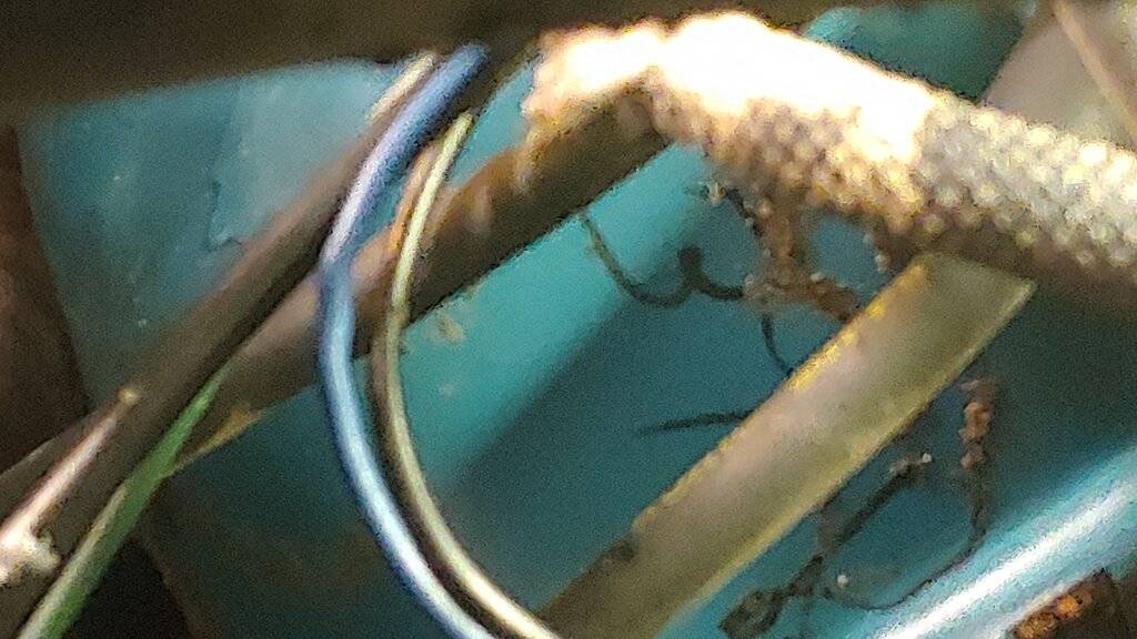

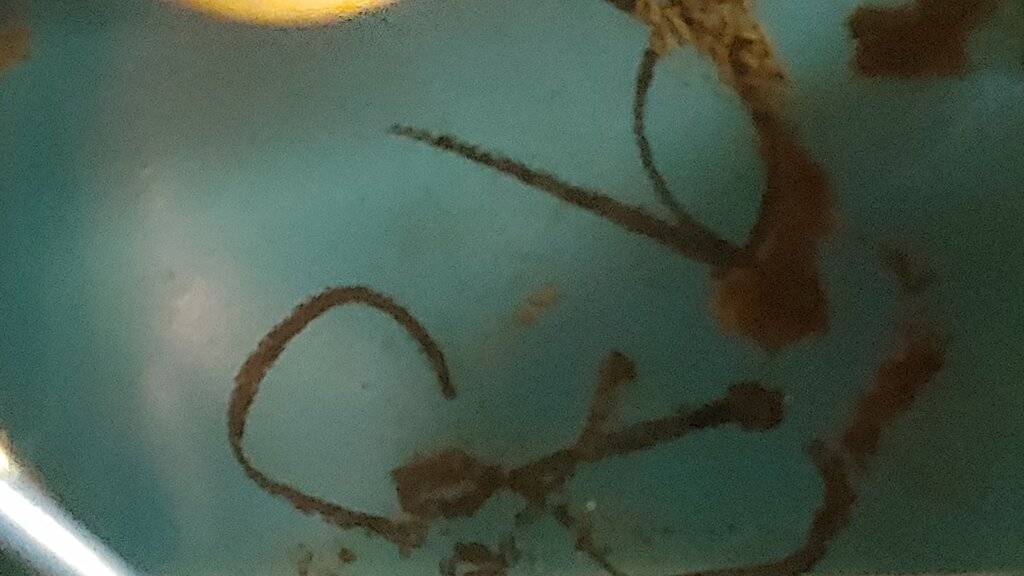

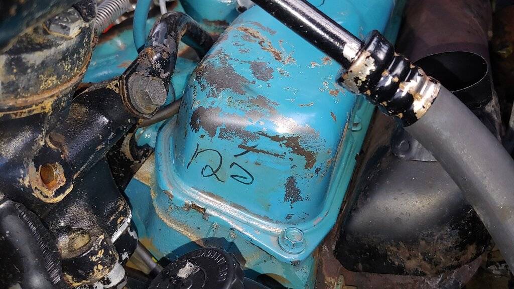

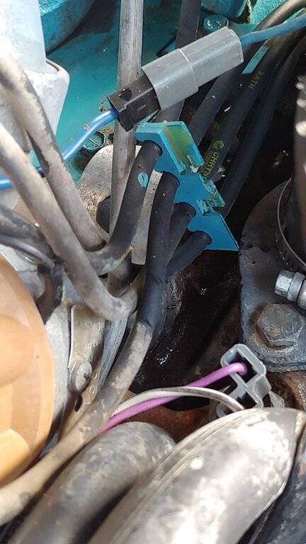

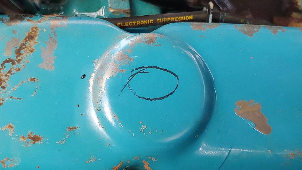

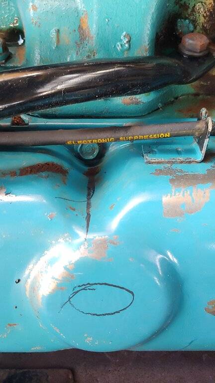

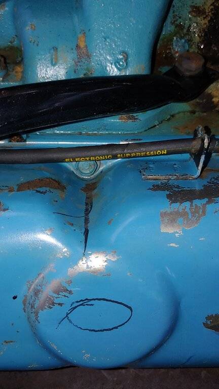

Here are a few doodles and paint dobs just to show some of them.
I don't think anything has ever come out of this engine bay.
Drivers valve cover has a circle, a 120 or 125 and behind the circle there is a line going straight down to the valve cover bolt.

Oh damn, that cleaned up real nice!
Well, sitting in a garage since 84 in Kansas puts a ton of dirt on top of anything that has oil on it.
I used a purple power soak that I applied twice.
Power washed.
Then I applied a double coat of simple green. Yellow kind.
Then power washed specific areas.
Very simple to start.
Next I will detail everything with lacquer thinner to make sure there is no dirt on anything.
Then I usually use a rubber protectant of some sorts and apply it by hand to all rubber in engine bay, then I take a cloth and buff the protectant off of the rubber pieces so it is not shiney or oily.
Anyone have any information about the 125 and 389 on the valve covers?
The circle and line obviously had something to do with the bolt, gasket or seal in that area.
I apply degreaser's with a spray bottle that foams the products. Seems to work better than a windex style sprayer.
This time I used a george foreman concentrate grill cleaner. It foams the product for the grills that it is used for. Works great.
Gotta be careful with the power washer though. It does erase some markings. I lost a few hose numbers when I wasn't paying enough attention.
It will also blow off black paint from fittings and black brackets.
I lost a little green off of some of one of the carburetor brackets. Didn't lose the green on the springs as I tried my best not to lose that green color.
Be careful with that stuff....it will remove paint and is not a good degreaser anyway (too volatile). I recommend mineral spirits or wd-40 for final spot cleaning grease.
The other methods used with the purple degreaser, grill gleaner, and power washer are very harsh and I would not use them if hoping to preserve any original finishes. However, your engine is very clean and prepped if you plan on repainting everything. It looks nice.

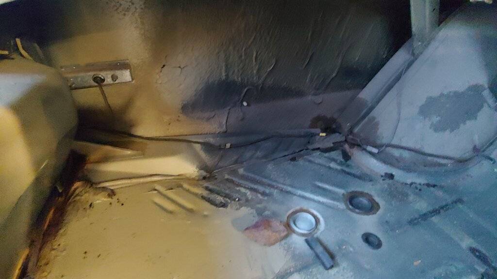

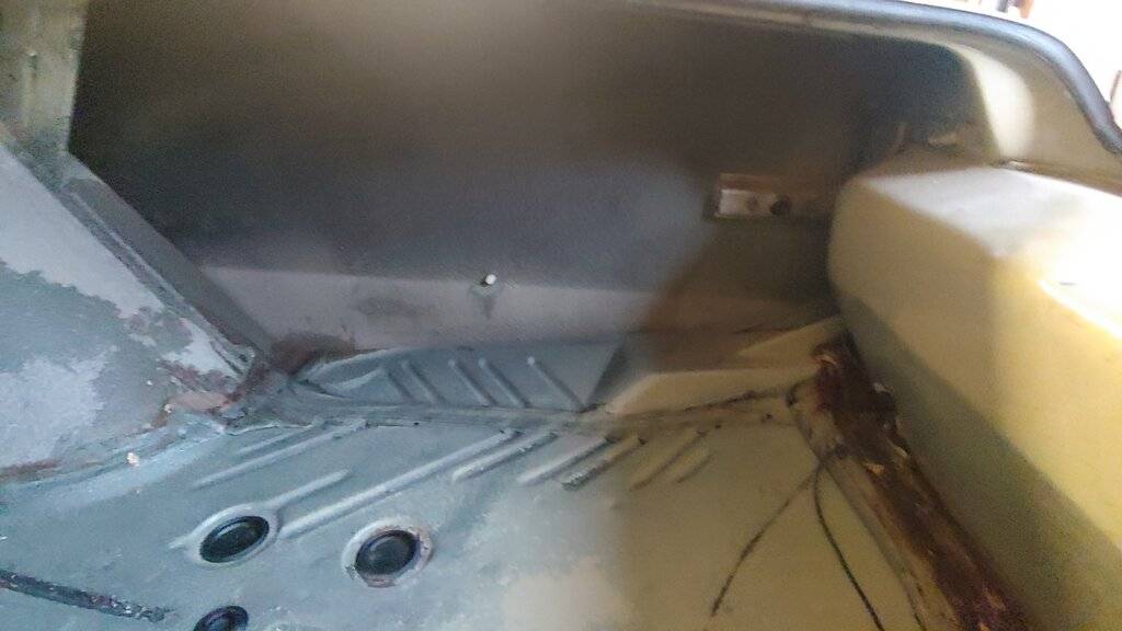

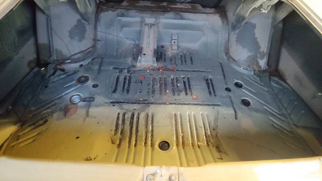

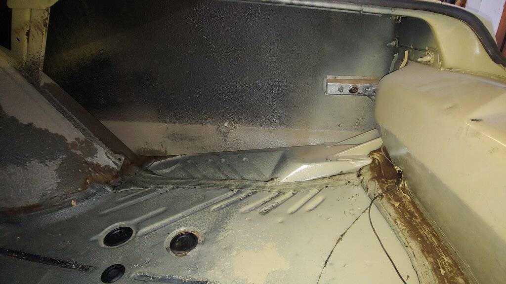

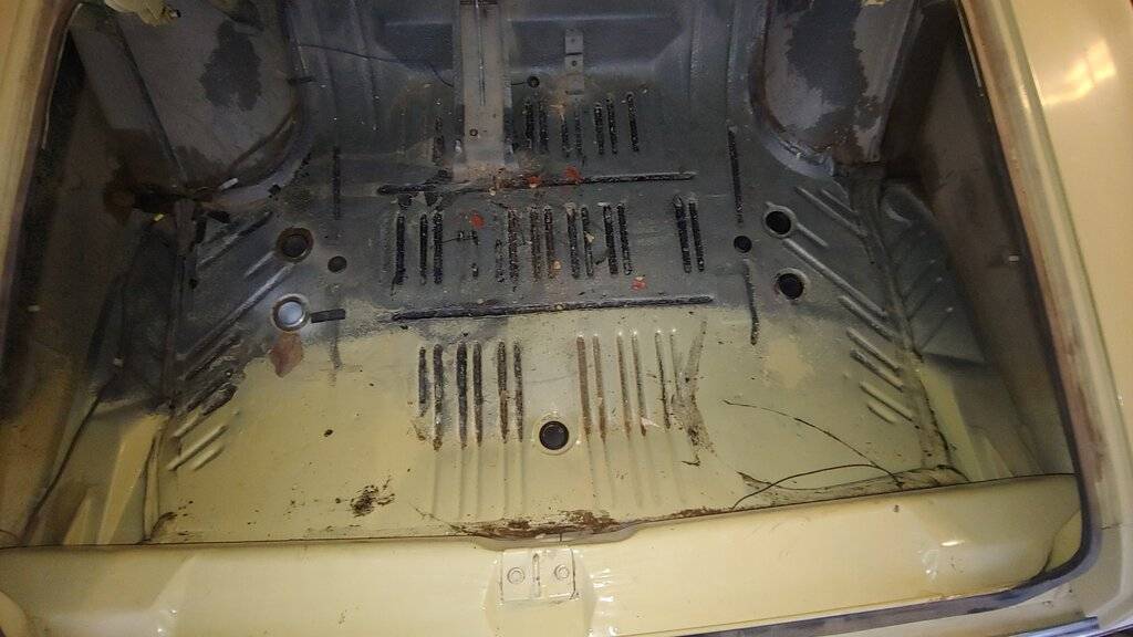

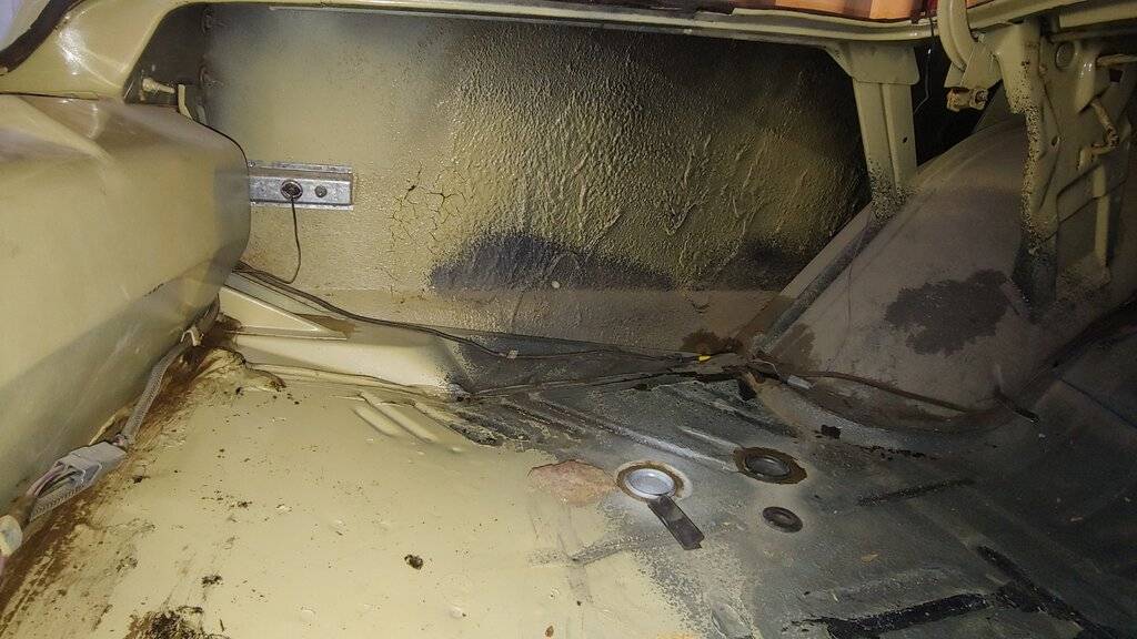

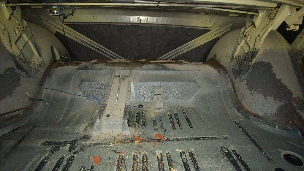

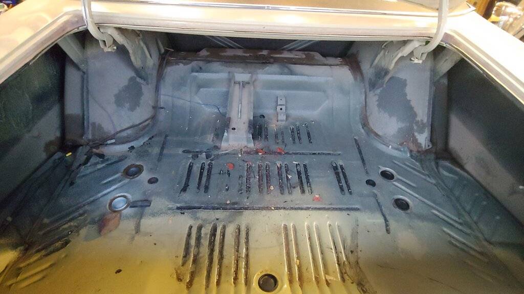

Here are a few reference pictures of the trunk. Not cleaned yet. It appears the factory put seam sealer on each little dip in the middle of the trunk.
This is an untouched trunk. No work has ever been done to it as I can tell.
I still have to clean it up as it is very dirty.
And there are oil spots on the wheel wells for some reason. Dirt on all the seam sealer. Not a spec of rust.
Looking at the pictures I now realize the oil on the wheel wells is from the grease on the trunk hinges. Must have gotten hot and ran down the supports onto the wheel wells.
It will be cleaned.
