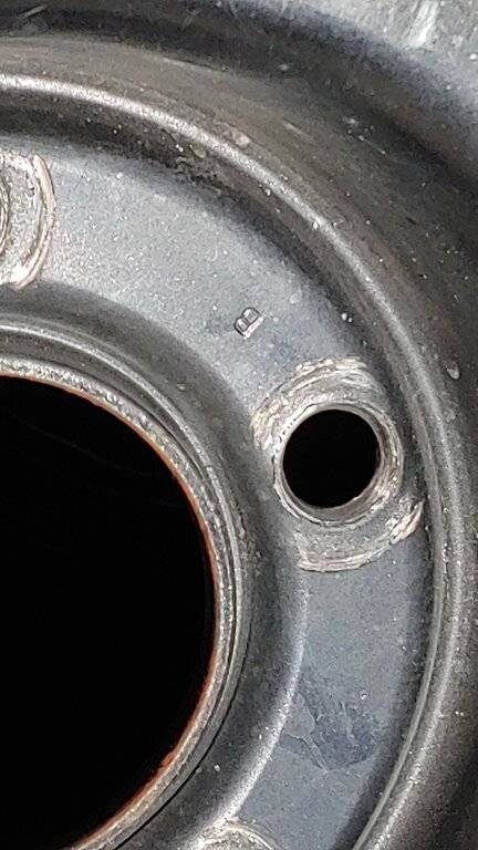

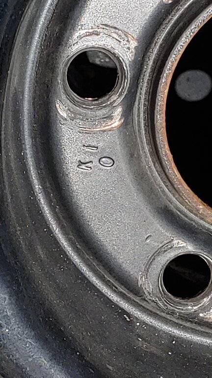

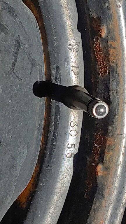

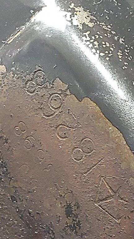

All five rims have matching stamps
B
K 1
0
K2
0
12
3055

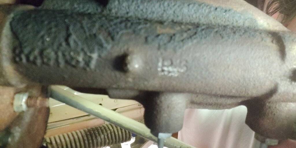

Anyone care to break that down for me?

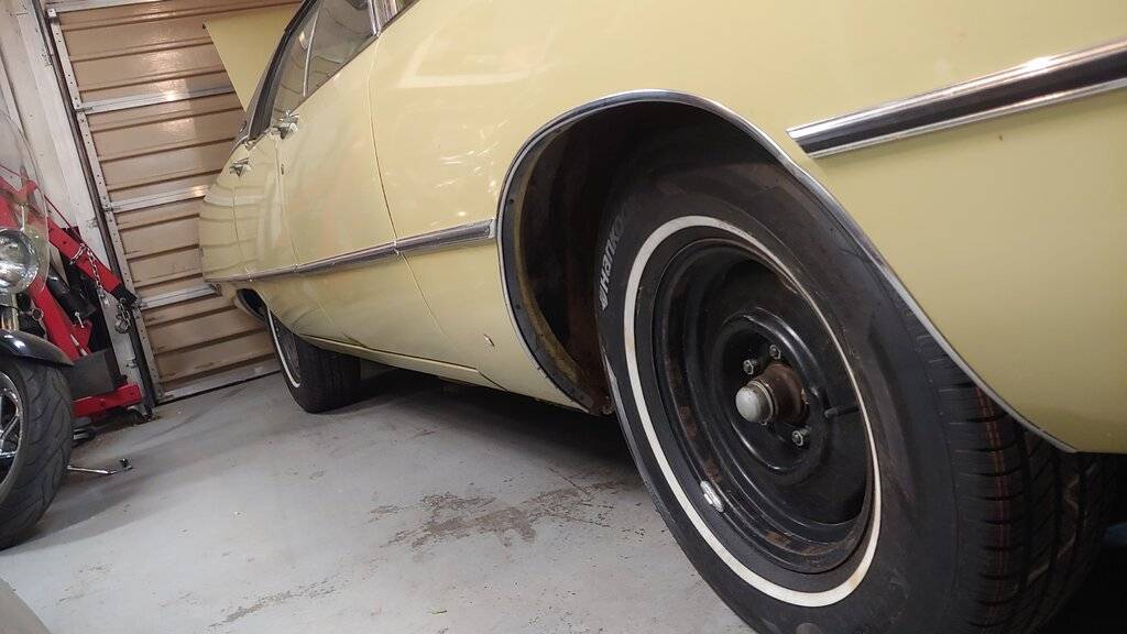

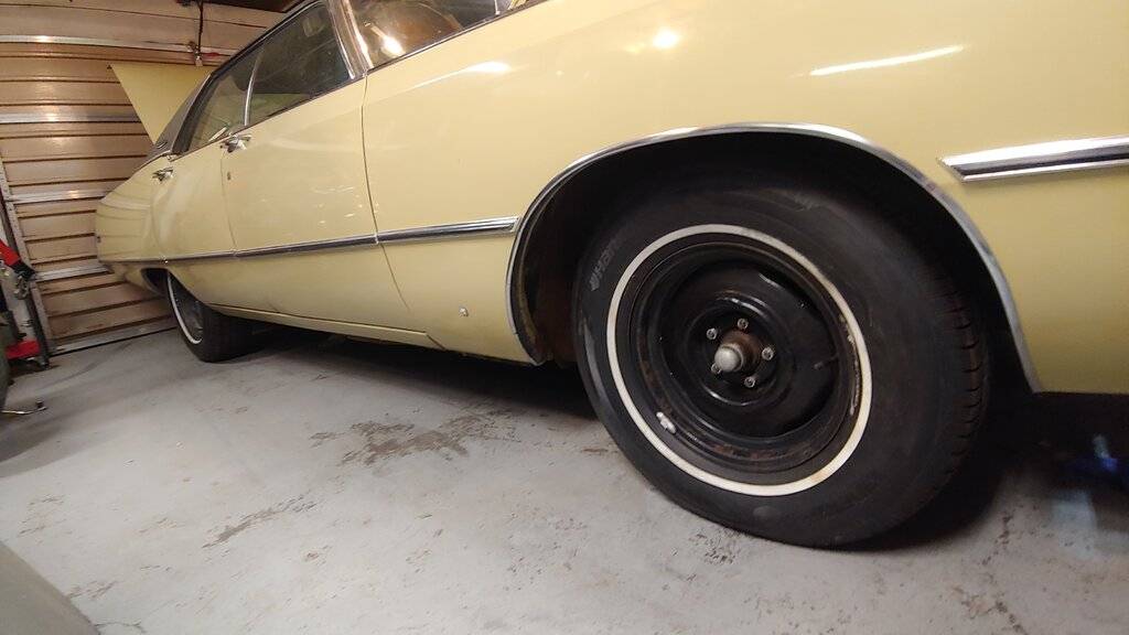

The car is finally getting some Hancook Optimo H735 Kinergy ST's tomorrow.

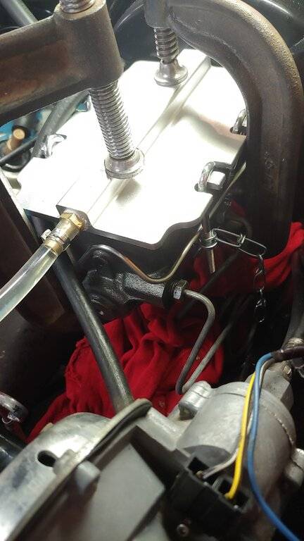

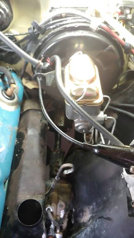

Then I am installing a remanufactured master cylinder so I can take the original master cylinder off of the car for a rebuild. I'm hopfully getting a rebuild kit from @mobileparts if he has any left. I might get lucky enough for the last one.
At least this way I can drive the car and maybe put it in my local show this summer.
Obviously the original is going back on the car.

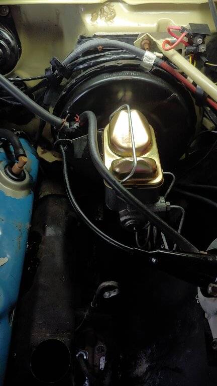

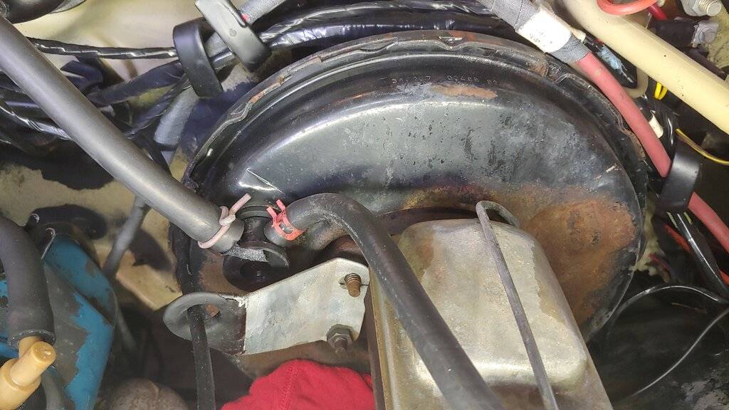

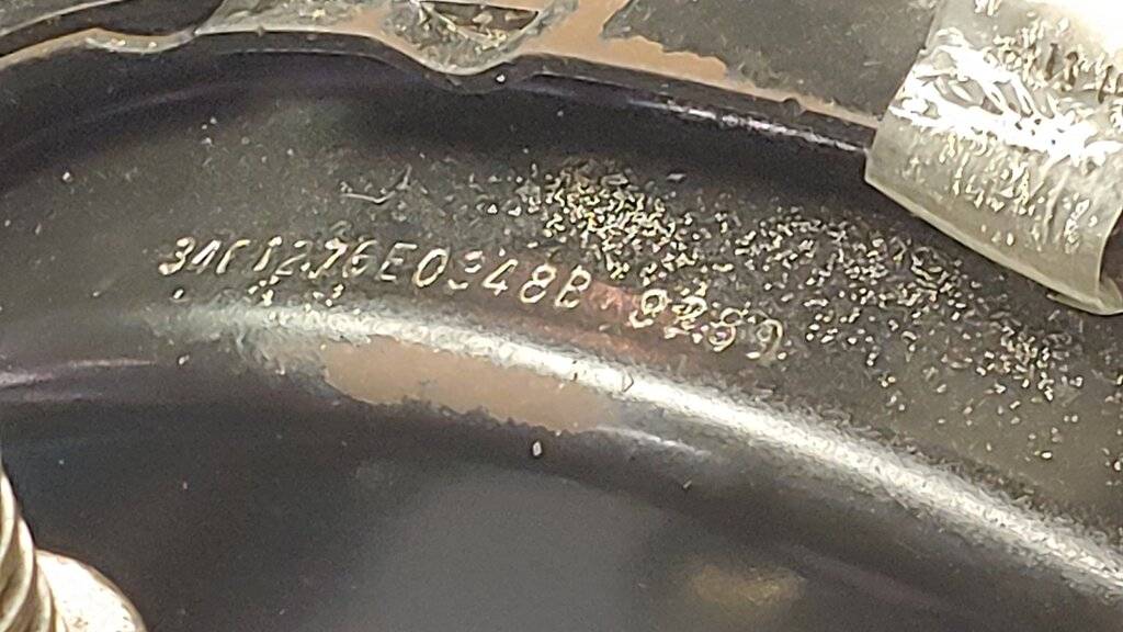

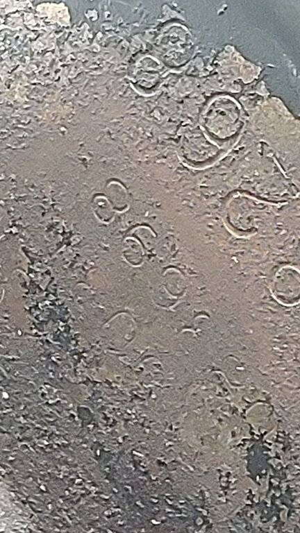

Can anyone confirm the originality of the power booster?

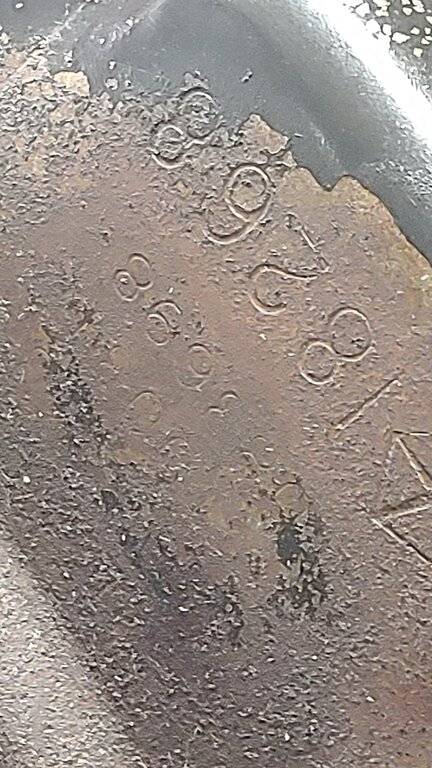

That's a lot of numbers, are there unreadable numbers there?
New tires on.

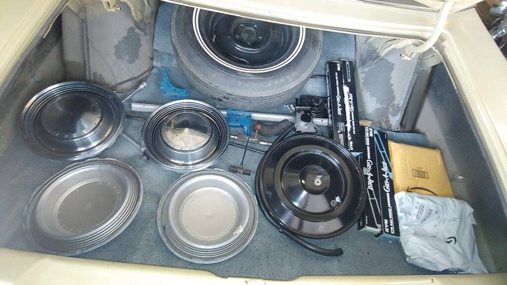

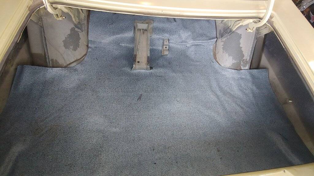

Trunk emptied but not detailed yet.
Parts put in trunk for storage.

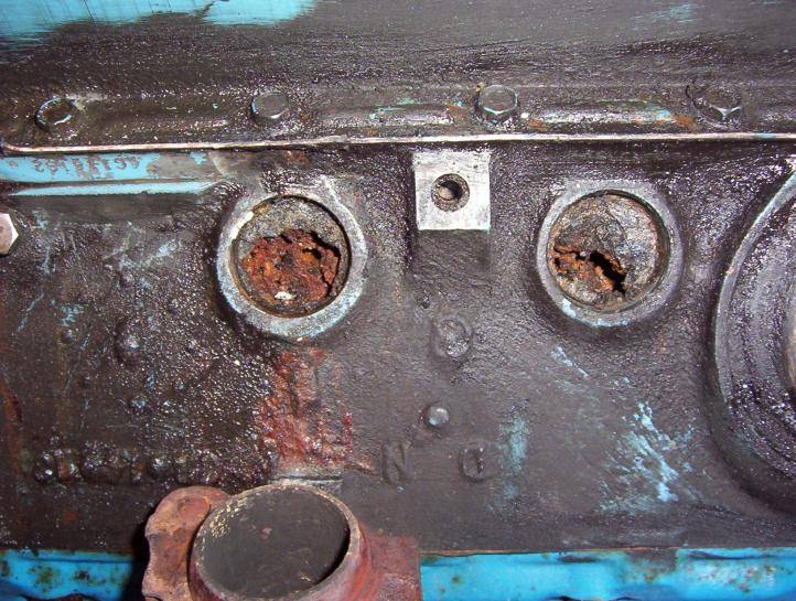

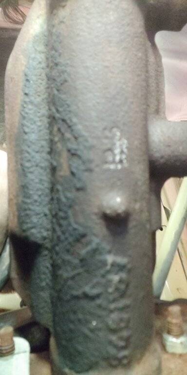

Rotting frost (freeze) plugs are often an indicator that things have silted up. Frost plugs are along in the engine castings (heads/ block). Look just above the oil pan flange...see pic (note the engine is upside down in the pic).
OH, of course, freeze plugs. duh. I'll look, but with everything being super clean and no rust on anything I doubt there will be any rust, but I will check for sure.

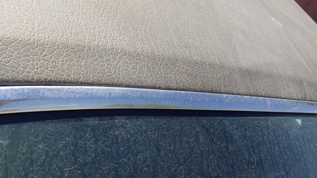

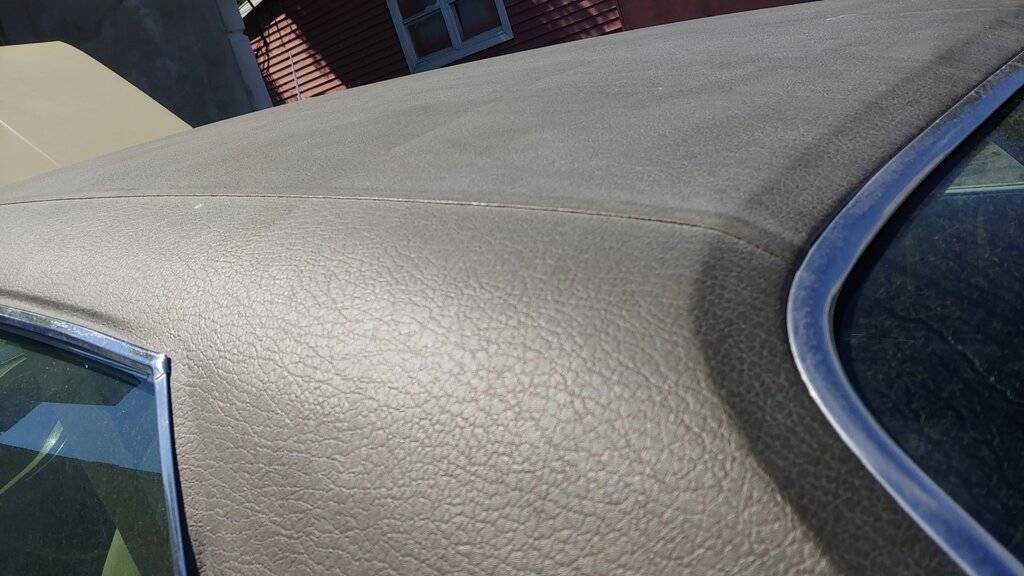

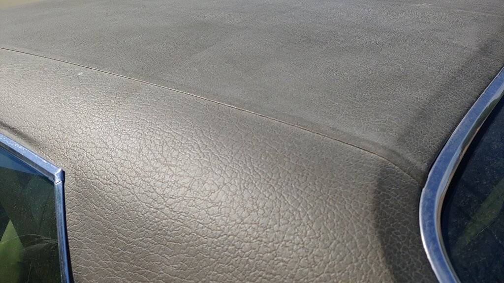

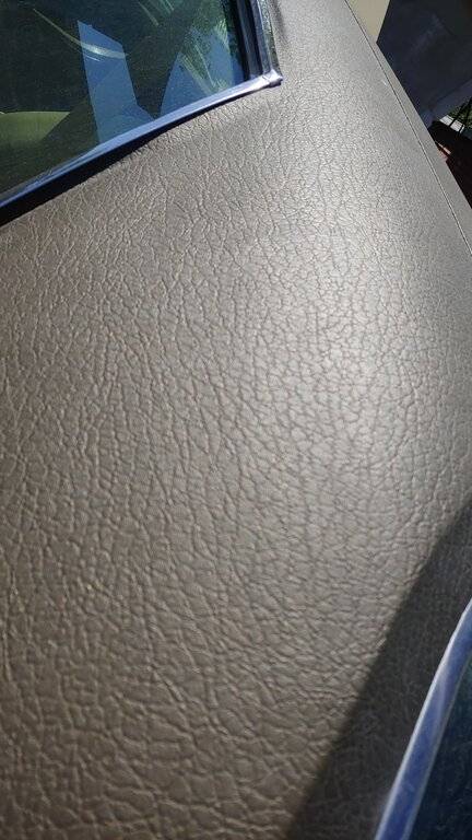

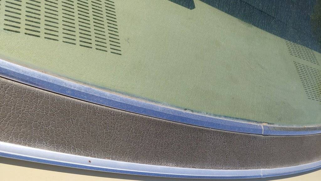

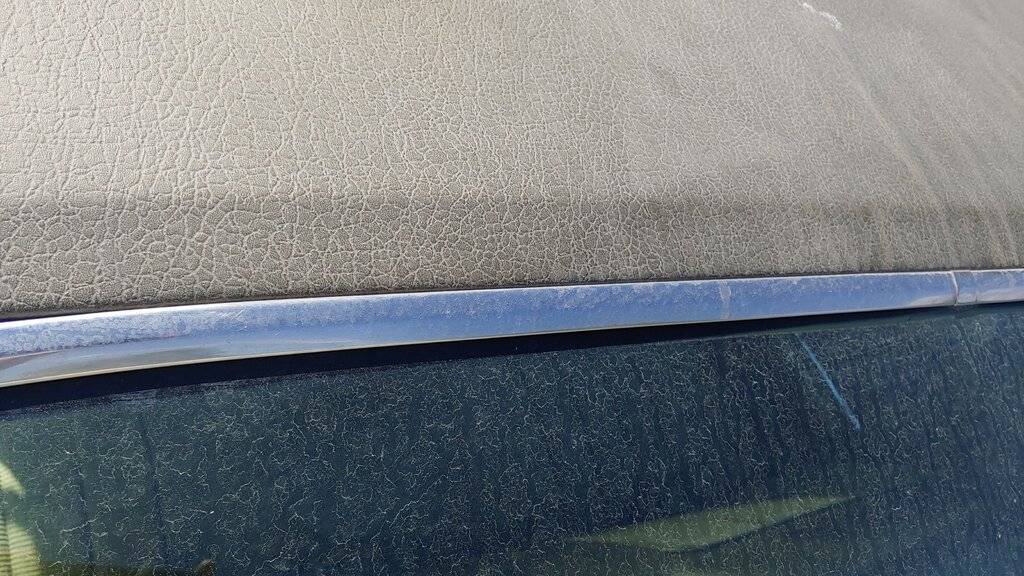

I just wanted to post a few pictures of the vinyl roof. This vinyl is uncleaned with the exception of the grandson who I believe power washed it once according to a few really clean swirls on the vinyl. In the garage for many years. It has yet to be cleaned, but I have the products to clean it, just not the time yet. It's out of the sun though.
I will post updated pictures when I eventually clean it.
