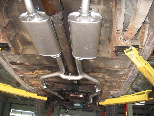

Is the stock/original pipe diameter 2.5"? The shop that did these mufflers used inlet and outlet size of 2.25"
Also the length of the above mentioned Walker mufflers is 29" and I see the muffler shop installed a long length of pipe from these 13" units to the original pipe. I guess this means the original mufflers were in the 29" length range???

Original size is 2 1/4".
Chances are that muffler was a generic piece out of their stockroom.

Yes I am looking at the number you mentioned. These have an inlet and outlet of of 2.5". Did you use some adapters to neck down the pipes? I am ready to order a set of mufflers but I would like to make the installation with a minimum of complications. I don't necessarily call using adapters a complication other than if they are not on hand IYKWIM.
I am leaning toward a set of walkers that are shorter but the ones I see are actually more $ than the longer ones. Supply and demand issue I imagine. The 18381 are probably much more widely used and therefor less $.
Measure what is actually under your car and order to fit that. Looks like a 2.25" single inlet/outlet is part number 18230.

Don't match mine, I have 2.5" pipes on that car...
Thanks for doing the legwork,@bajajoaquin . @challenger ... it it pretty easy to measure what space you have and existing pipe diameters if you are saving good pipes... don't buy too short or you'll be patching in a length of pipe from pepboys... if you find something a bit longer than what you have, make certain the pipe is straight where you need to trim.

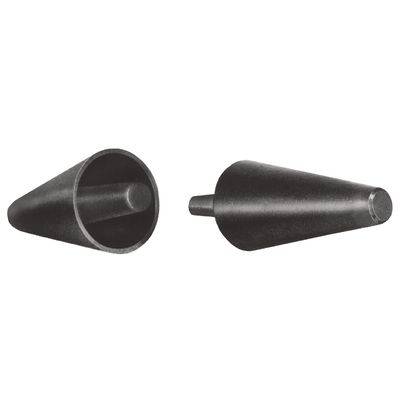

I have 2 tools from my shop days that make exhaust so much easier to deal with...
this one helps undo the deformation caused by the stock type clamps.
this one helps flare the end of the pipe a little in or out to make fitting easier... I still damn near killed myself doing this work on a pair of ramps... I'm too old and fat for this crap anymore.

I measured mine and the pipes are 2-1/4" in and out. The mufflers I get will need to be longer than what'sin it now. The only issue is tthe left side outlet is right up against a bend so I'll need to grind off the weld in order to save the piece of straight section currently going into the blown up muffler.
I will look for a local muffler shop before doing this myself. I don't have a lift so removing the weld bead will be a hassle. Truthfull I don't like others ddoingwork
