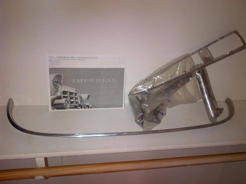

I understand your caution... I've heard the stories myself. But I figured if I'm there in-person, lay my hands on the parts, pay cash and walk out with them myself, the risk should be low. Mostly I'm sorry I never stopped out there earlier, because he was down to just a handful of cars after having several dozen on his property. Let's put it this way; he's a colorful character. Yes, some of the prices were pretty high for his top-quality stuff, but we were able to come to terms for some mid-grade stainless parts that I'll rework into something better. Here was my haul back to Detroit:
Above includes a good RR wheel lip molding, ($75) Tail lamp bezel ($50), nice driver's door handle ($100), aluminum bumper insert, ($50) and a RT bumper outline molding (technically thrown in for free because it was damaged, but still better than my smashed-up junk). On his honor, he's supposed to send me that little chrome rectangle that goes behind the hood ornament for the last $25 I gave him. The prices aren't give aways, but these cars/parts aren't exactly falling out of trees.

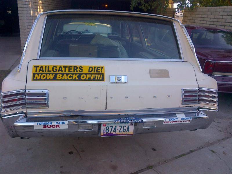

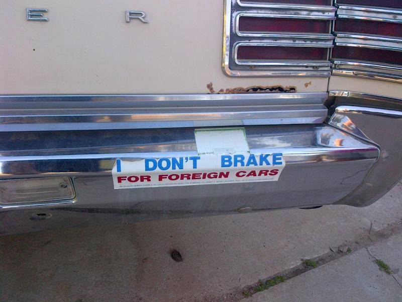

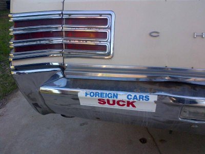

I think you just have to deal with him in person. I could see how his unusual manner could be off-putting over the phone. It probably helped that I agreed with the sentiment expressed on the back of his daily-driver. I don't think you could drive this around Phoenix and not be "colorful", lol

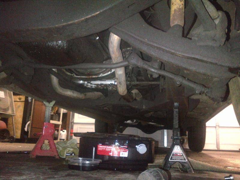

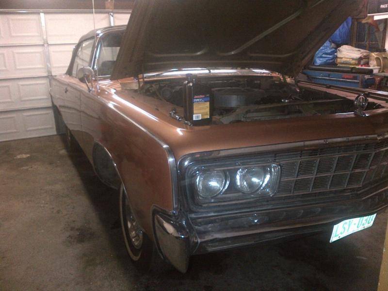

So yesterday, I finally retrieved my car from the warehouse. After driving it about 30 feet, I knew the trans wasn't working correctly. (I needed to move it towards better lighting to look it over.) After pulling the dipstick, my fear was confirmed, the fluid smelled like poo and was brown rather than red. I still bought the car, but had it trucked home. I just dropped the pan and the blood-letting began. I'm hoping it was a good sign that the converter drain landed at 6 o'clock so no under-car cranking required!
Then I noticed something I'd never seen/noticed before... There is a piece of linkage sticking out of the floorpan, pretty much where the accel pedal would be located. However, it's just a rod with the bell-crank ball sticking out. It's not connected to anything. This can't be throttle linkage because the accel pedal functions normally, so I figure this must be the kickdown. Also makes sense because no kickdown would burn up the trans. (I didn't investigate further yet... Just wanted to shower the burned trans fluid out of my eyes and hair.)
But now I'm thinking this might be a one-year-only part because the '65 TF was cable operated, '66 was the last year before the Imperial was completely redesigned. So my question is, "Was this kickdown linkage a one-year Imperial-only design, or was this used across multiple years/models?"
Anybody know where I could find a photo/drawing of this part? I'll either have to fab it or find it.
