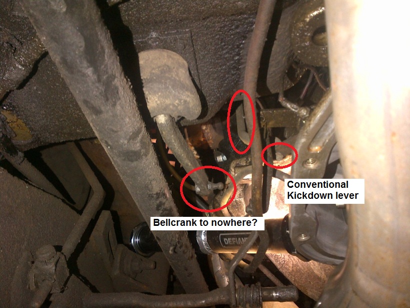

Im not so sure what to think of that prat poking through close to the accelerator. But I am interested to learn.
This is a great car. I cant wait to see its evolution
I think with my eyes filled with burnt transfluid (my happy-place), I only noticed the bellcrank connected to nothing. I should have noticed there is a later-style kickdown that is intact and functional. A '64 uses push-buttons, '65 uses a shiftlever and cable, '66 uses rods/linkage. Somebody in Highland Park must have said "Meh, we're only running this body for another year, let's just leave the accel pedal a carryover part."
*** I also posted this question over on Moparts and somebody mentioned the old Auto-Pilots (cruise) used this accel bellcrank to connect the servo. Turns out my car does have cruise, but is missing the servo linkage ***
So the good news is, I don't have to hunt anything down. The "unknown" is if adjusting the band and fresh fluid will do the trick.

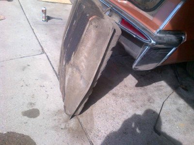

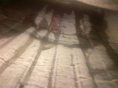

Also dropped the gas tank since I was already up in the air...
Tough to see here, but it also had a huge dent in it. I managed to pound most of it out using a "spud bar" from my concrete-pouring hobby (If you're Italian, they had you a trowel at birth).

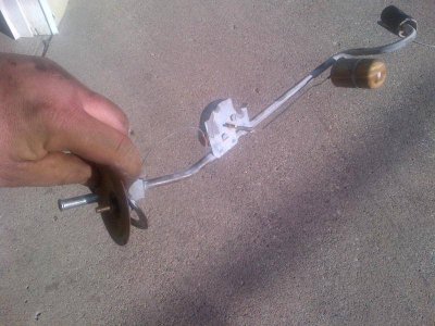

The tank and sending unit were amazingly clean. Per my ohmmeter, it functions. Haven't had enough gas in it yet to tell if it really works.

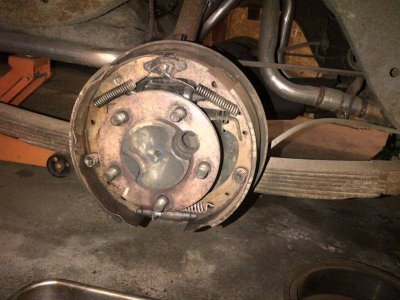

Pulled drums (I should say "pounded on drums with a hammer") and found them full of new parts and way too damn tight... Trans issue anyone? *I do know you can back off the adjusters from behind, but I can never get that to work. Also changed the oil (filthy).
I was outside until 11pm swapping tires and topping off fluids. I couldn't go to bed until I knew if the trans was going to live. I was about to go to bed disappointed, but it seemed like the last quart I poured in made a huge difference and it began engaging normally. Now I'm off to the corner gas station for a road test. Cross fingers!

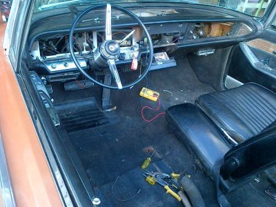

2) When I bought the car, the brake lights, turn signals, were all inop. Only the headlights and dim tail lights were functional. About 1/2 the dash lights worked.
So I probed for voltage at the trunk wiring disconnects and found they did have voltage. Thus began the process of removing the lights, finding corrosion in the sockets and repairing them. Or in the case of the outer single-filament bulbs, simply fining them beyond hope and replacing them with part-store sockets. I folded the metal tabs over within the die cast housing and made them stronger/weather tight using some good ol' JB weld. I used as much of the old wiring as I could, soldering the wire to the new bulb base then shrink tubing the connection.
Also redid the silver within the housings. Usually I'd use a bright silver spray, but this time tried using metal-foil tape... Thought that might last longer and be even more reflective. Before:
After:
So this left me with a functional brake lights, but no turn signals. No voltage at the wires either. These cars (at least the ones with tilt, but probably all of them before the new column design in '67) used a signal switch at the base, near where the column goes through the firewall. Since I didn't see any evidence of wire-hackery, and because the rebuild process is described on the IML website, I simply took mine apart and cleaned hard grease, polished the brass contacts, and re-lubed with dielectric grease. I debated using this because silicone is an insulator, but then I also thought the contact pressure/movement would be enough to negate this property. All I can tell you is that after putting it back together I had turn signals again. But wait, no dancing bananas yet...:BangHead:
When I'd signal left, the left front signals and left dash indicator flashed... in time with the RIGHT rear signal. There is no way to confuse the wiring at the rear of the car because the wiring simply isn't long enough. So I back probed the turn signal switch and swapped the wiring pin-outs. Thankfully I tried it before remounting it on the column, because taking it in/out is a royal PITA.
As I recall, it was the green and brown wires I needed to swap (the center block of two). Of course, this makes you wonder if this was a 50-year old factory defect (how could that go unnoticed?) or did somebody do this as a gag to drive a mechanic nuts? One X factor is the obvious former presence of a trailer hitch. Perhaps this was a work-around to correct bad trailer wiring?
