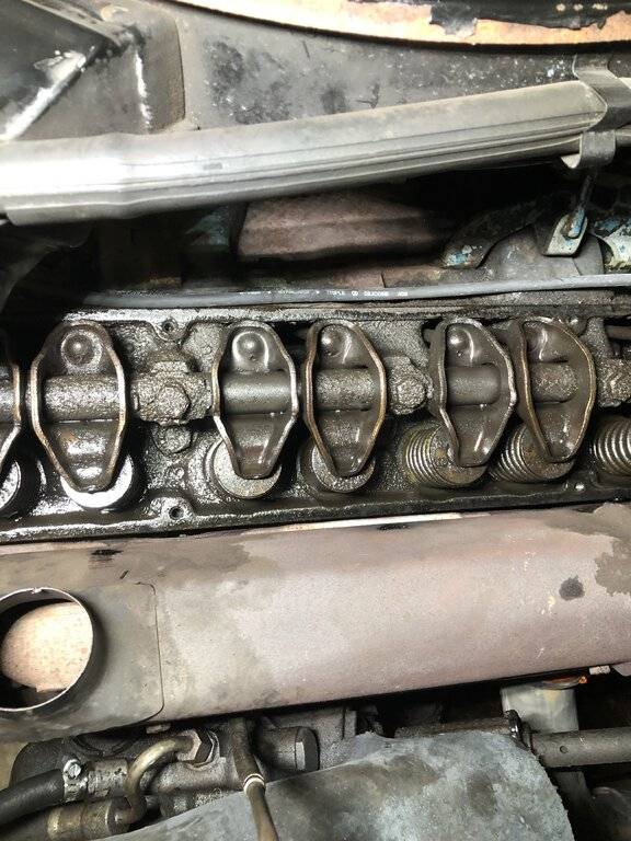

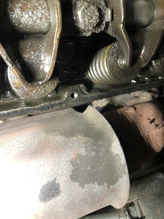

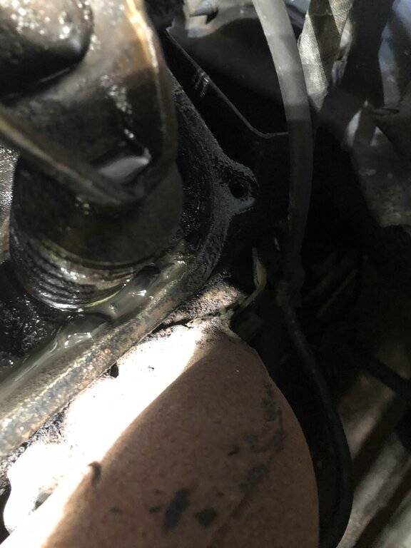

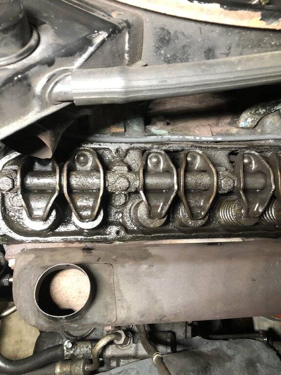

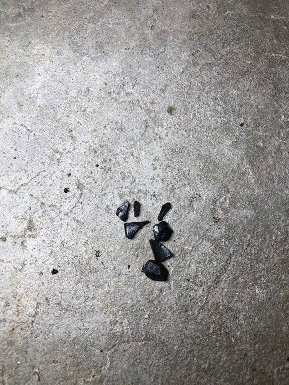

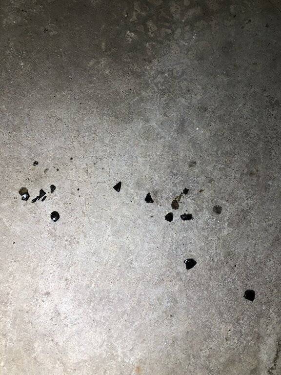

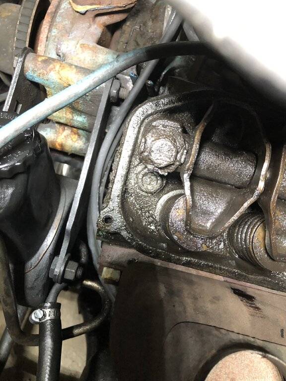

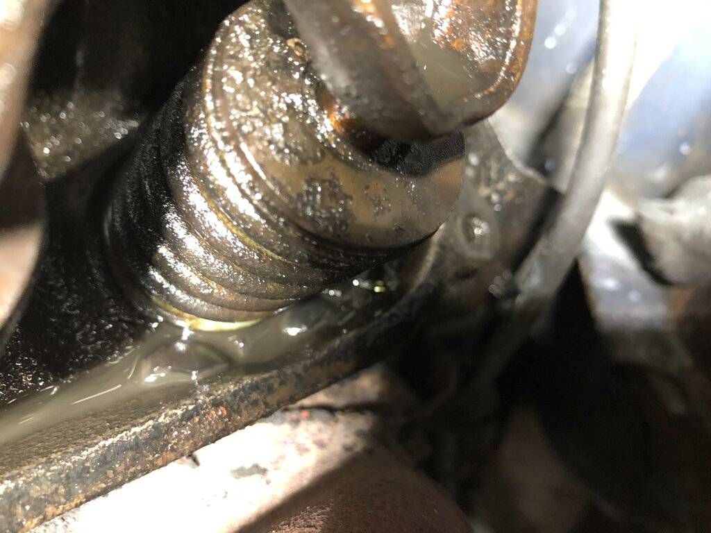

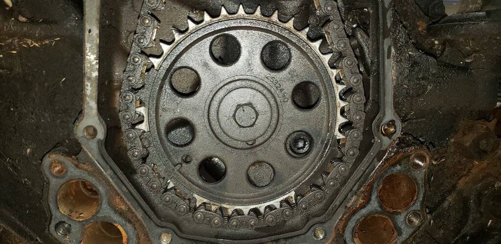

Went to change the valve cover gaskets tonite because the drivers side was leaking. When I pulled the drivers side valve cover off I found these plastic pieces on top of the head. Mostly at the bottom left and bottom right of the head. Look at the pics and u can see. Feels like plastic and it’s not magnetic. Am I correct in this is the plastic timing gear has broken loose? Car has been running fine etc.... just went to change the gaskets. Also I had already taken the broken pieces out of the one side. 383-2 barrel.
Either that or the valve seals fell apart.
Probably both.
Time to tear the motor apart.

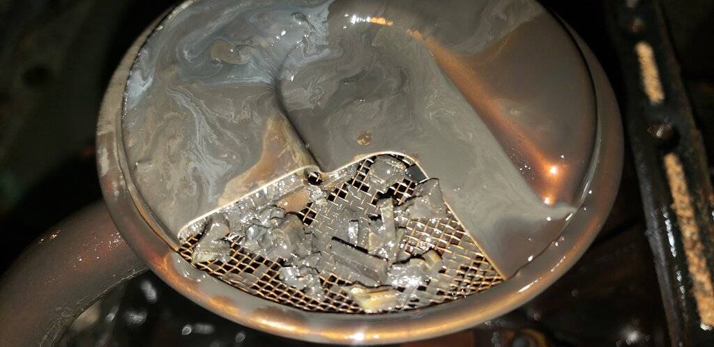

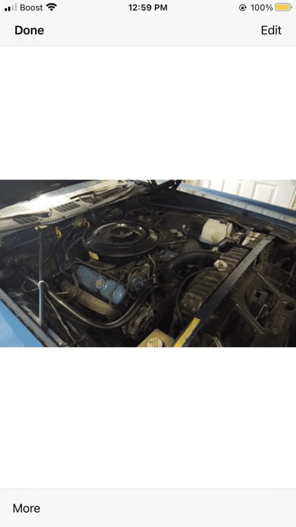

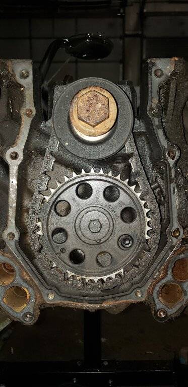

This is my 70 383-2...
The chunks you cant see found a home in the oil pick up...I'm sure of it.
I just thought it could be pieces of the timing gear that circulated up there somehow. Valve stem seals make since there right there.
It was running fine etc.... I just went to change the valve cover gaskets and found that.
It’s only supposed to have 37,000 original miles but it is 50 years old and who knows what kind of maintenance was done to it etc..
I’m assuming my best bet would be to tear the motor down and freshen it up? Obviously needs new valve seals.
And thinks everyone for answering my questions and being helpful. I know a little but not a lot about these cars and your knowledge is very helpful! And I truly appreciate u taking the time to help me out etc...

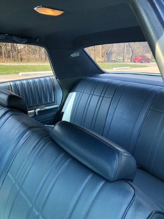

I would agree. Looks nasty. Like I said was supposed to be 37,000 miles but who knows. I do think the car only has that on it- but the motor most not have seen to many oil changes

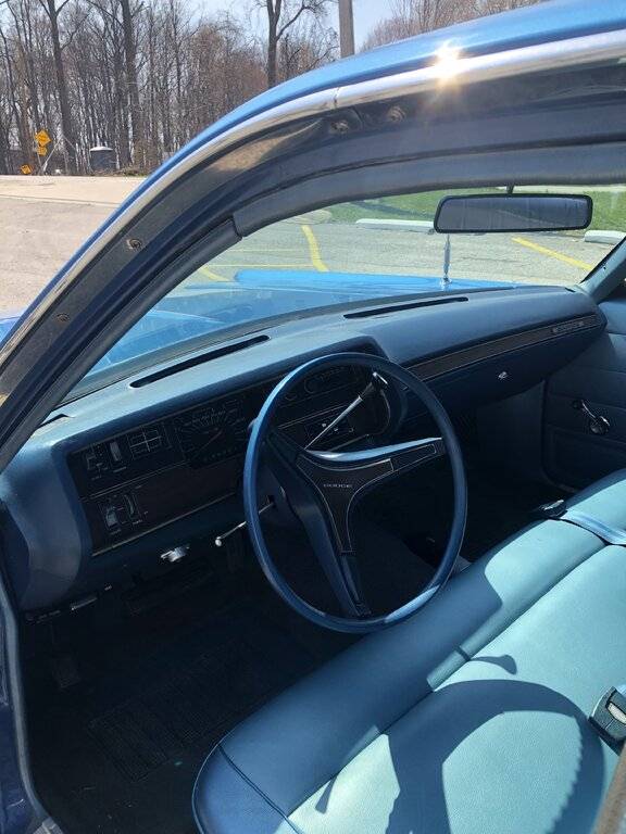

In looking at least the front seat bottom (attachment 450735), it appears it has been redone, which might suggest higher miles. On the other hand, the dash pad looks good, the exhaust manifold intake heat shield is still present and the pretty good looking windshield washer fluid bottle suggest lower miles.
In looking at at least the front seat bottom (attachment 450735), it appears it has been redone, which might suggest higher miles. On the other hand, the dash pad looks good, the exhaust manifold intake heat shield is still present and the pretty good looking windshield washer fluid bottle suggest lower miles.

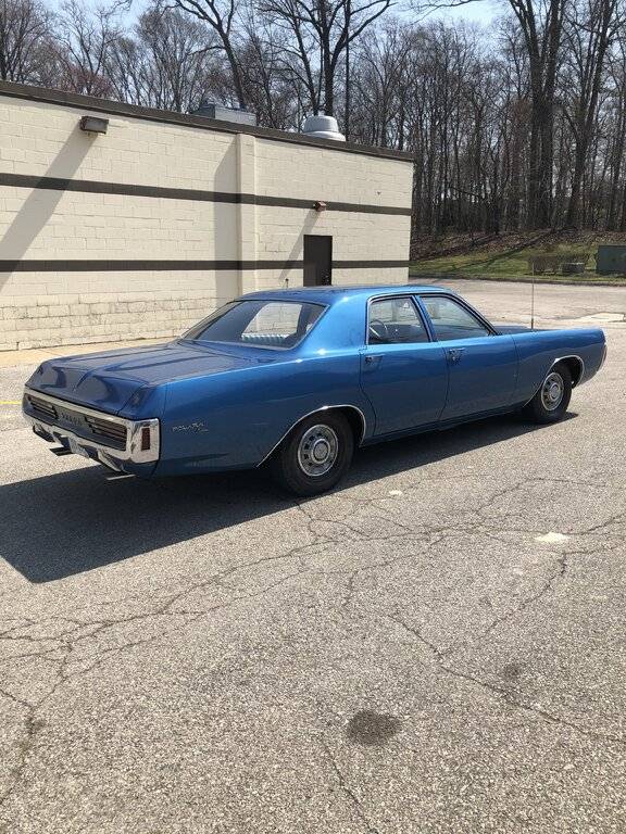

I definitely believe it's low miles. My '71 Polara suffered the same fate, as many low mileage, old car's do, being parked for long periods of time without moving. Hence, the low miles. They present very well, but there is some work to do to get them back up to snuff.
Thanks for the interior photos! I thought that looked too plain to be stock. Although I think some fleet car's had the seamless treatment for ease of cleaning.
Last owner said that the front seat bottom had been redone. He had it redone due to a tear. Don’t know if that was due to high mileage or not. I would think it’s possible that could need redone due to age.
Little update I put the valve covers back on- got what I could see of the pieces of the seals out and. And the oil has stopped leaking. Changed the oil and filter.

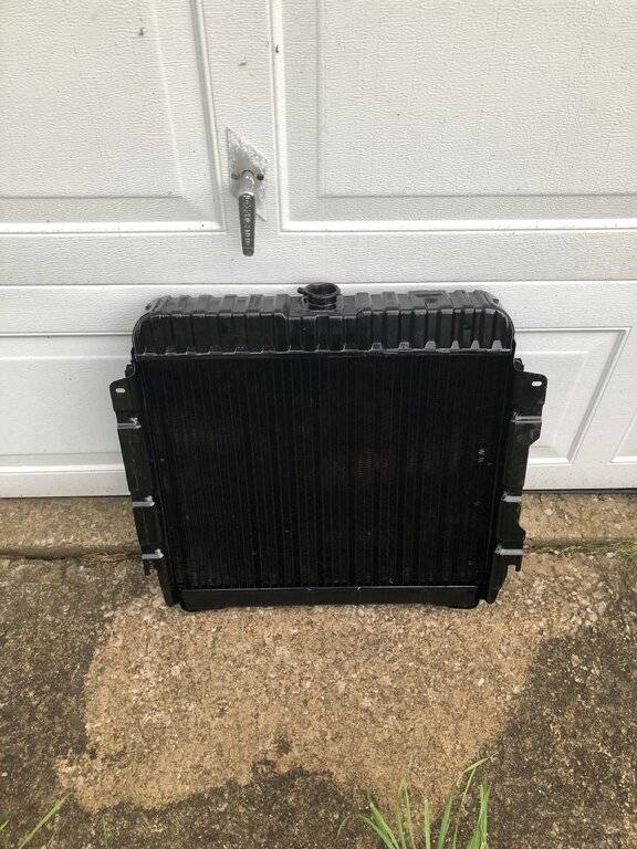

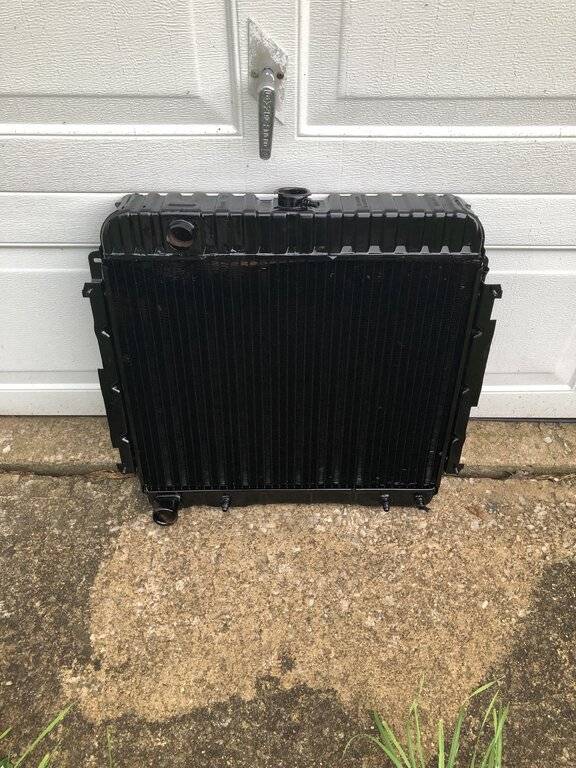

Little update on my Polara got the radiator recored and got it back today. It’s back together and all looks good. Been working a ton so haven’t posted much. Here is a couple pics of the radiator after I picked it up today.
