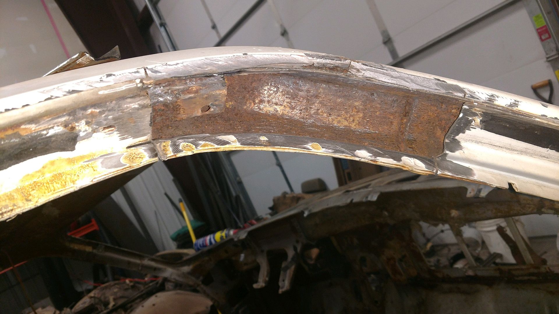

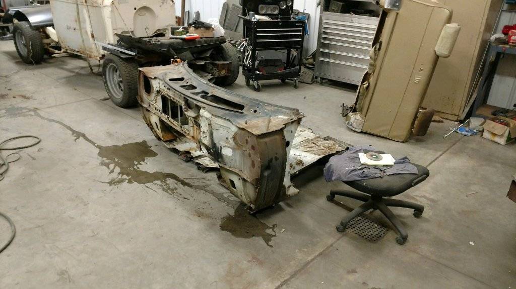

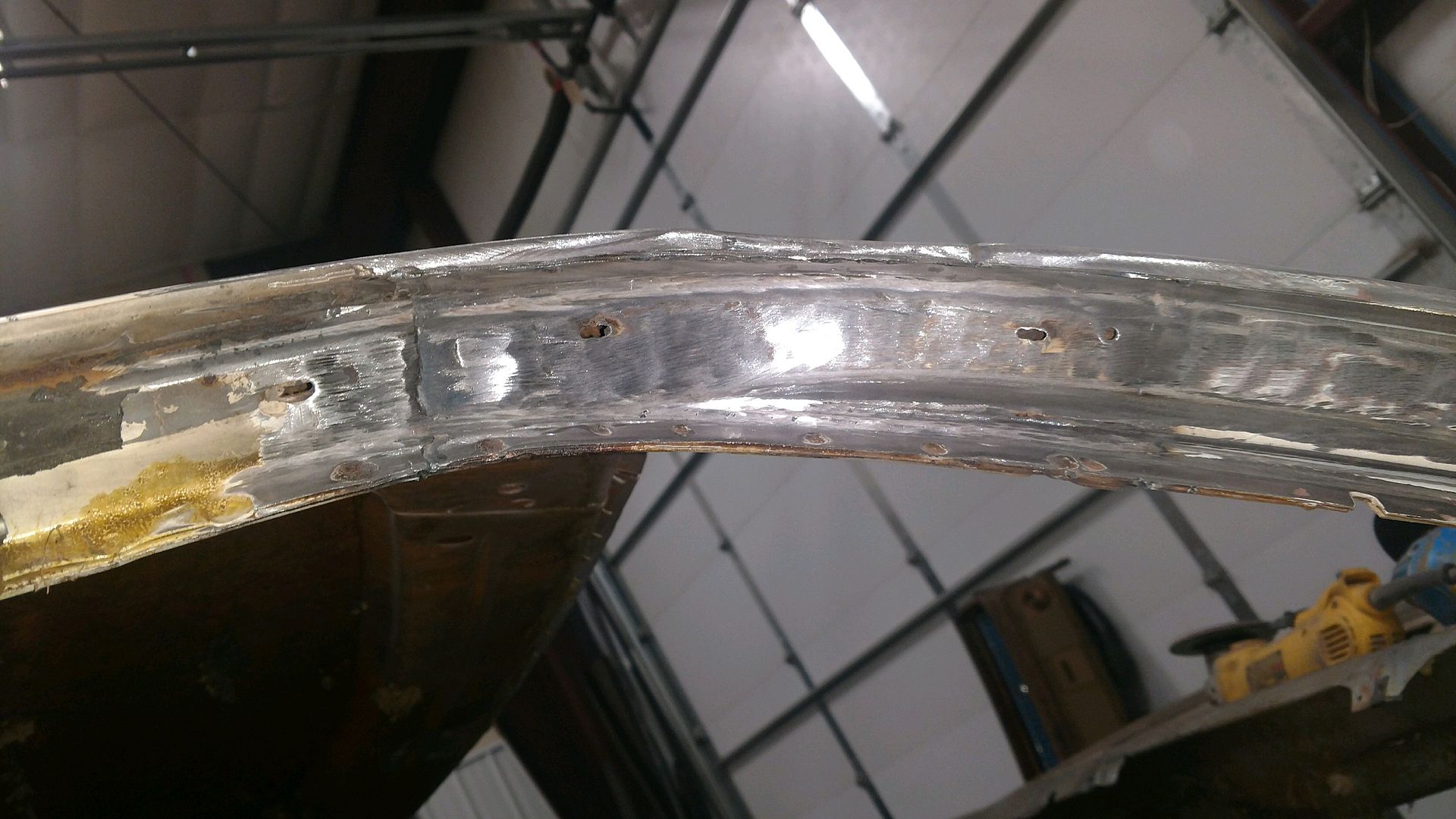

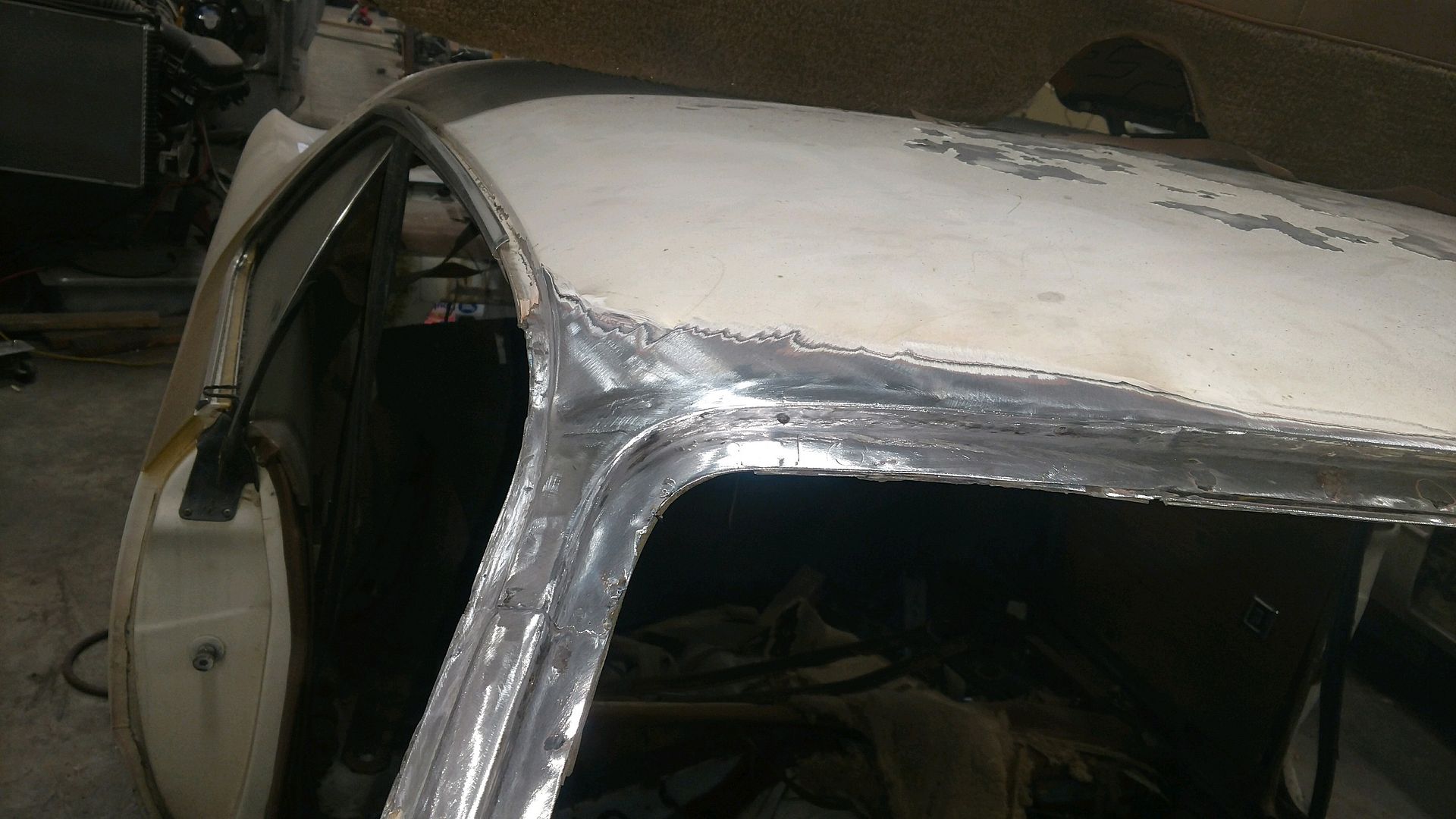

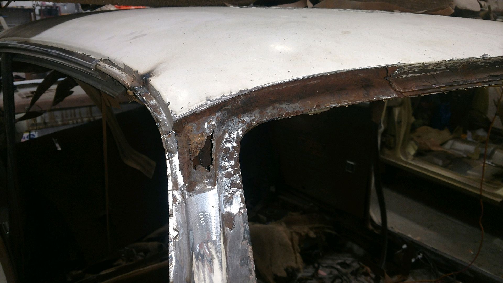

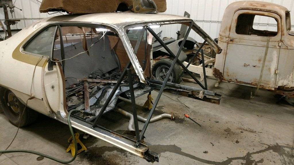

Here are a few from last night repairing sections around front window.

Dang, from the original pic, it didn't look like the Hurst was that bad. Are you swapping the stub frame as well?
Yes that is what we are doing. That is why when you buy a car you need to be careful. A prior owner in the past used a lot of filler, undercoating, etc. and as a result we didn't think it was this bad at the start either but in the end it was really bad off. The car was a Florida car originally and the salt air really harmed it in places you normally wouldn't find rust. Thankfully I had a really good donor car!
