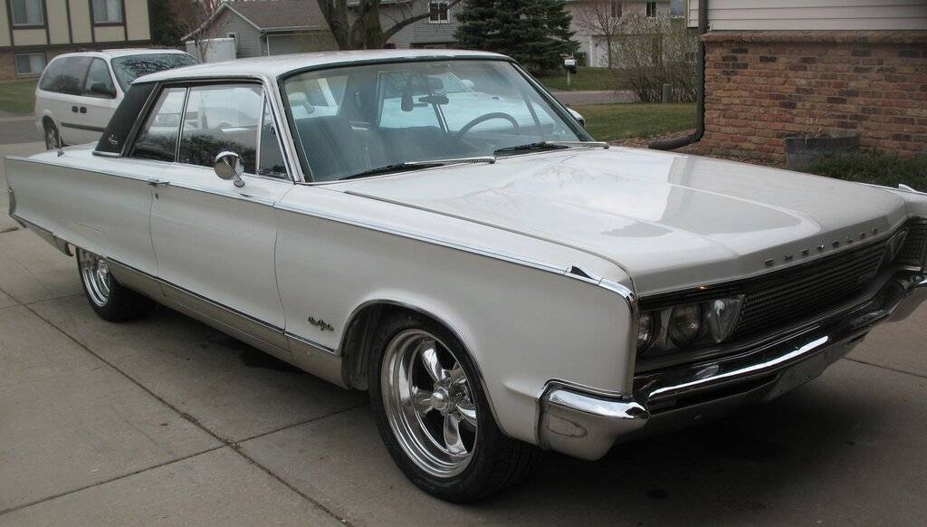

Super clean looking ride. It will be awesome.

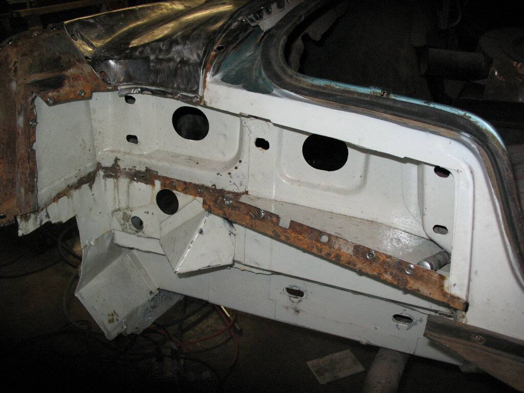

Oh, man, what a sweet 2-door! I think you nailed it with those rims. Rarely do I like aftermarket ones on the old "C"s, but your combination works.You got a lot of work coming. I wouldn't put the shocks or gas tank in right now. No point in putting new parts in to have to take them back out later. Stop by Grainger and get one of their portable sandblasters. It's a small unit that holds about 50 pounds of blasting material. Get an air compressor for it too. Sandblast all that rust away and paint the underside. In the process you will need to weld over some holes and replace those rotten lower quarters. I got a wire welder years ago, works great for this kind of stuff. Might find one on craigs list. A set of metal burrs are needed for cleaning up the welds. An angle grinder is your friend too. Lots of youtube videos on welding patch panels. The underside isn't as critical appearance wise, but you want to stop the rust now. As Neil Young said, rust never sleeps.
