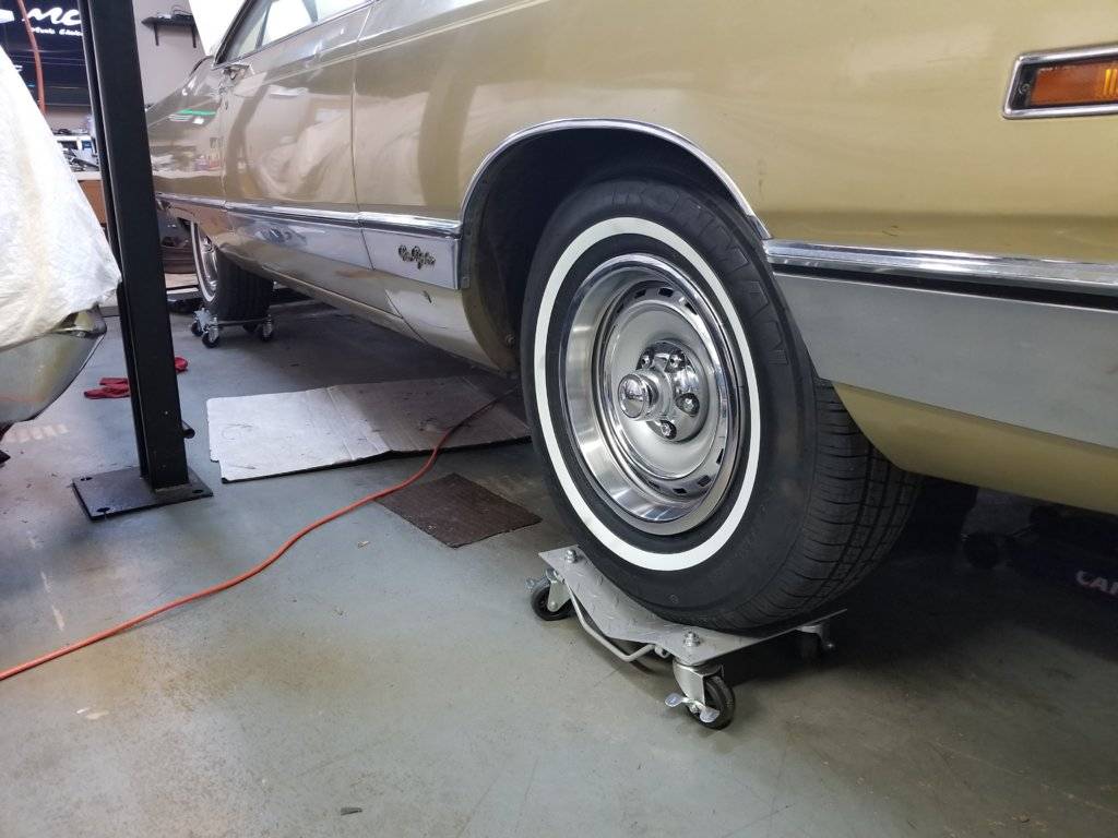

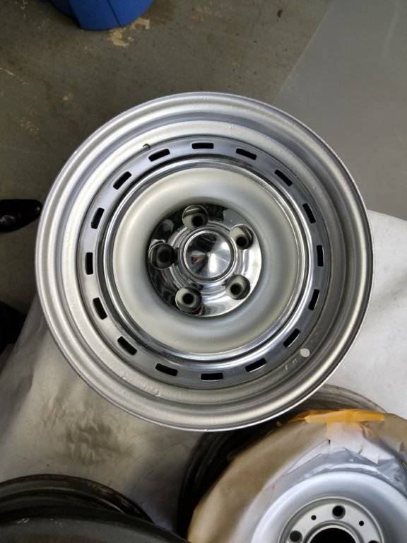

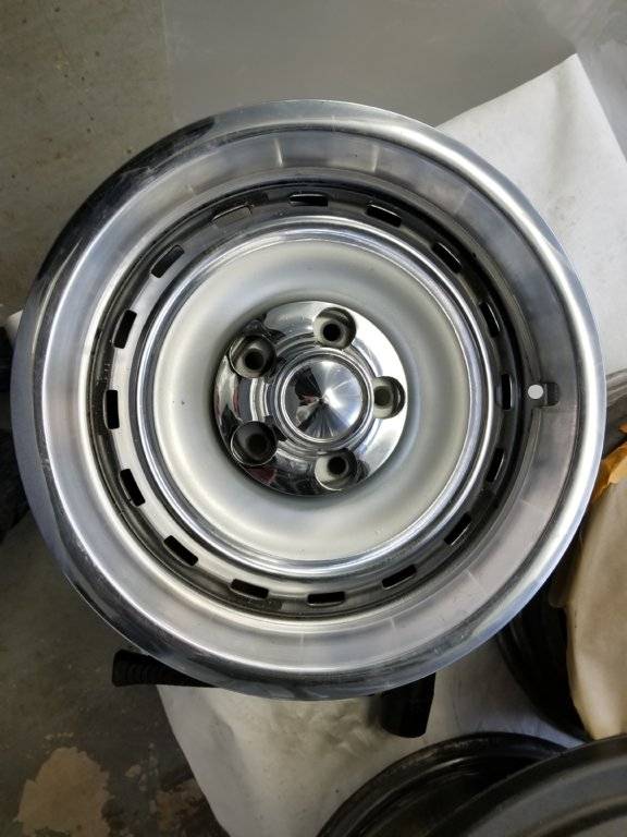

It's not too difficult to paint the centers, Tim. Use the trim ring as a template, cut the middle of the masking paper out, tape the edge with the purple tape, tape over the top edge of the purple tape with the paper and regular green tape and have at it!
Mario, your wheels turned out nice. Those are the same center caps, although not correct, I have for my RW's.
Mask it and paint it. I did mine 25 years ago and they are holding up fine.
Nice. I wasn't aware you had your New Yorker for 25 years Dave.
I still need to source the lugs for mine. With all the chrome lugs at any of the car parts stores, I need to find a complete set that is close to original.
