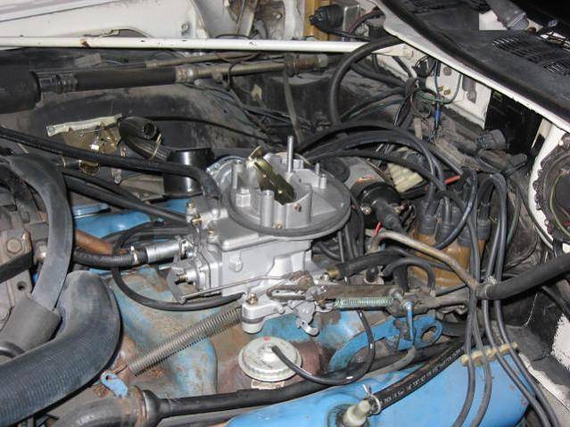

My driveability problems are over once and for all. Tuned the carb yesterday and was able to set my idle at 850 and steady. Pulled 21mm Hg and steady. Took the car out and there was no hesitation at any point in driving the car. That is the first time since owning the car that I can say that. Actually a pleasure to drive and never a sense that the car would have idle problems at a stop light. Now to drive it a bit to check out the jetting.

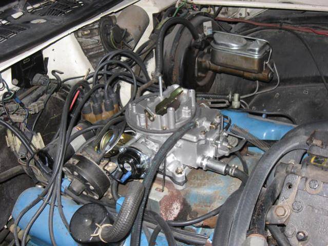

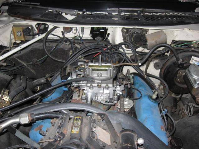

What did it is pictured below.
