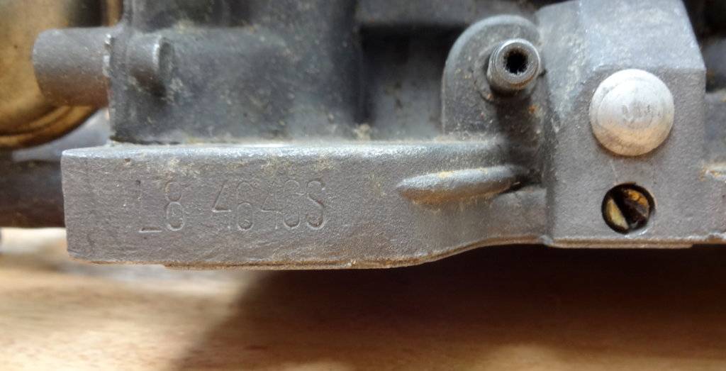

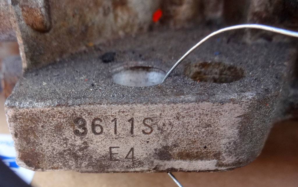

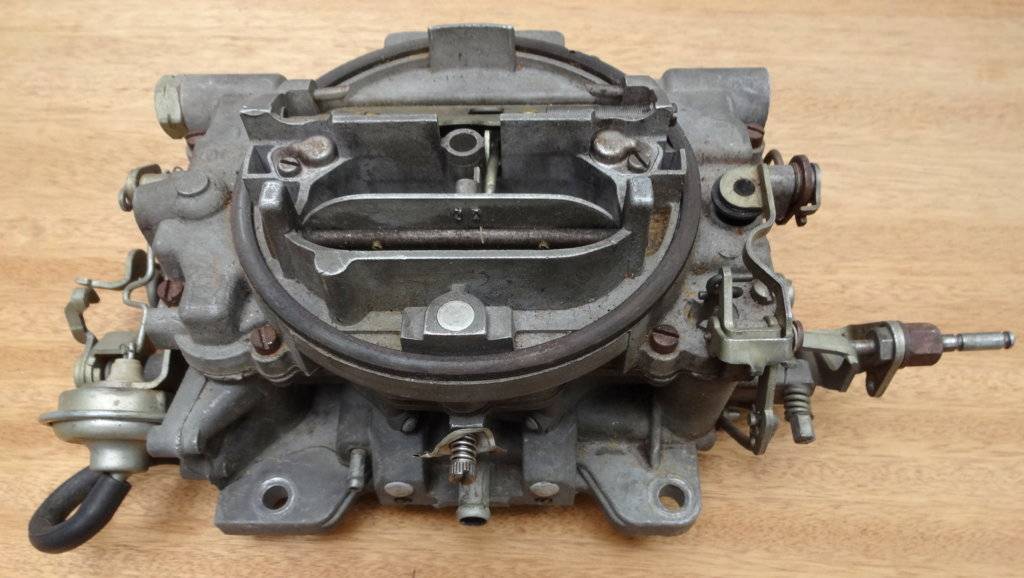

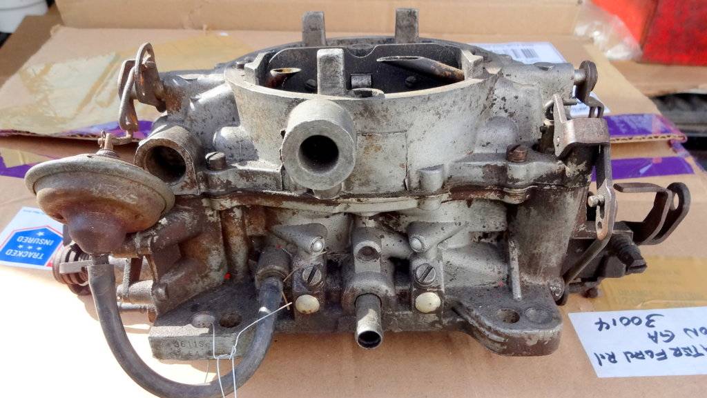

I also have a very nice carter AFB for 1964 383,426 & 413 engines, Just needs a Jiffy kit and a good cleaning, for $55.00 plus shipping.
