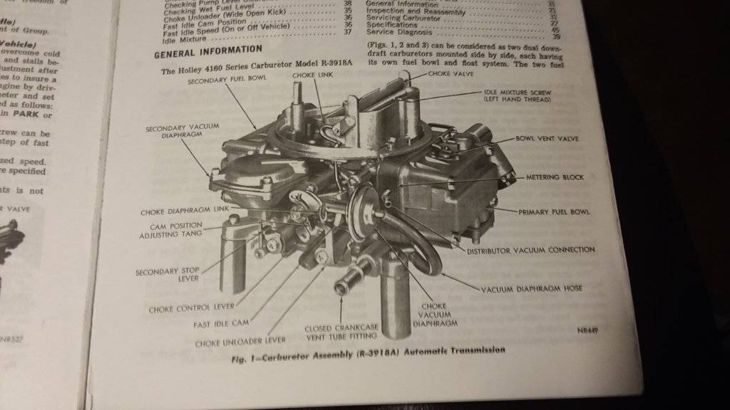

Dana, this carb is a little different then most Holidays that I've seen in that it has a left hand thread idle mixture screws, see top right corner of the picture. You probably know all about this already though.Just get it over here Cazman. We’ll take care of this young fella.
