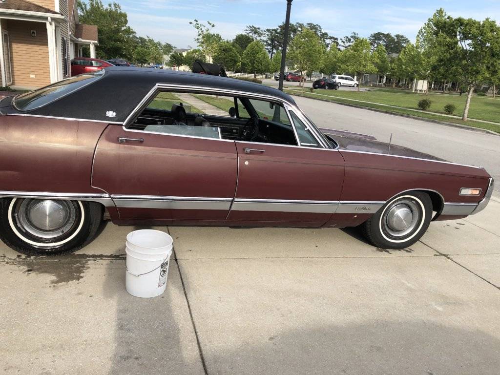

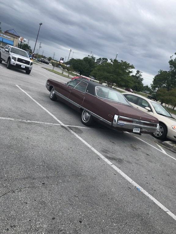

Burgundy, vinyls, green tinted glass and w/walls, lovely combo, Burgundy is a super colour to show "class" IMO, sweet cars, all of 'em in this thread.

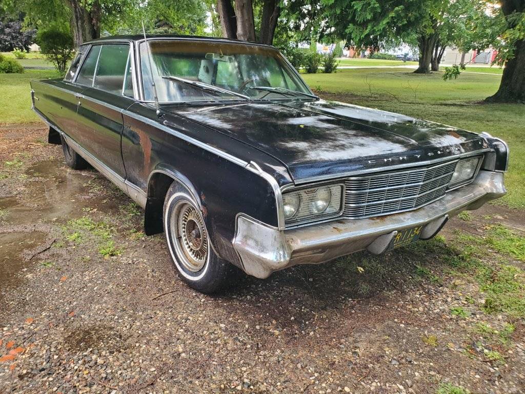

Good to see another MI New Yorker!
I'm in the Ann Arbor area. Diggin your car man. It looks to be about the same project condition wise as my '65 I am working with-
