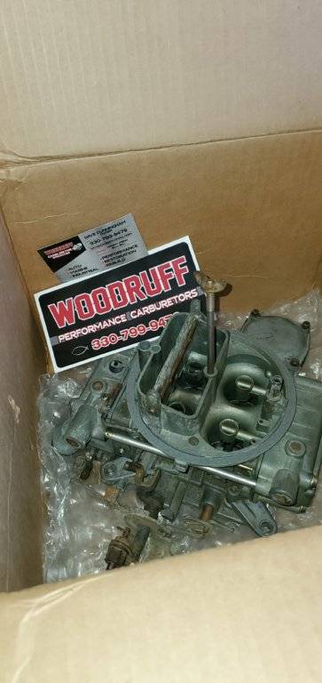

I just wanted to give a huge thank you to @Cazman and @Dana for helping me out with my carburetor situation! I just received it today and it looks great! I put it on the car bolted it up and it nearly fired... Then the starter went out! So as soon as I get a new starter I'll be posting videos and pictures! I just got the old one off and I'm gonna run to autozone tomorrow to get a new one ordered!

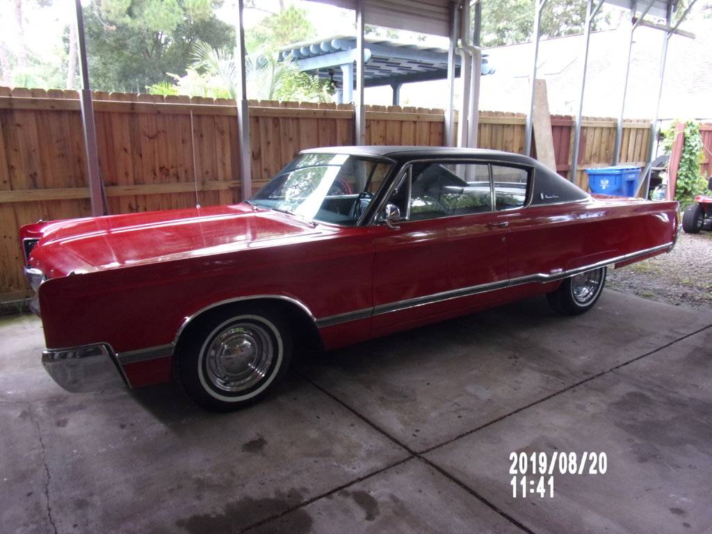

Here's a shot of my '67 Newport Custom.
If you’re cooling system is working properly the thermostat impedes the flow to the point the engine heated fluid stays in the radiator for a bit to cool it down before letting it back in to the engine for another round. If you’re running without a thermostat you’ve got issues, I don’t care what the average temp is in your area.
